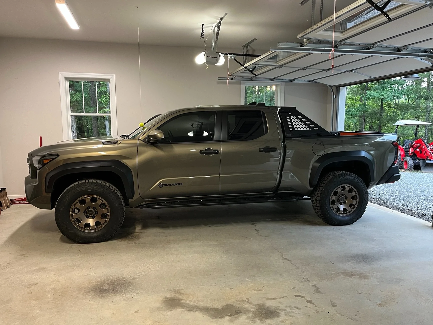

Your trailhunter looks really. I have the same truck. I’m curious if you might have a part number for those tundra springs?
Thanks

Sorry I don’t. I got them from a friend with a new Tundra build. I’ve had them on for a while now and recommend the highly. There are no downsides with a factory like ride with more capacity and height.

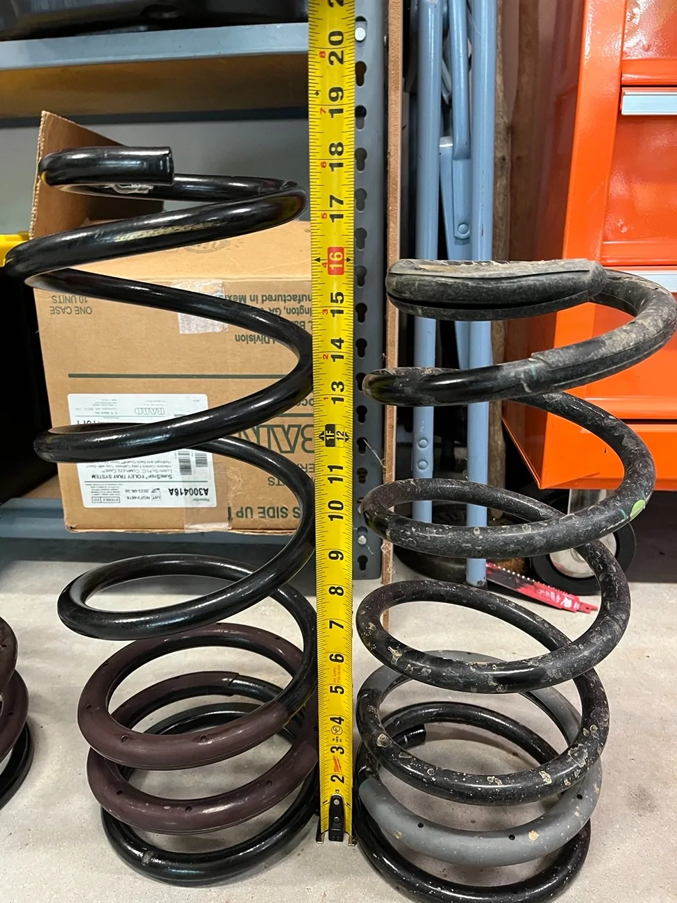

The Tundra springs added about two inches of rear lift even with the Decked system loaded with recovery gear. There was no noticeable difference in ride quality. The spring on the left is the Tundra and the right is stock Trailhunter long bed coil
Interesting beta on the Tundra coils, do you happen to know what year truck they came off of?
And nice looking ride, my 26 will be exactly the same, stoked to get it!

The springs came off a 2026 Tundra Double cab regular bed 4x4 Limited.
