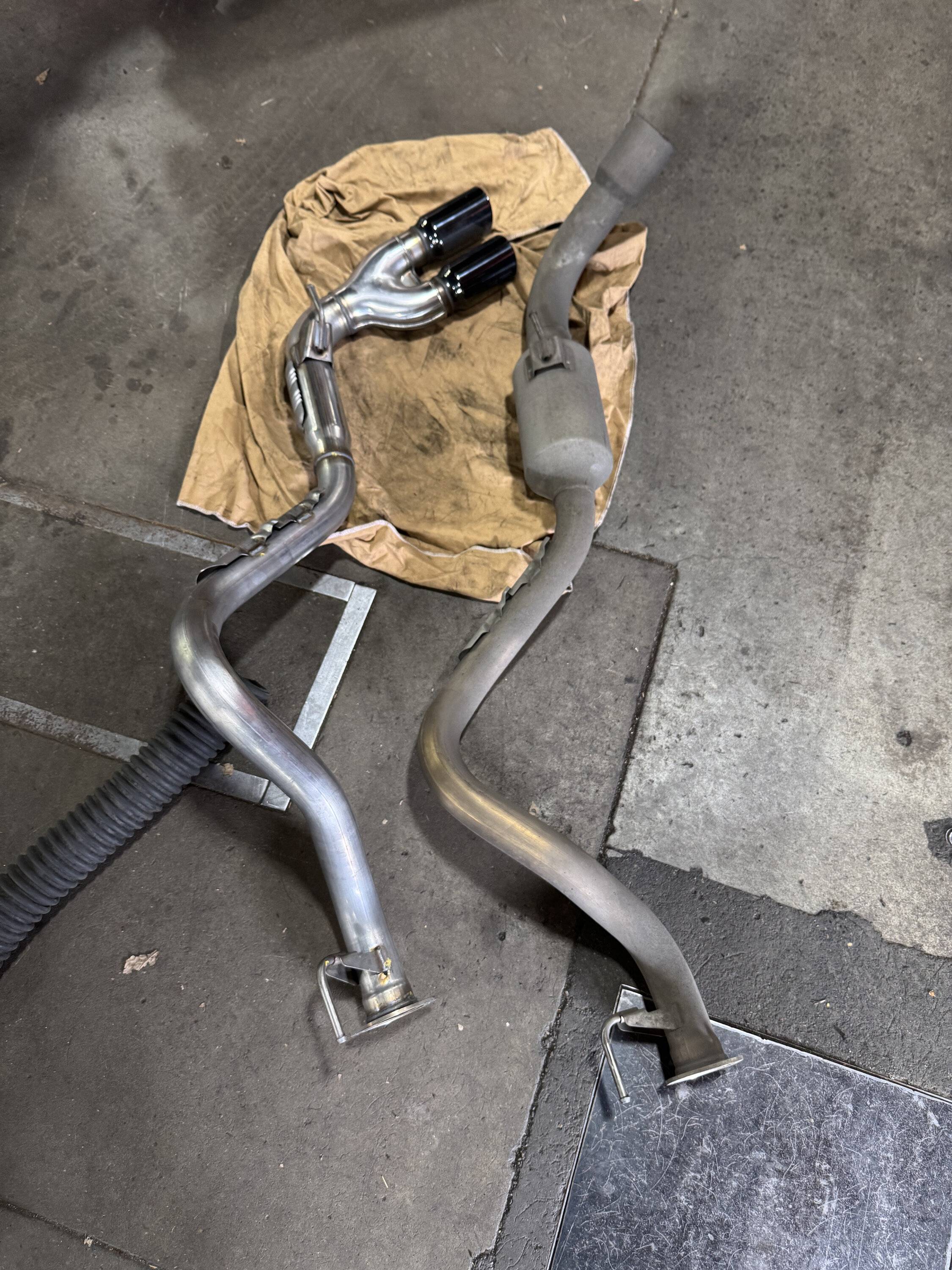

Part of my build: Benny's Build They often call this part “cat back exhaust’ or ‘Catalytic Converter Back’ or rather back from the catalytic converter…. There is one more piece to the complete system which is the “center pipe” .
So do you need the “center piece” ? What happen if I just buy the exhaust part

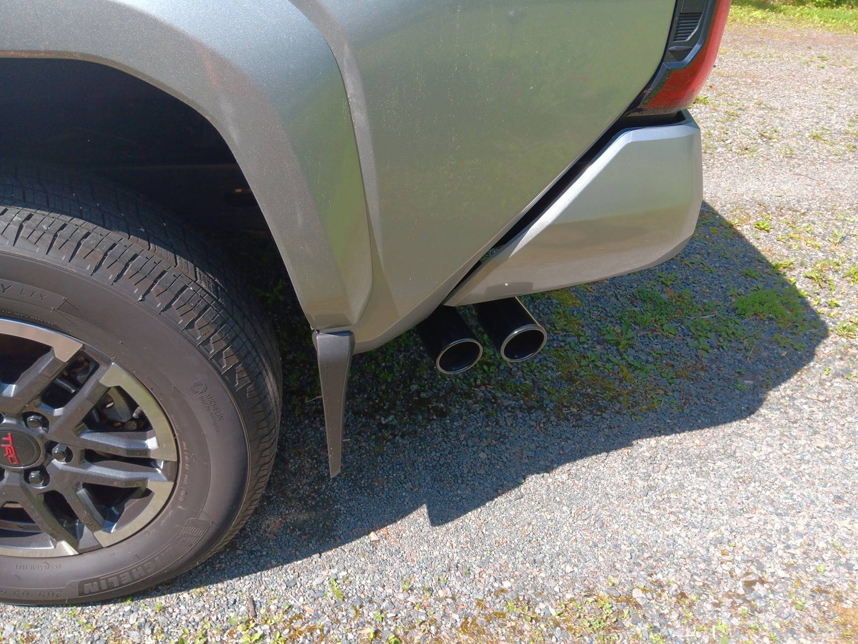

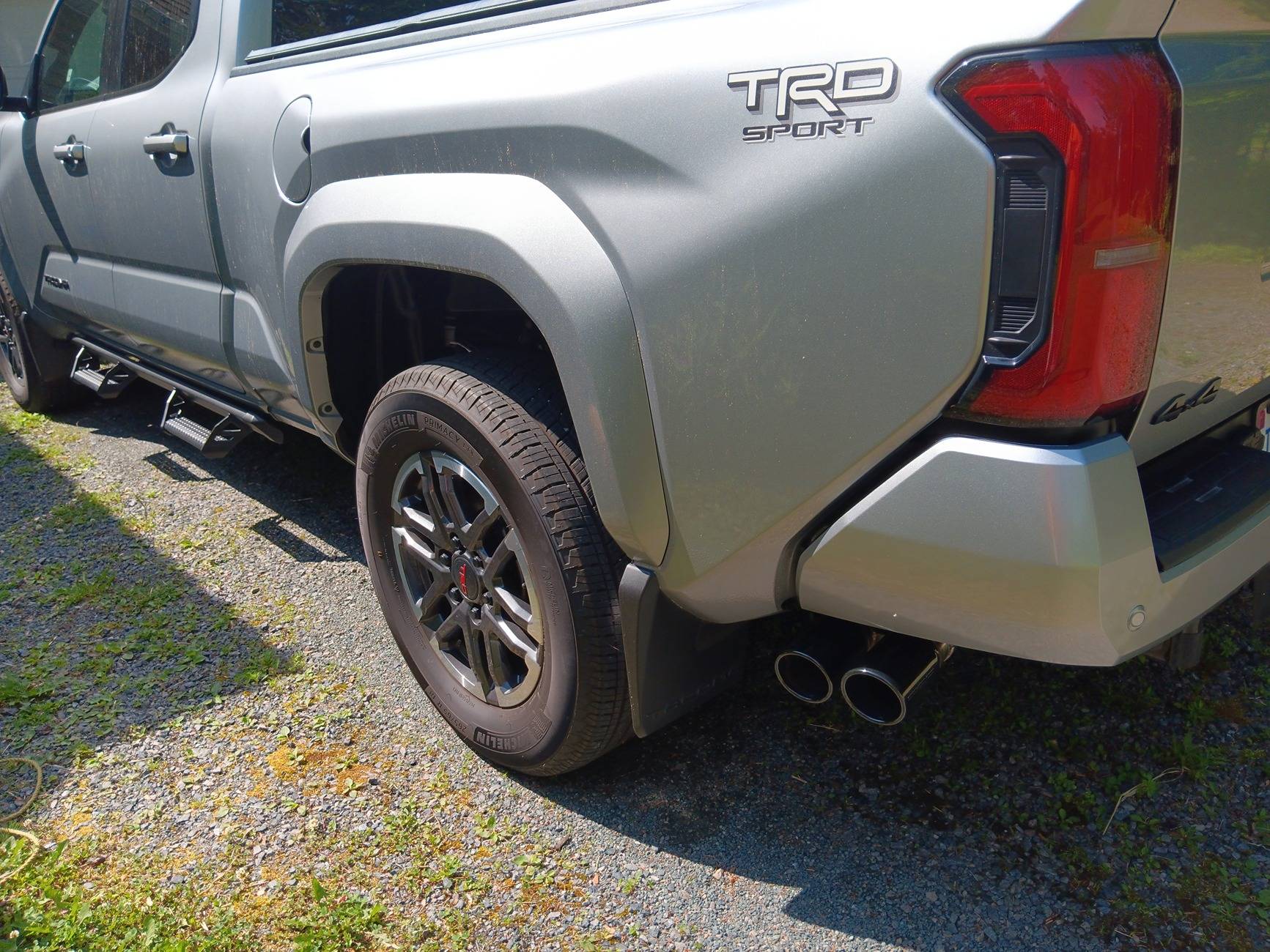

I had the axel back installed a few weeks ago on my 2024 Sport + long bed. It is slightly louder than stock..I don't even notice it now. No drone on the highway. And it looks so much better than the stock exhaust pipe.

I installed it myself. 2 bolts and 2 rubber hangers to remove and reinstall. I did have to drop the spare tire down to make it easier to pull the old axle back off. I am by no means a mechanic so trust me when I say it’s an easy job if you’re physically able to crawl under the truck.
