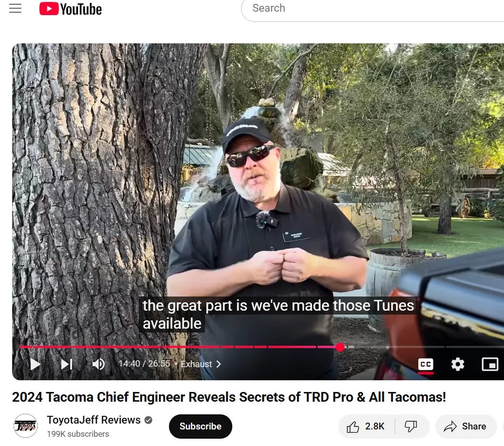

2. An early video from the Toyota engineer talked about how the Pro has a specific ANC and ESE file and that those files were available for those who upgrade to the TRD exhaust (where/how, I don't know).
I'm asking my mechanic at the dealer to look into this. I had the TRD Pro mid pipe with Trailhunter axel dump installed. I never was told about the file.
Just to share...I changed back to the old exhaust past the mid pipe because the axle dump was burning and melting the paint on the diff skid. I have a diff skid from a Trailhunter. I don't know if this issue has been reported anywhere else.
