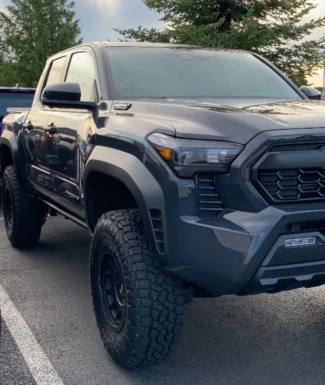

I may do that next - you think it will fit the TH with no mods? I don’t have much more than half inch remaining on full lock but I think that can be fixed with minor alignment adjustment - my castor is not as far forward as it could be even within specs - speaking of which - I cannot seem to find a consistent spec sheet for the 2024 TH for alignment - every single one is different so there’s nothing I can take to my after market toyota shop to go off of.. and the dealer is a joke
Yeah, 285/75R17s will fit the Trailhunter with no major mods. You might get a little rub on the front liner or mud flap at full lock, but that’s an easy heat-gun pushback or quick trim. The newer Tacomas don’t need a body-mount chop since Toyota redesigned the mount, so it’s just plastic contact if anything. Wheel offset in the +25 to +35 range works best, and if you have the shop push caster forward to about +3.5° to +4.0°, that gives the tire plenty of room. Toe and camber can stay within normal factory spec. Basically, a small alignment tweak and maybe some liner work is all it takes.

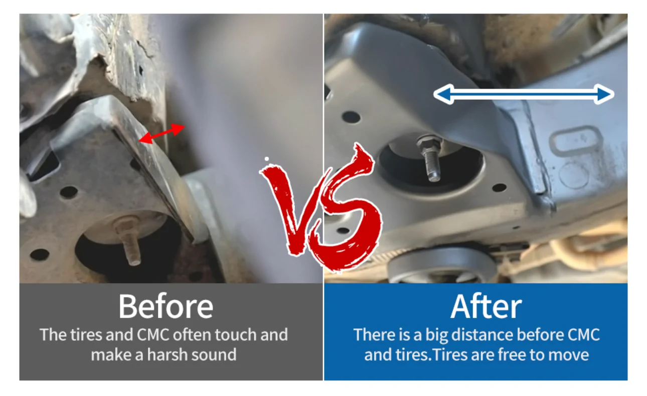

Tell me more about the redesigned mount on the new Tacoma. On the TH there’s tons of room in the front because it has a cutaway so not sure this applies to me. Great advice on the alignment specs etc. thanks !!
Yeah this is actually one of the big changes Toyota made with the 2024+ Tacoma redesign.
On the 3rd gen, if you wanted to run 285/75R17 or bigger, the biggest rub point was the cab/body mount (the chunk of metal behind the front wheels that ties the cab to the frame). The tire would hit it under compression or at full lock, which meant people had to do a BMC - literally cutting and plating that mount for clearance.
With the 4th gen, Toyota re-shaped that mount. It’s now tapered and pushed back further, giving more natural clearance for larger tires. That’s why most people running 285/75R17s on the Trailhunter or TRD Off-Road only report contact with plastic liners or mud flaps, not the mount itself.
Ah yes - 4th gen vs 3rd - I thought you means 24 vs 25 - either way that’s more detail than I knew
