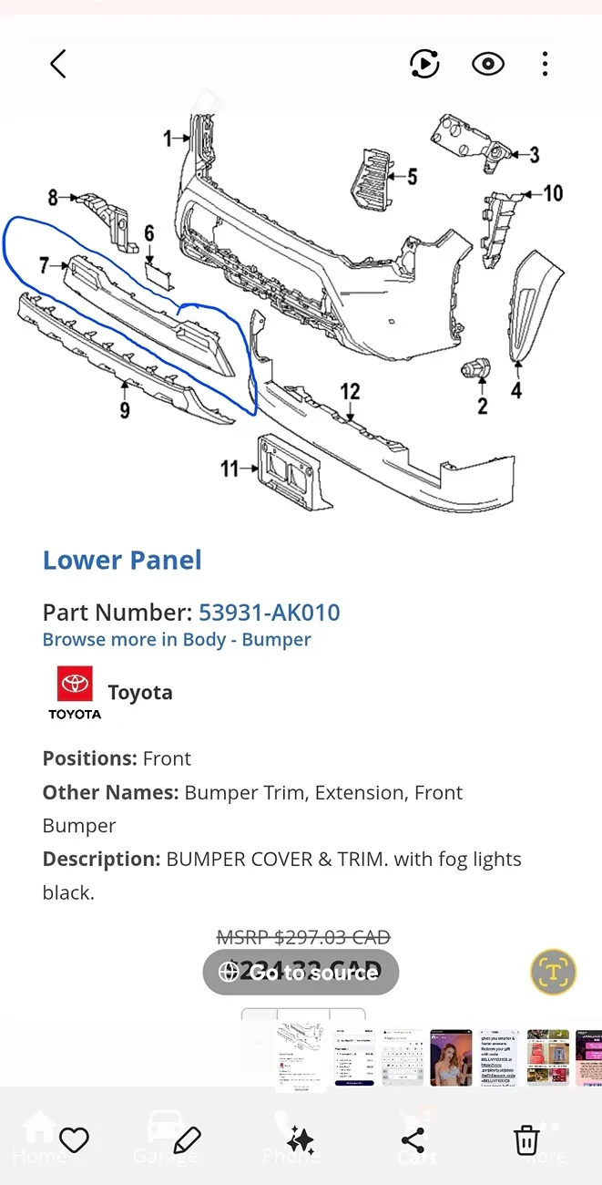

If you bought the 24-25 Tacoma kit from Diode Dynamics, it'll contain the mounting brackets to line up to the screw holes within the bumper structure.
You'll then want upper bumper part #010 to have the fog light cutouts but not the parking sensor holes. Part #050 is both fogs & sensor cutouts.
Have it all ready as you have to remove the full face and then disassemble the upper bumper portion to get at the fog mounts.

Sorry, Toyota part number for the upper bumper.
Extension, Front Bumper, Upper [Fog light grille, NO sensors, matte black] 53931-AK010
Extension, Front Bumper, Upper [Fog light grille, with sensors, matte black] 53931-AK050
Extension, Front Bumper, Upper [Fog light grille, with sensors, Limited chrome] 53931-
AK030
