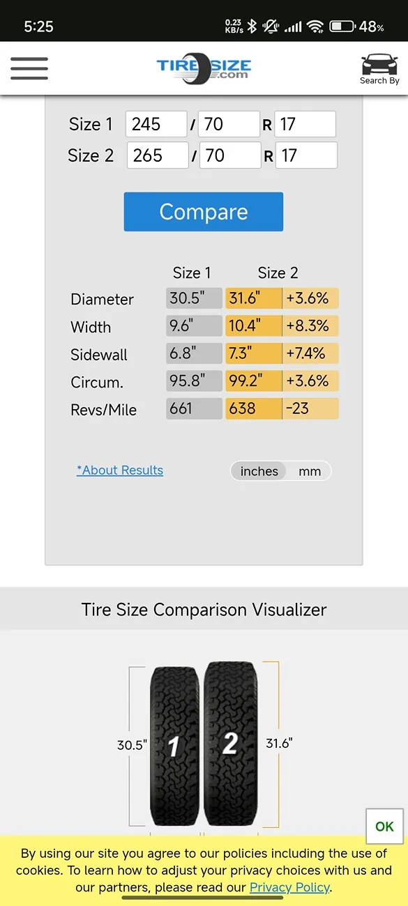

I realized the stock 245's on the SR5 were reading faster speeds than every GPS I've compared it to, as well as my dash cam. All three gps's I compared were spot on. I also did multiple distance tests with with the gps's, and the truck always registered more miles than traveled.
I've since changed over to the same 265 tire size that's on the trd models, and now all gps speeds and distance tests match up perfectly.
Now, as such, it seems the vehicle is calibrated from the factory to the trd tire size, which would mean my odometer was reading more than the actual mileage traveled....which of course would mean my factory 35,000 mile warranty was short changed.
When I first got the truck, I noticed the mileage was increasing quite rapidly, now, after the tire change, it shifts WAY better and the miles creep up.
Im sure I won't get far, but I'm going to contact toyota about short issuing me miles on my warranty. This has to be not quite legal, as the miscalibration is from the factory. Maybe if more people complain, it could potentially get somewhere. Who knows.

2024 Tacoma Stock SR5 tires over stating speed and odometer 1000004793
3.6% of 30,000 is 1080 miles, not nothing but usually warranty will give you a little leeway mileage wise.
I think I did that math right lol 😂
When i did my distance check using gps, 13 actual miles on the gps ended up registering just about 15 miles on my odometer. That would make it roughly 3000 miles off of the 20,000 miles. After the tire change, it was almost spot on by +\- a tenth of a mile. Lol thats quite a bit if thats correct.
That can't be right thats almost 15% off
Even if you add 3% to my calculations (say the speedo reads high) you get a total of 6% which would still land you at 1800 miles difference over 30,000mi
There could be nominal differences in those tires outside of that calculator. Maybe take into account the tread wear on the original tires verse a new tires could be slightly bigger from minor variations from manufacturers. Maybe that can make the spread larger outside of the calculator. Also variations in the GPS potentially not being perfect. Few tenths here
I did the test a few times and it was spot on both before and after the tires, from the same spot. I was doing these tests just before i got the new tires.
Two miles extra for every 13 miles is quite a bit in the long term.
Another interesting discrepancy is how well it shifts after the tire change. Everything is softer and an overall better driving experience. Tire weight could affect that as well. Or maybe the shift points are a combination of road speed and rpms, designed around that tire size 🤷
