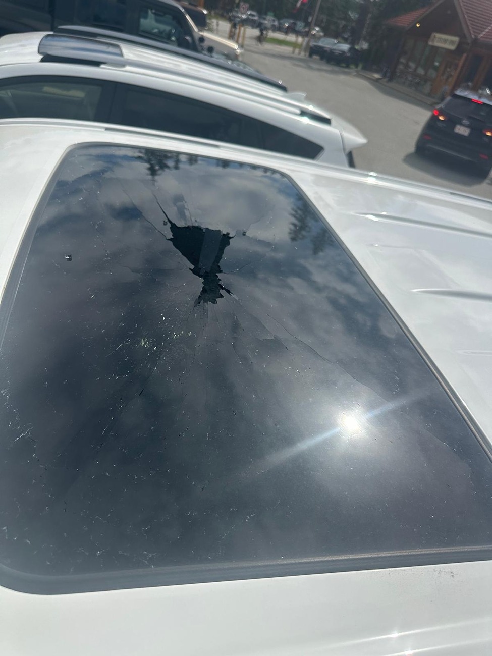

22 taco limited
It’s Labor Day Toyota Dealership closed.
I was driving speed limit very loud, boom sound.
Sunroof glass shattered.
Any comments
Updated with photos:
FYI , MINE shattered yesterday.. I talked to Toyota and they are trying to get it resolved. Take a side picture. IF it exploded from the inside the glass will be pushed out. mine was. there are MANY lawsuits going on now about this..UPDATE Toyota will warrantee it. BUT u mite have to fight for it. No glass inside the truck and the glass being pushed up should prove to them it was NOT a rock,

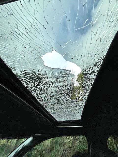

Is that a small BB laying there? That could have done it.. HOWEVER if its not YES THEy do explode from the inside. Mine did yesterday. Take a side view picture to prove it to Toyota. Also there are 100s of lawsuits about this topic.. Search Online

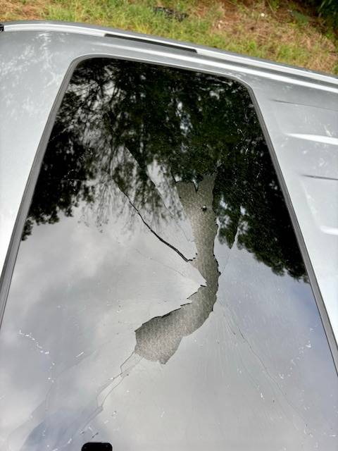

Buzzard
Oct 24, 2024
Ontario
2024 Toyota tacoma trd sport
Mine just exploded today, got gas, got back in, closed the door and the sunroof rained glass. Hard to tell from the picture, but it exploded outwards.

It's at the dealer, I'll let you know how long it takes and how the replacement goes.
Buzzard
Oct 24, 2024
Ontario
2 weeks to get the glass from California to Ontario. Toyota warrantied. Back on the road finally.
