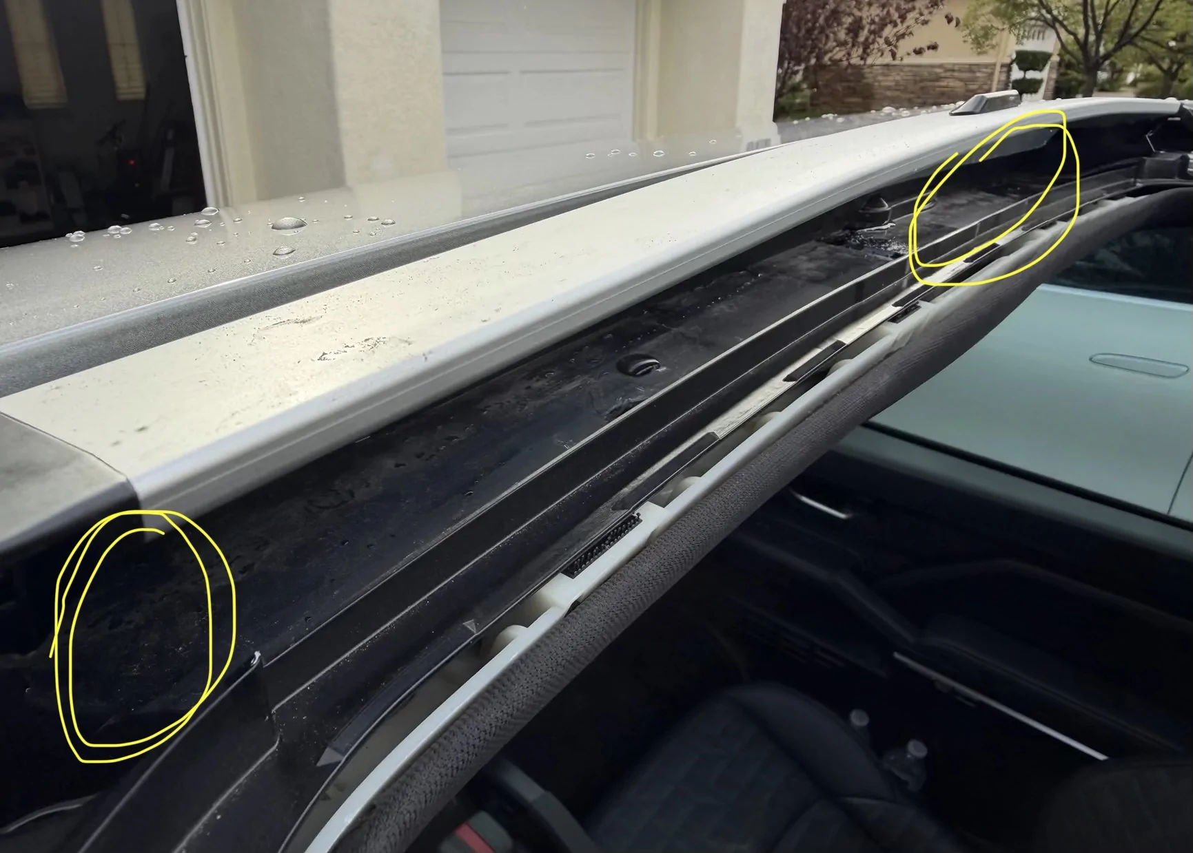

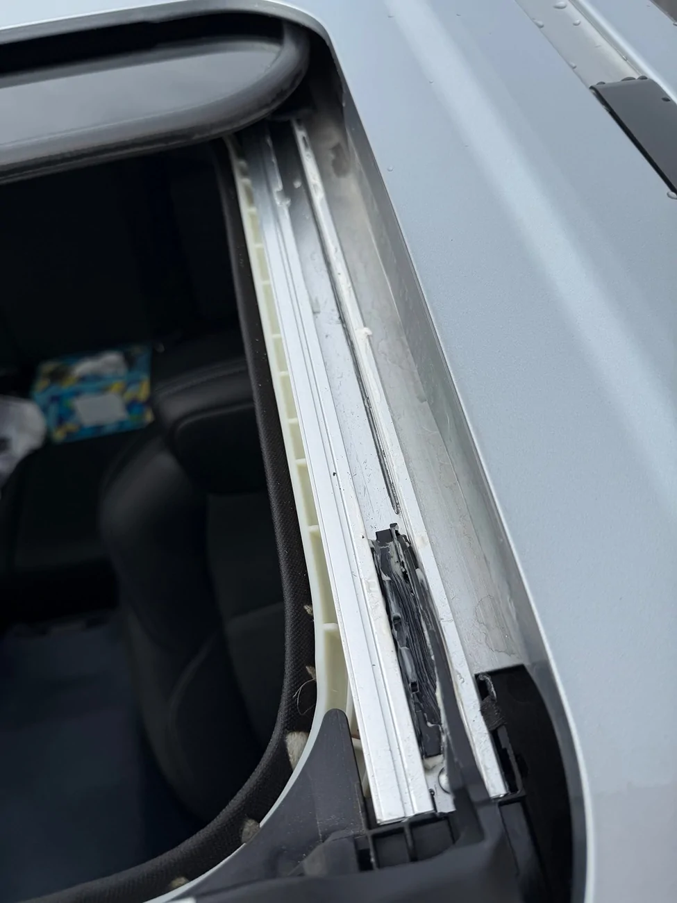

Has anyone confirmed our sunroofs have 4 drain holes? From what I can see the rail covers the tray where the rear ones would be if they exist. Unless I’m missing something in the design of the sunroof cartridge.
