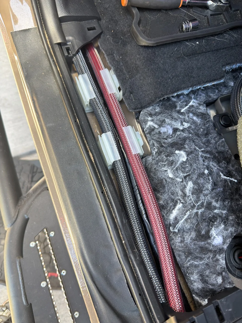

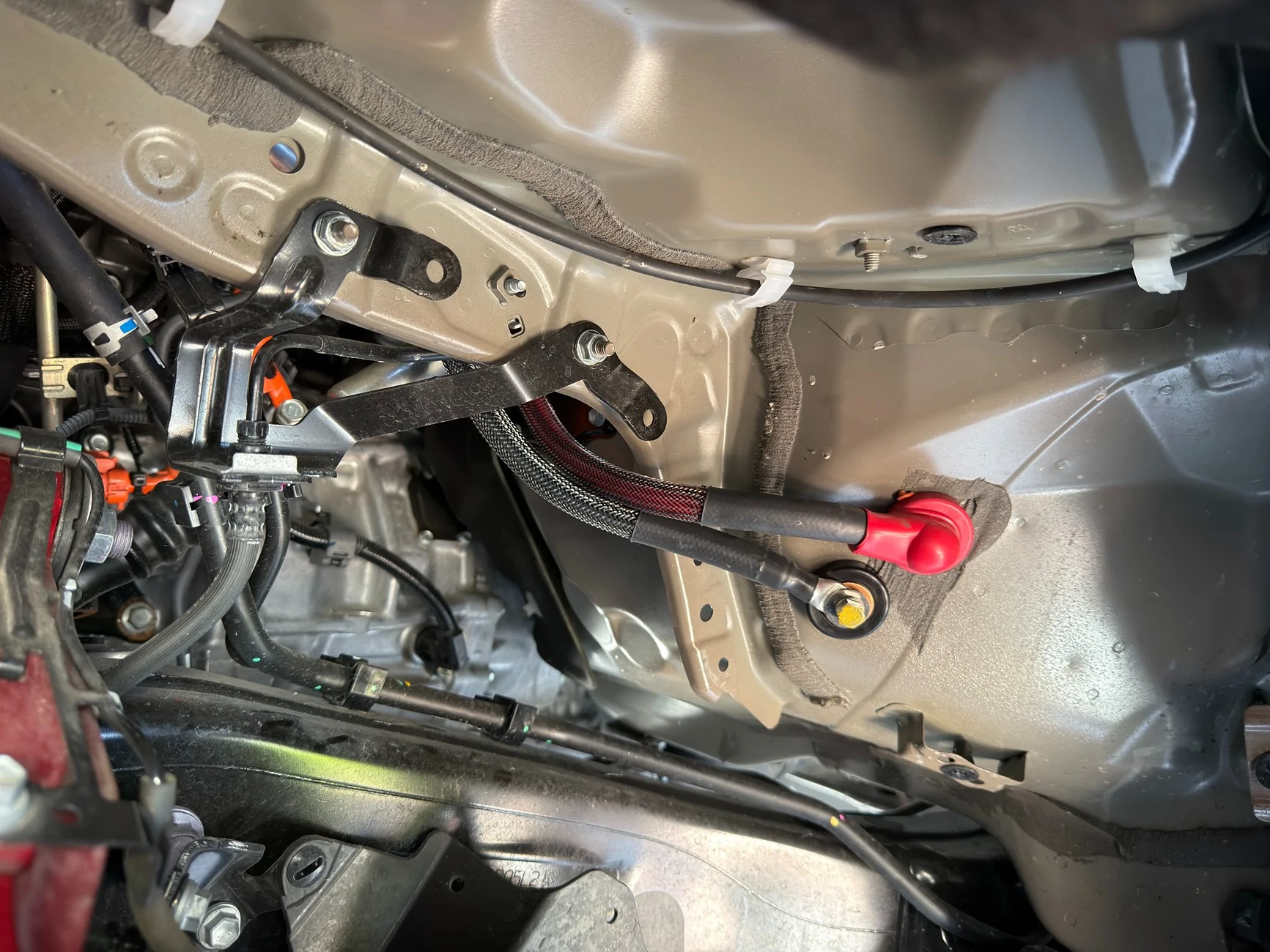

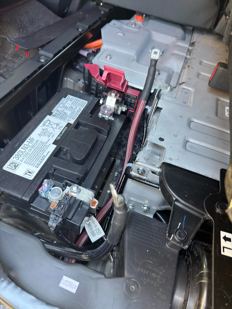

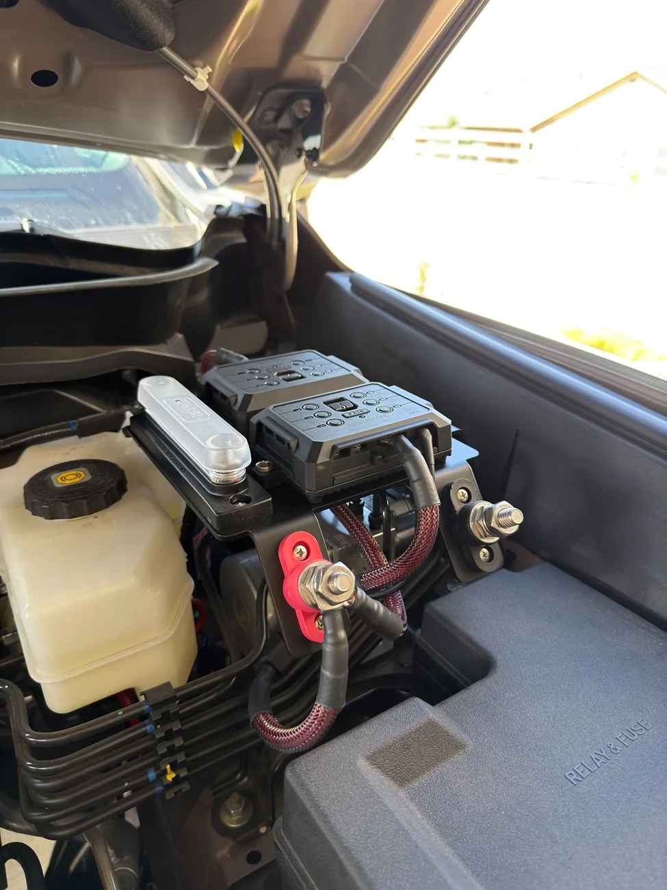

Correct. I need to do a video and write up on how I relocated the power from the battery into the engine bay - since it's a Hybrid.
I installed the Blaze Off-Road 12V Relocation Kit. I had the first one they made for the Tacoma. I used all Blaze products in my last build so I knew the company and brand well.
Photos attached.

I haven't seen that video but for me I was set on using the Garmin PowerSwitch. I ran it in my last vehicle and love them. No control units to wire into the truck.
Knowing that and knowing I was going to run multiple accessories off of it, I elected for a system I knew could handle the load.
Im running:
1. Diode Dynamic SS5 Pro Roof Lights
2. Diode Ditch Lights (2 pairs)
3. Diode Fog Lights
4. Warn Winch
5. Rock Lights
6. Radio
Plus more.
This application is dialed for my current needs + additional add ons later. Additionally I wanted to Positive and Negative post and not going into a fuse box.every time I need juice is also key.
