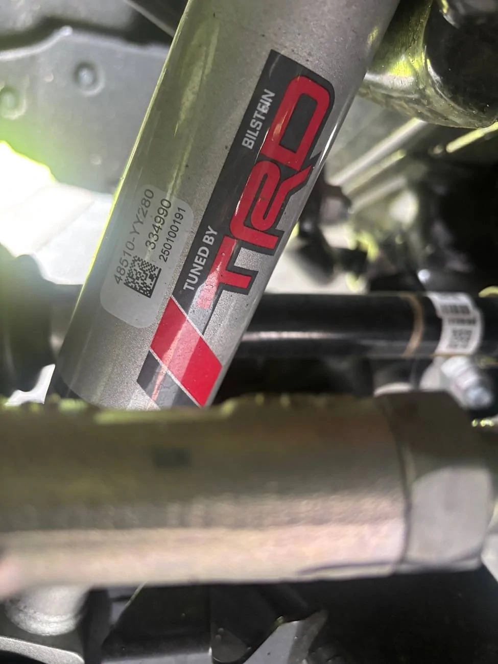

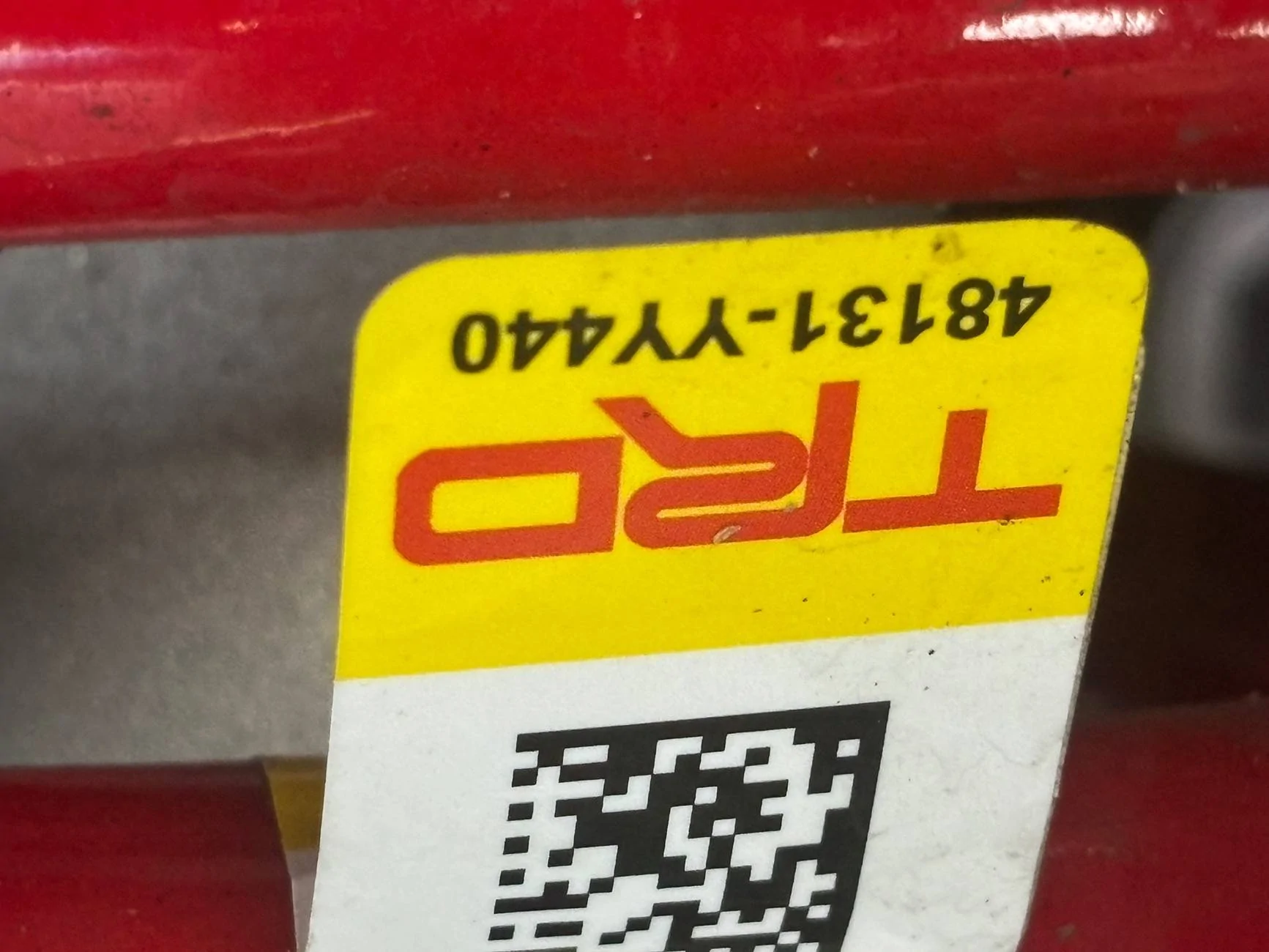

Here is the part number of the front shock and spring. I seem to be drawing a blank on the interweps. Does not come up on Toyotas web site

Thanks I did find these on the Toyota parts site. The shock comes up as from an tundra.
