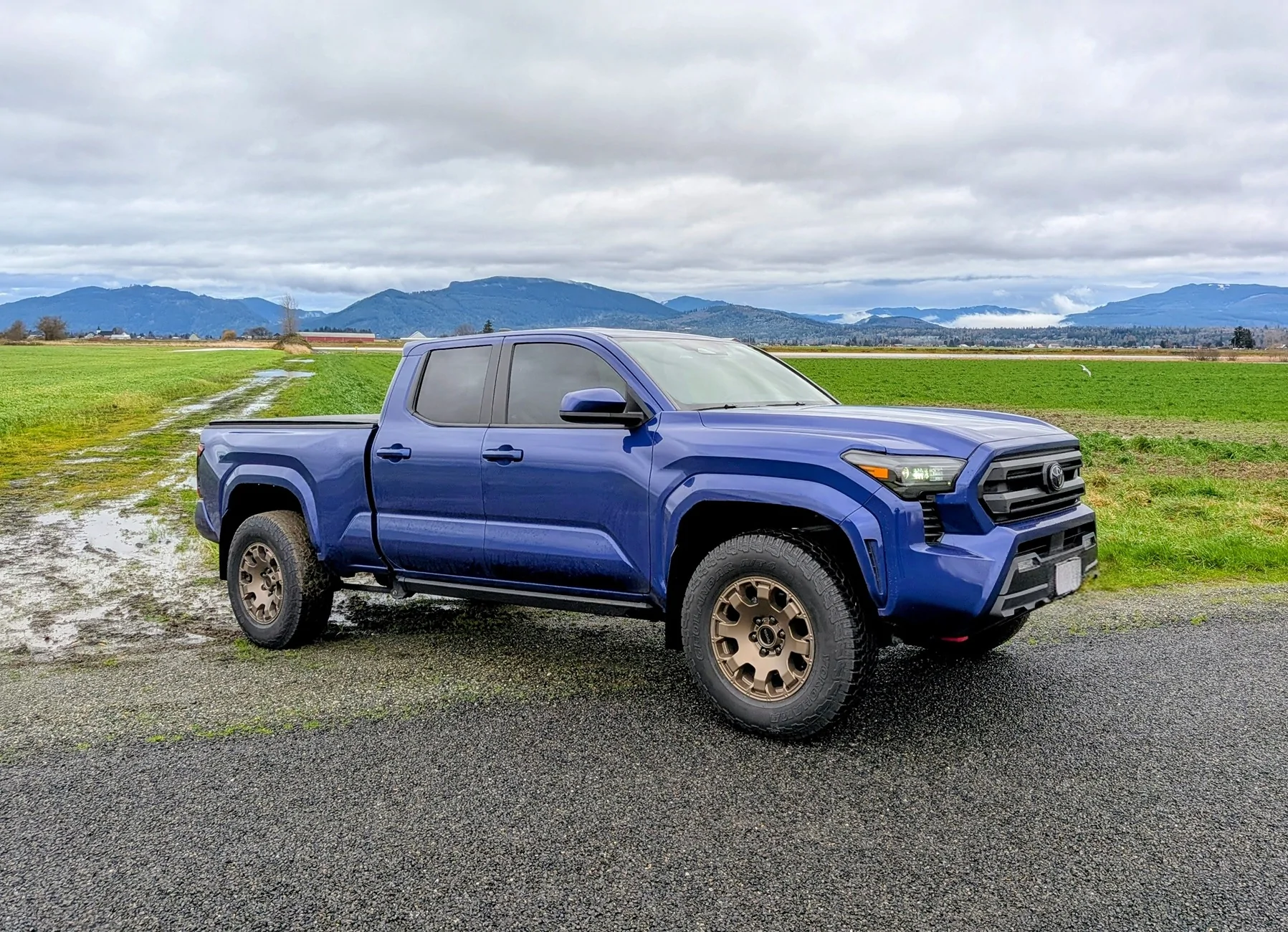

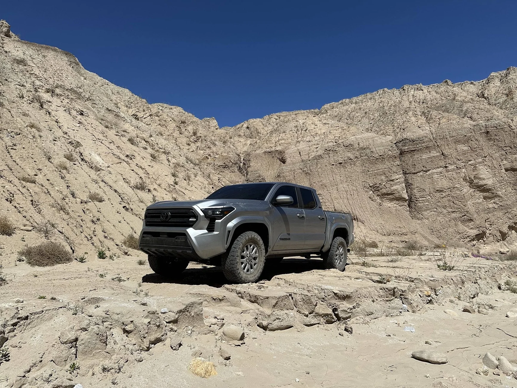

I've seen some cool SR5s with stock wheels up to 285/70R18 (check out the wheel/tire builds section). I think the OEM SR5 wheels look really cool with an aggressive 285. But 275/70R17 is probably the sweet spot on stock suspension in my opinion.
Our SR5 suspension is the same height as the Off Roads, but just not as good as the OR OEM Bilsteins. The only reason they have the 1" of "lift" is their tires.
You can get some cheap or free Off Road take off suspension on the member marketplace though. Someone in my neck of the woods is selling his for $350.
I got bilstein 5100s to upgrade the SR5 shocks and to level the truck. Leaps and bounds better IMO and not expensive.

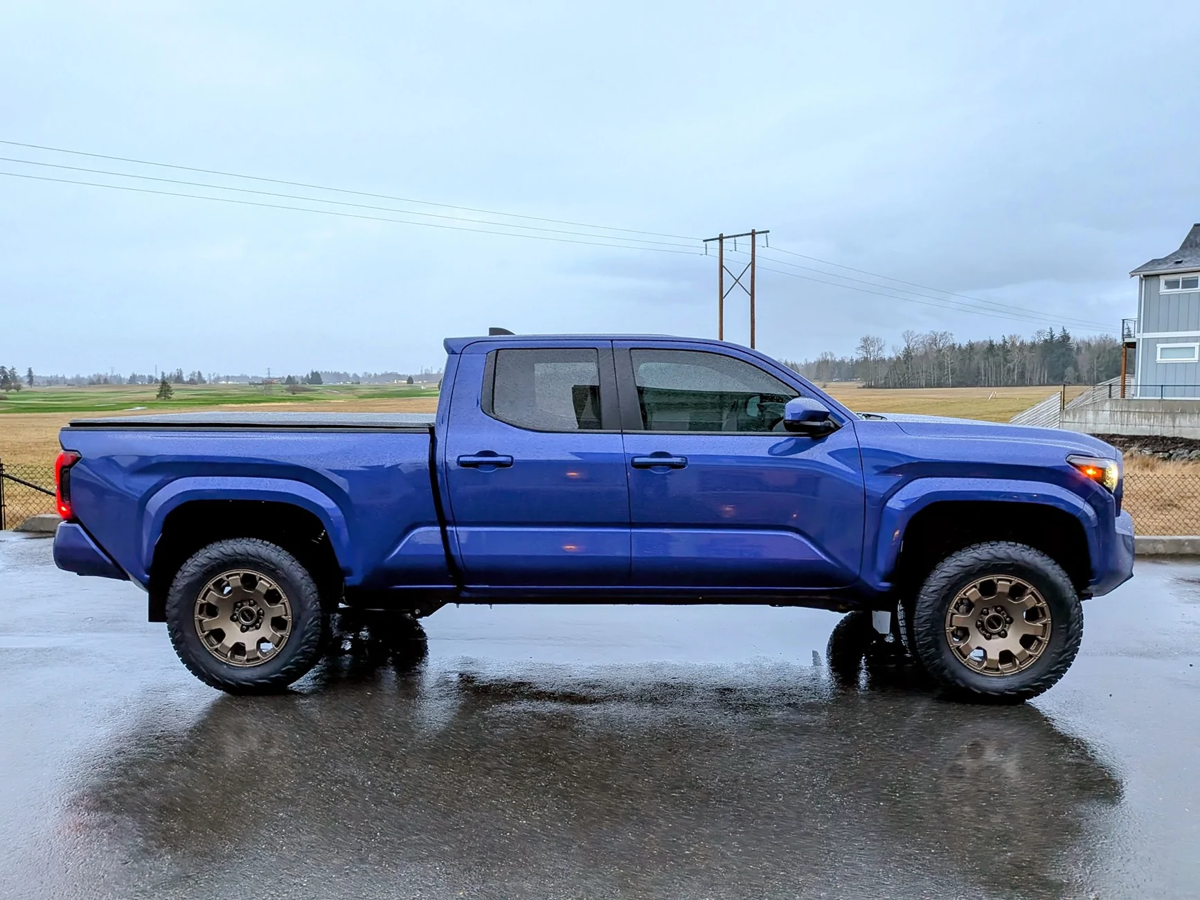

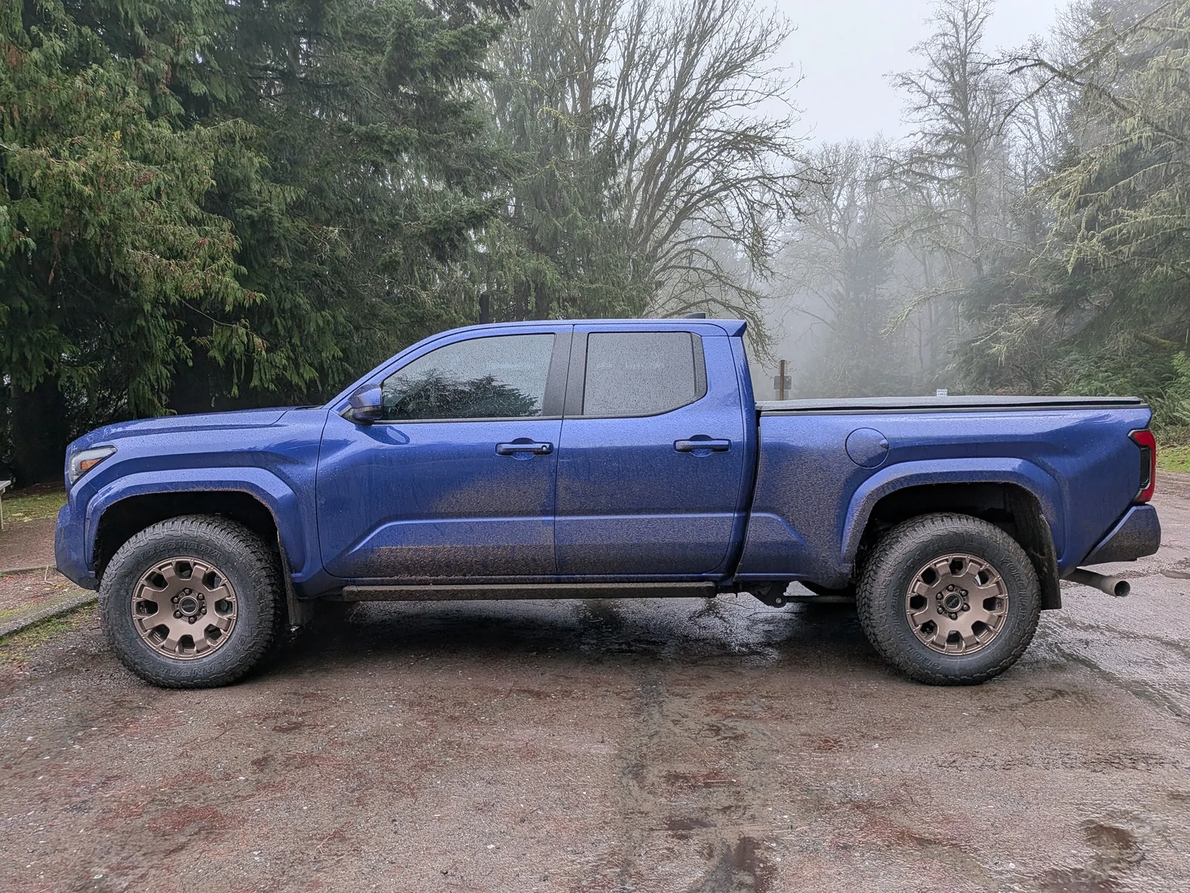

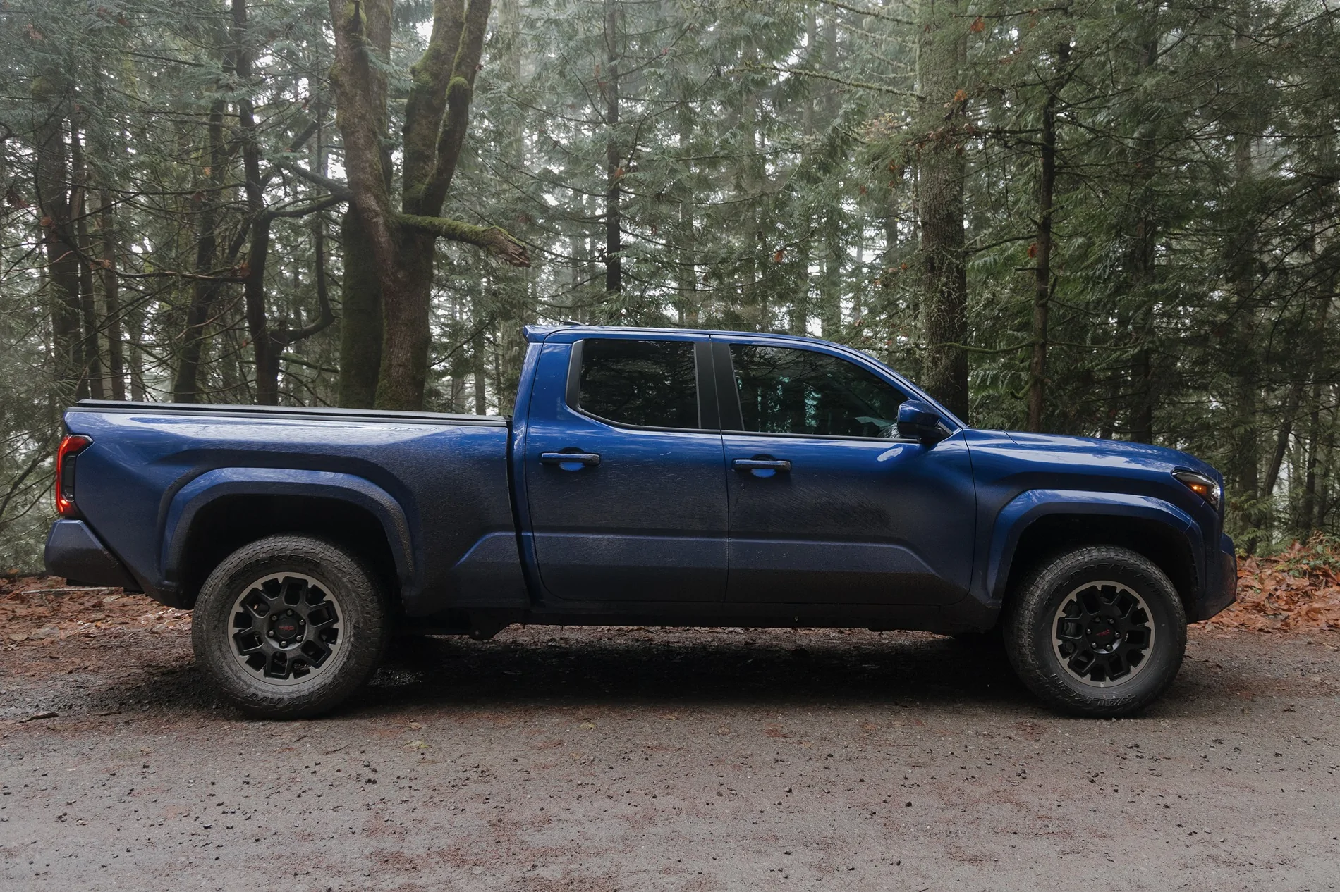

Here are a couple photos as I progressed just for reference:
1. TRD takeoffs with the crappy 265/70R18 OEM tires to on stock suspension
2. Trailhunter wheels with 285/75R18 on stock suspension
3. And now Trailhunter wheels with 265/70R18
Looks good. What height did you set the front bilsteins? Id like to copy your setup.
