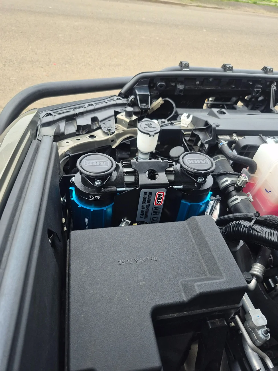

What I don't understand is why Toyota only offer a rear locker and not a option to completely lock up both.
This will be one more thing Toyota droped the ball on, planning on using my twin ARB compressor with a solenoid to fix 🫩
2024 Tacoma Tire Upgrade for Stock SR5 4x4 - Input Requested 20260101_084037

CVs are pretty fragile tbh front locker is an easy way to break stuff
I guess if you ride around on trails with spare axles sure lol
