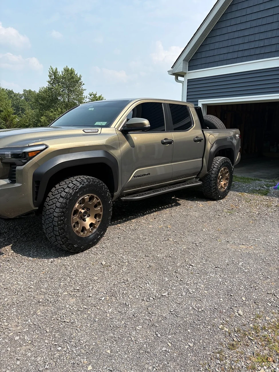

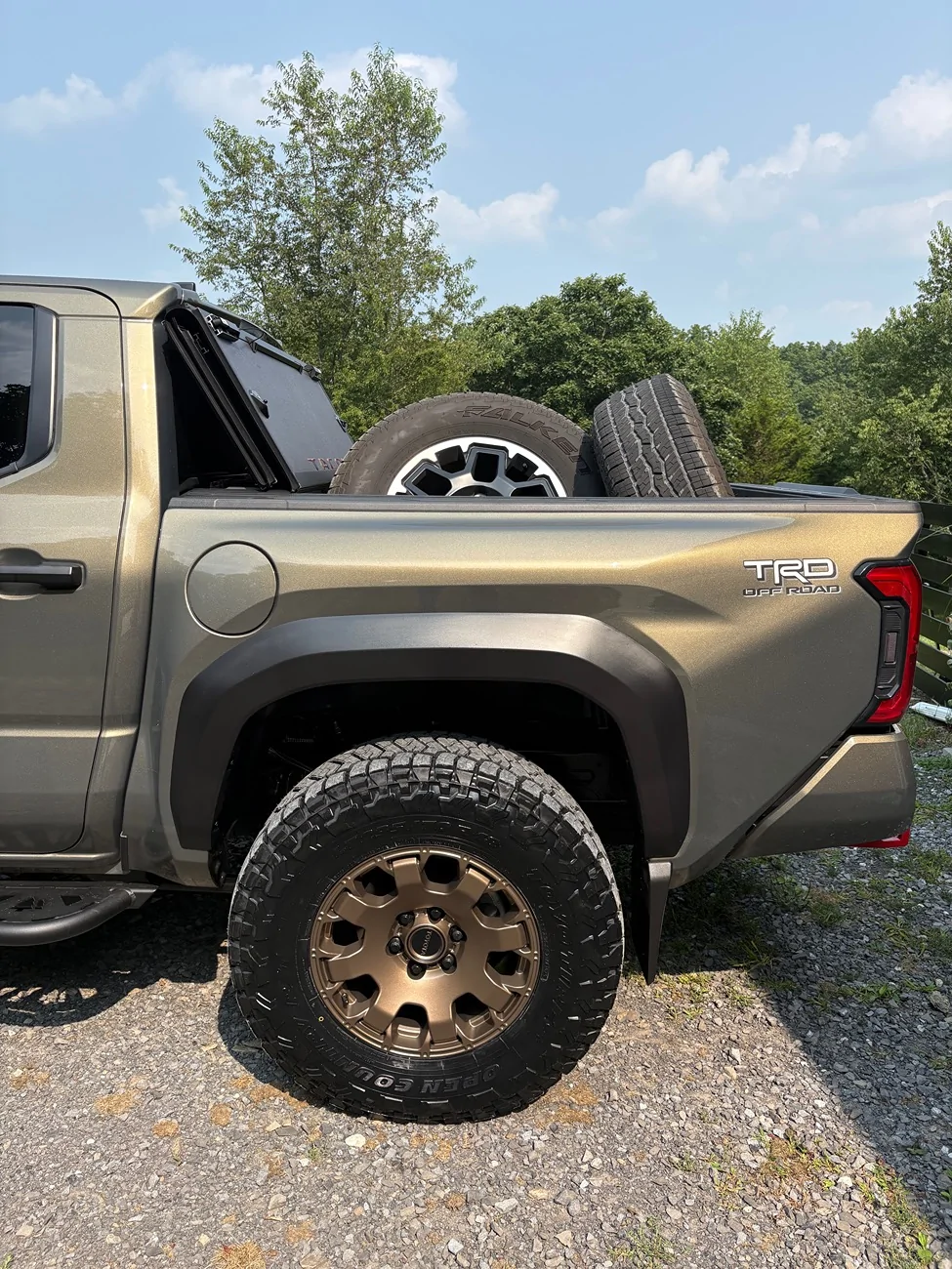

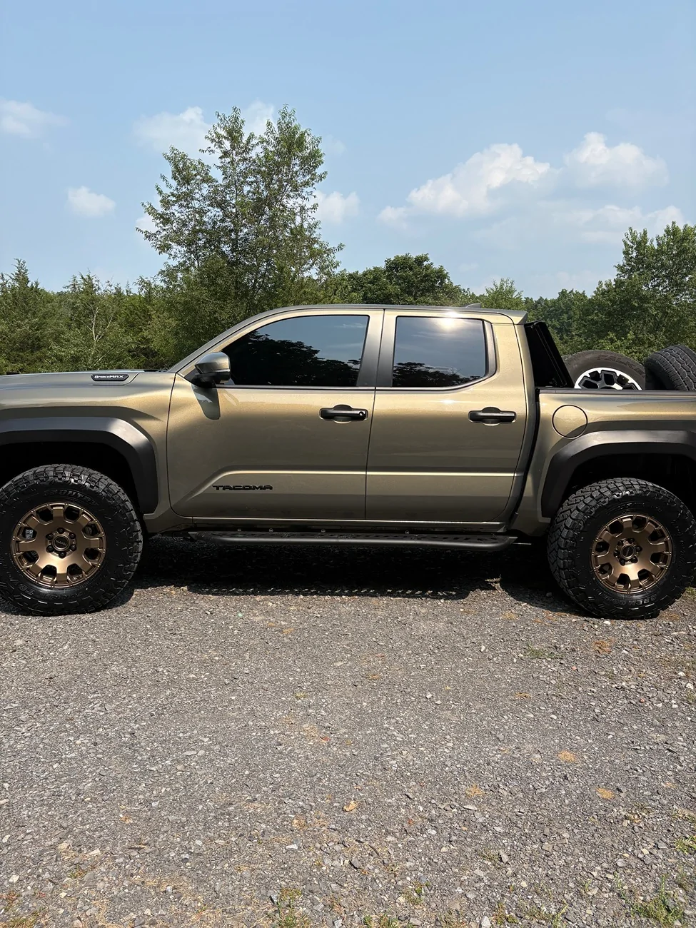

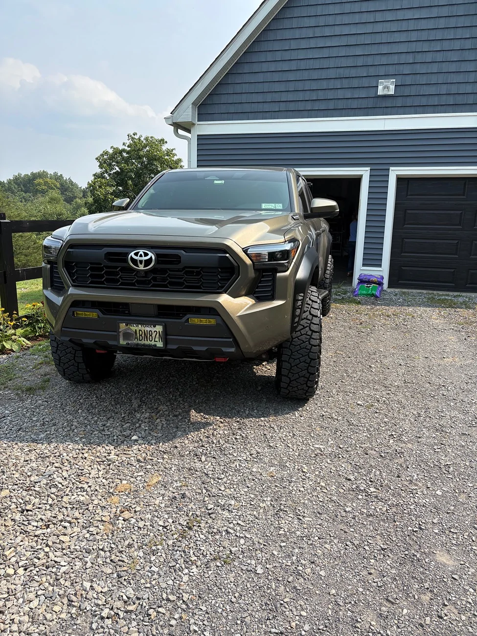

I have toyos on my truck, its a hybrid TRD Offroad, already had oem, 18” wheels, its about 1 ince higher then non hybrid, i then put a westcott, level lift on truck and i put trail hunter wheels on truck, my tire size is 295-70-18, i removed the crash pad, and shaved a 1/32nd on front iner bumper, plastic…fits very good lock to lock, flex and bumps are fine, had gone next size bigger then i would of needed more trimming, based on this experiance im guess its going to be a little tight tucking those tires and offset into a stock trd …..good luck. Some say no issues , hopefully it goes smooth for you…..

Ohoh, then thats going to give you some lift, my apologies, didnt realize you were able to get the factory lift,….that probably will be doable then, im curiouse, the specs on factory lift are, 2-2 1/2. Lift from what i heard, i still think you will need to remove crash pads,

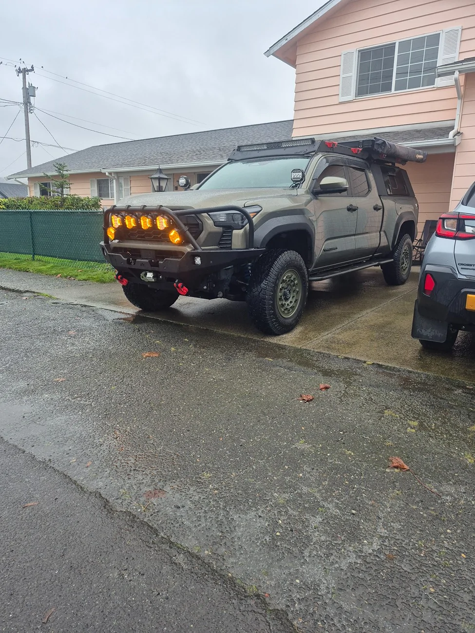

Looks and functionality are two different things. Sure, they'll fit in the hole and you can turn the steering wheel. But take it off road, see what happens? Unless you're planning on putting portals on your rig, there's no practical off road use for 35 inch tires on a stock toyota with a factory fox lift.
I started building/ ruining my first Toyota, lol 35yrs ago. 18in of combined lift 38in super swamper with a Buick 231 v6 and turbo 350 tranny. Great truck but something inevitably broke every time I drove it.
This time I am doing it right or not at all.
It would be built by now but all the products haven't been released to do so.. Waiting on backwards adventure to get the rear bumper finished respring, The front king shocks and get it wrapped, and I'll be done.
Good luck with your build. And do the smart thing by some 33x9.5 inch old man tires that fit and function with no problem that will get you anywhere those 35 inch tires will with a lot less gas.

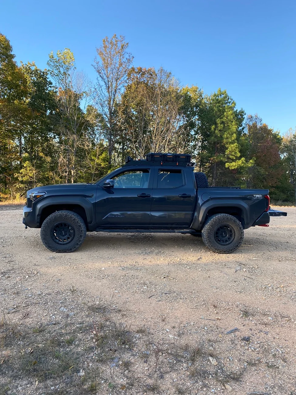

I have stock suspension with dobinsons springs front and rear. Approximately 2” up front and 1” at the rear in lift. I have method 305 with plus 25 offset. I put 35 12.5 17 on and the only thing I had to do was remove the crash bar. No rubbing whatsoever. I don’t know what the factory lift is but if you get at least 2” or more then you should be good.
