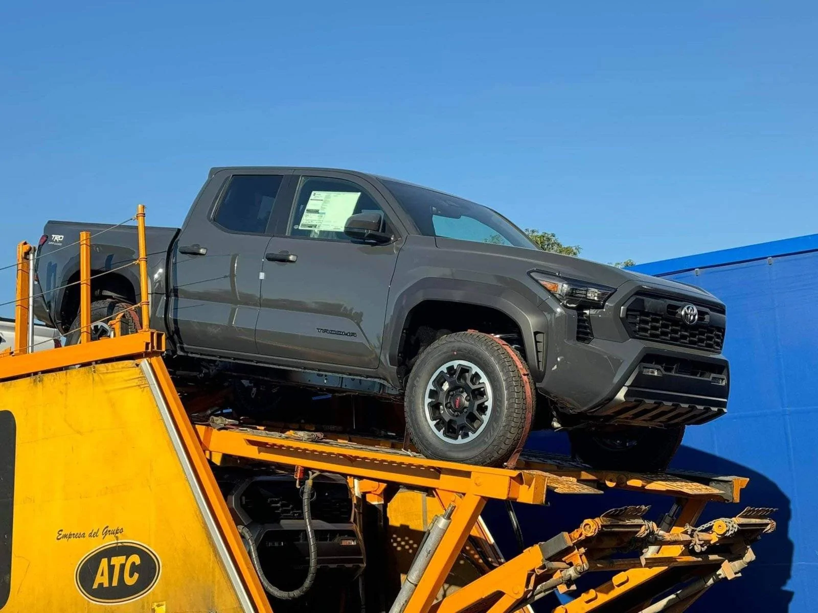

Notice how the Tacomas are shipped.
They strap the wheels down to the car carrier or rail car to avoid hooking up to any part of the frame or suspension.
That strap has a rachet and the pressure will crush the tire without adding the additional air, thus the higher tire pressures upon delivery we are seeing here.
The dealerships need to pay attention to details like this during the pdi.
There is a check list to follow and the tire pressures along with the wheel lug nut torque checks are part of the pdi process, obviously not being followed in these instances.
Let this be a lesson on how not to take delivery of a new Tacoma, take a check list with you and take your time, this was a rushed delivery.
Take the time to become familiar with the information display and find the tire pressure readings.
Bring a good quality tire gauge and compare it to the trucks display so you don't have to idle it while airing up or down.
Check your oil level before starting the engine and note that cold engine level on the dipstick, make sure the coolant levels are within spec as well, take nothing for granted.
I would switch it up between variable speeds/rpms as well for first 1000k or so, constant steady rpm or cruise control over an extended period of time on a fresh engine isn't wise.
Also for those folks new to turbo engines, remember the engine oil is cooling the turbo, try to idle for a minute or so after steep grades or high speed/rpm driving the turbo will thank you.
2024 Tacoma TRD Jon traded his 3rd gen for 2024 Tacoma TRD OR + 600 Mile Road Trip Tacoma_Tire_Straps_Delivery

It’s my understanding they do this for carrier transport to make the tires more rigid to strap them down. Part of the dealers check is supposed to be setting the tire pressure to the proper setting for driving.

Interesting, I didn't know they strapped the trucks down by the tires. Cool thanks

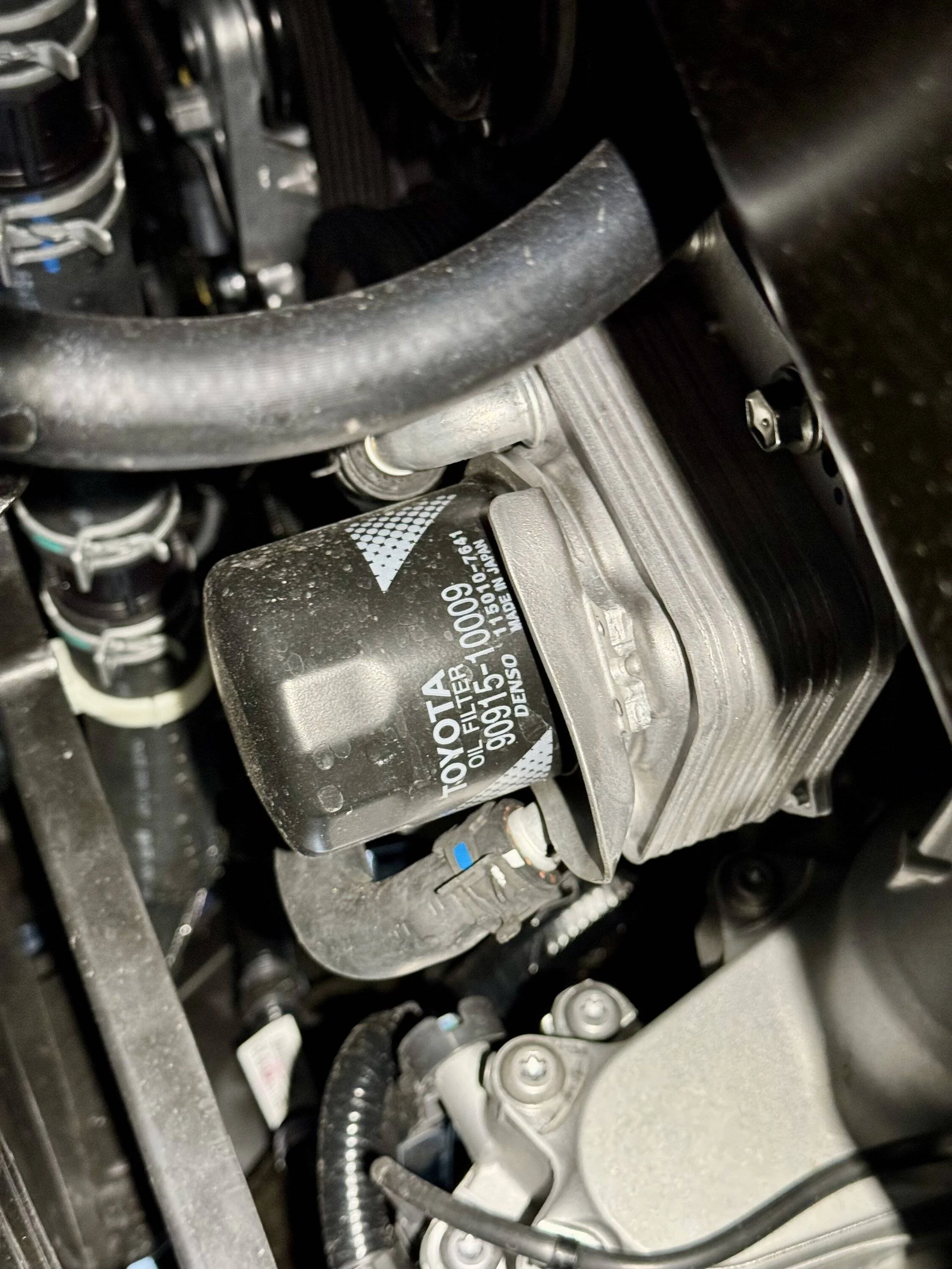

I would idle for a few minutes longer than the Toyota manual recommends after climbing a long steep grade. The new Tacoma has a coolant to oil cooler located at the oil filter, so far I haven't seen a dedicated transmisssion cooler, I may be wrong.
Where I live the mountain grades are steeper than a cows face and long.
I would err on the side of caution and let the truck idle the entire time if I were stopping for a short break at the summit, especially if I was towing or was at or near max payload.
We also have a 2020 F-150 Super Crew 2.7 ecoboost here at our Heliport we use to shuttle helicopter pilots and gear through the mountain pass and that truck has a payload package with dedicated oil and transmission coolers from the factory, I would do the same with that truck even with the extra cooling capacity.
I attached page 187 from section 4 of the new Tacoma manual.
This is cool down time specifically for the turbo for reference.
I hadn't read it before making the above mentioned comment, I always do this with our F-150 2.7 turbo.
This recommendation is for "idling time before engine stop" from the Toyota Tacoma Manual "to prevent damage to the turbo" calls for a 1 minute cool down after steep hill driving or continuous driving over 62/mp/h (100 km/h). That would be the bare minimum in my world.
2024 Tacoma TRD Jon traded his 3rd gen for 2024 Tacoma TRD OR + 600 Mile Road Trip 2024_Tacoma_Coolant_to_Oil_Cooler
