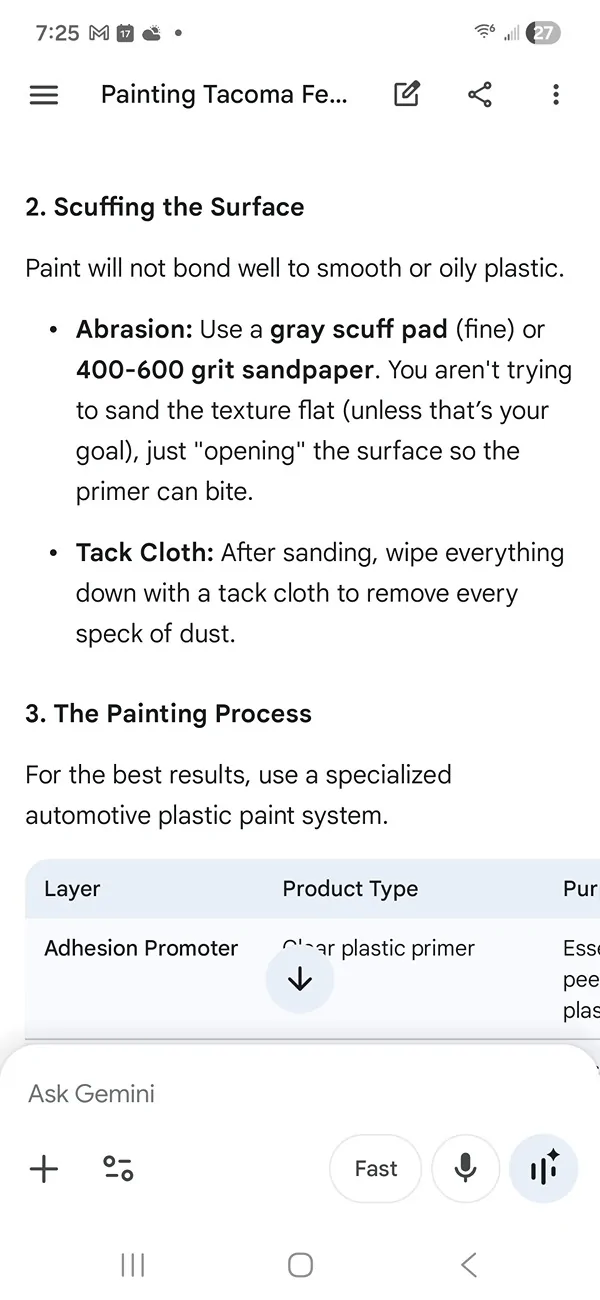

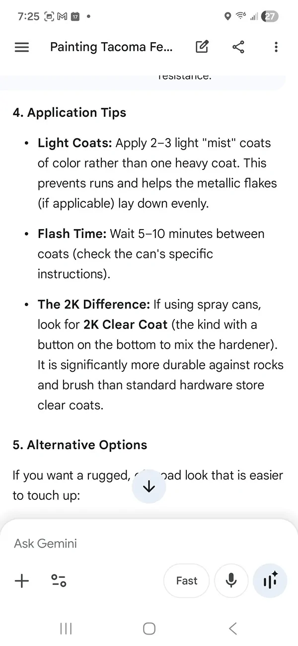

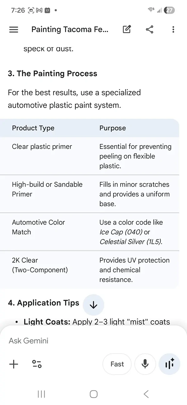

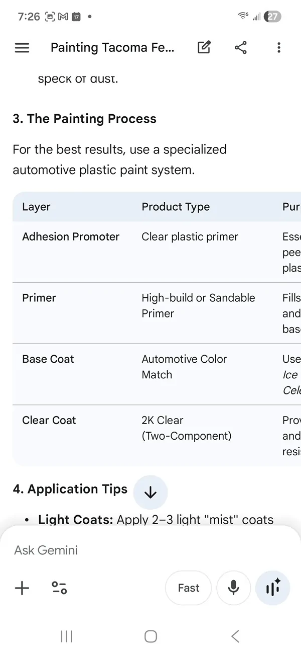

2024 Tacoma TRD Off Road OEM Flares, paintable? Screenshot_20260417_072518_Googl
2024 Tacoma TRD Off Road OEM Flares, paintable? Screenshot_20260417_072552_Googl
2024 Tacoma TRD Off Road OEM Flares, paintable? Screenshot_20260417_072616_Googl
2024 Tacoma TRD Off Road OEM Flares, paintable? Screenshot_20260417_072613_Googl

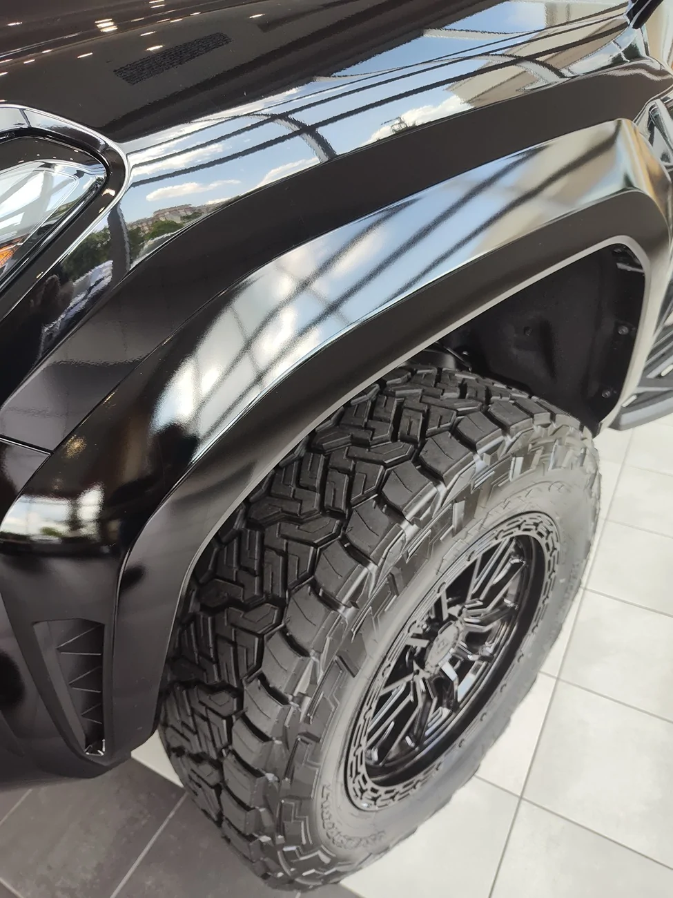

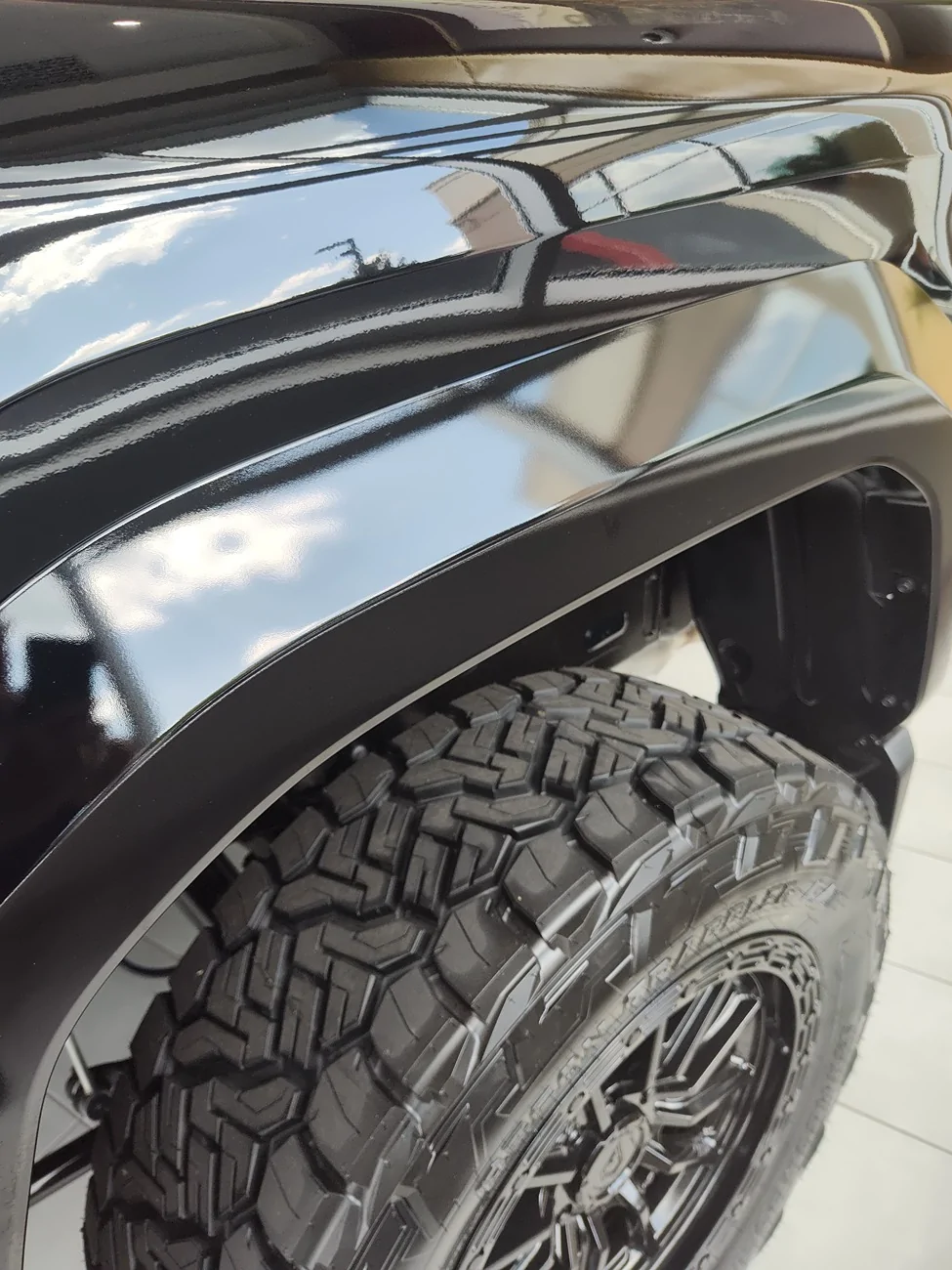

I'm at the local Toyota dealership getting my first check up and found this 2026 TRD OR on the showroom floor. It has painted flares, not as shiny as the body but definitely look to be painted.

I'm not a body guy, but I'm pretty sure that's standard for painted plastic trims. I think something about the additional plasticizers effects the overall finish.
