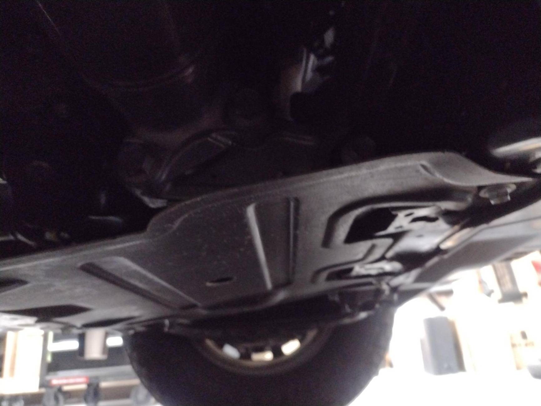

Can someone who has them post a few pictures of the plastic OEM skid plates in place?
I'm curious what these suckers actually look like (no idea what the Limited Hybrid will have from factory until it arrives)

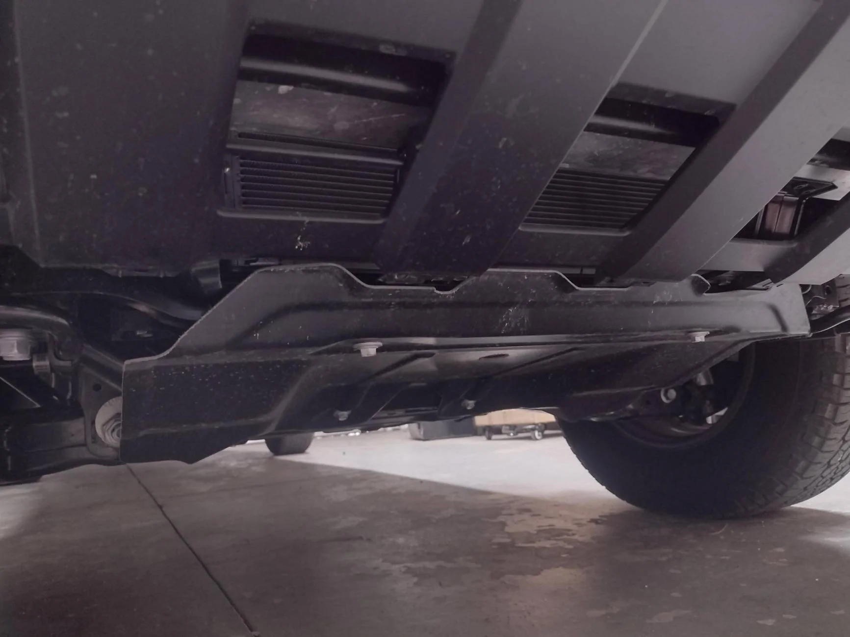

I just installed a TRD Pro skid plate on my Sport utilizing the RCI cross member. I had to buy 2 extra bolts as the sport only comes with 4 for the OEM felt guard.
Worked out really well. I’d say start to finish took me about an hour. Now that the crossmember is in to take it off and put it back on would probably take 15 min.
I would second the comment about it weighing about 20 lbs or so. I used my floor jack to maneuver it around and hold it in place while I bolted it up. Lined up perfectly with the RCI cross member.
Should be way better than the felt cover that was behind the air dam.
