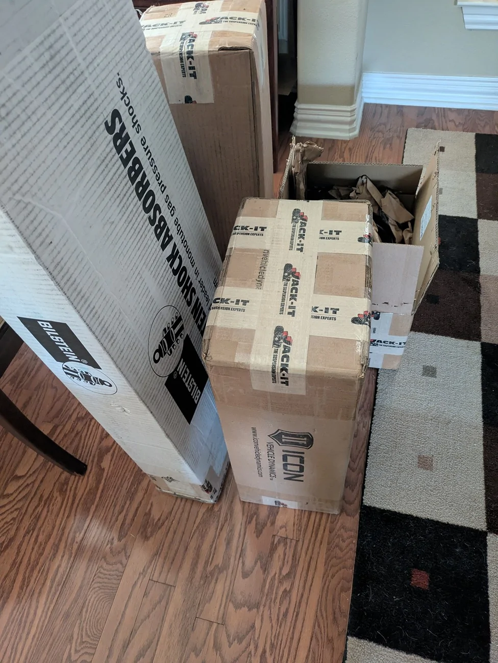

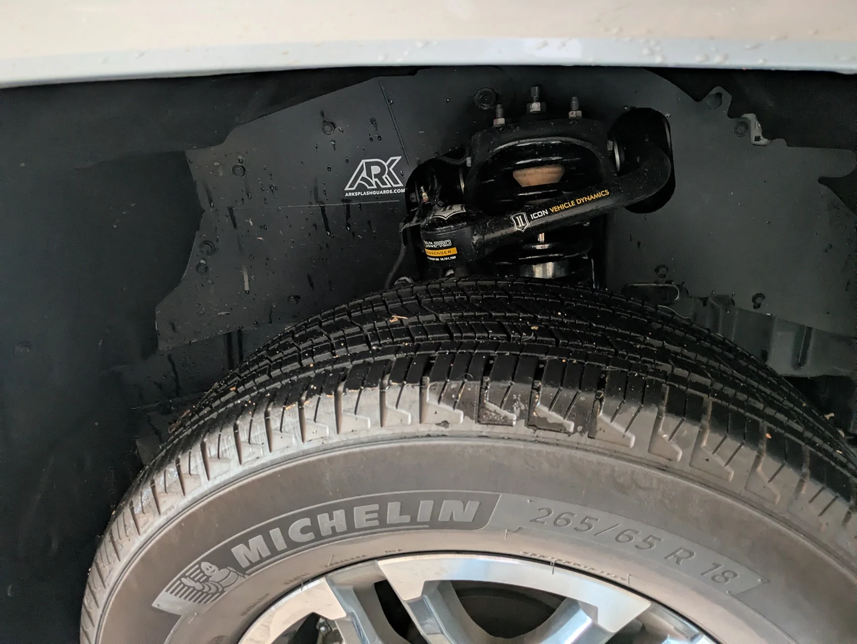

I did a suspension upgrade to Bilstein 6112/6110 with Icon UCAs and rear Icon triple rate springs (add +0.5" rear lift). The front 6112 shocks are set to the 1.6" lift position and it is 0.25" higher in the rear than front, so basically level. On the short drive back from the installer I could notice a difference. The sharp 'pop' on bumps is gone, but you still know you ran over a bump. I'll get a longer road test tomorrow.

I've had a couple days of work commuting and a short road trip that included several miles of rutted dirt road. The harshness of the OEM Sport suspension is gone. The truck doesn't sharply react to bumps anymore. It does follow the road surface contour, but soaks up bumps really well. I've been hypersensitive trying to feel how it's responding now. If driving by myself and focused on it, I can feel very tiny wallowing movement. If just driving and looking for somewhere or talking with passengers I don't notice it. I feel like this setup is what the OEM TRD Sport should have had. So far it seems 99% perfect. Whether it helps my wife with not getting quesy on next month's road trip, I won't know until then. You can still tell you're in a high ground clearance truck and there is some truck motion that's a little exaggerated because of that. It could have to do with tall sidewall tires more than suspension now. But as far as suspension, I think this was a really good solution and what the truck needed. It feels natural and normal to drive.

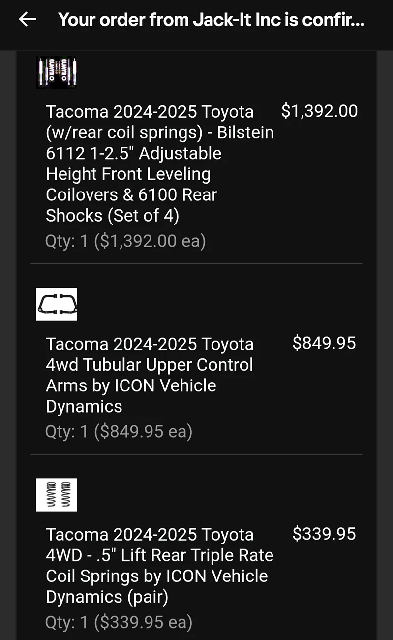

I have a '24 Sport. How much was the new suspension and did you have the work done or do it yourself?
A local off-road suspension shop did the installation and alignment for $1100. They took 1.5 days to do that. Parts pricing is shown.

Thank you. You’ve peaked my interest with this info and driving report.
