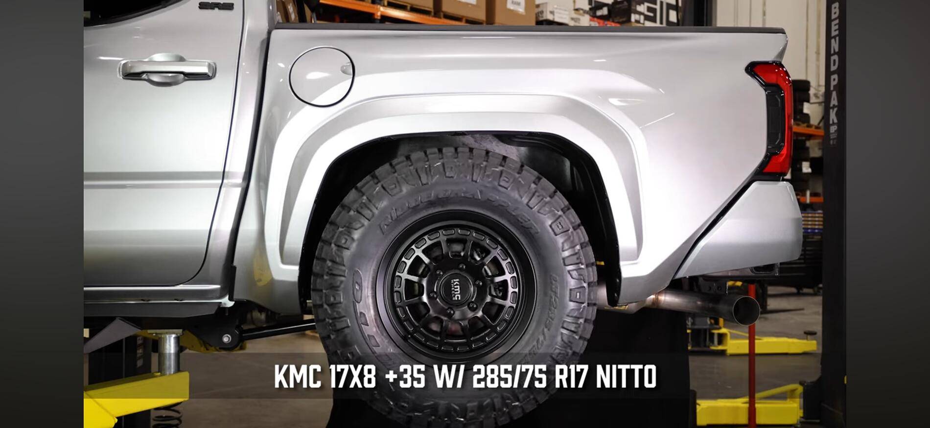

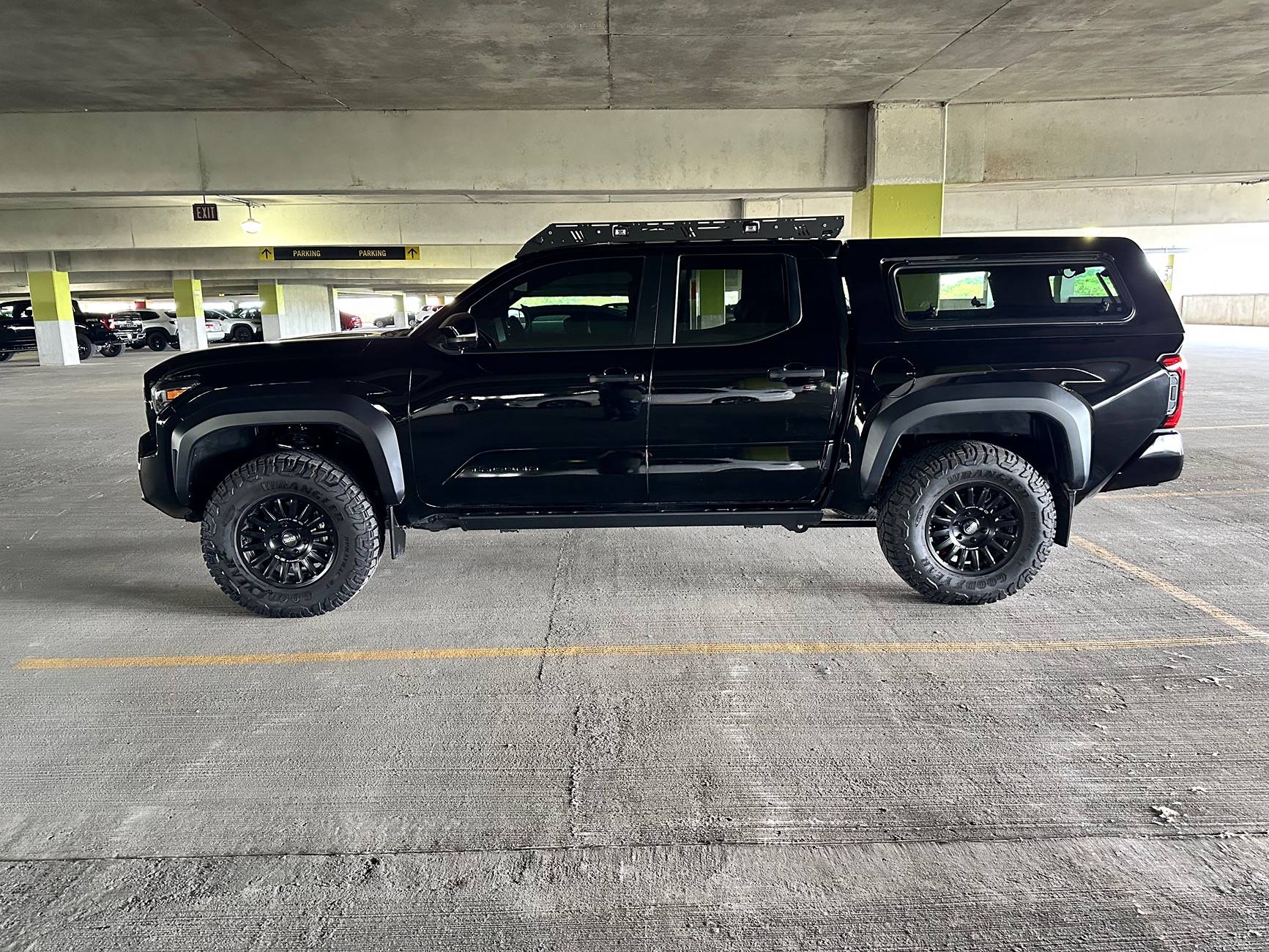

I considered Westcott but their times are 4-5 months out. I finally got a chance to run by my shop and put the 285s against my stock height 4G, it’ll definitely be taxing on turning radius but just sitting static, it should be fine. I might just leave them alone (crash bars)…
