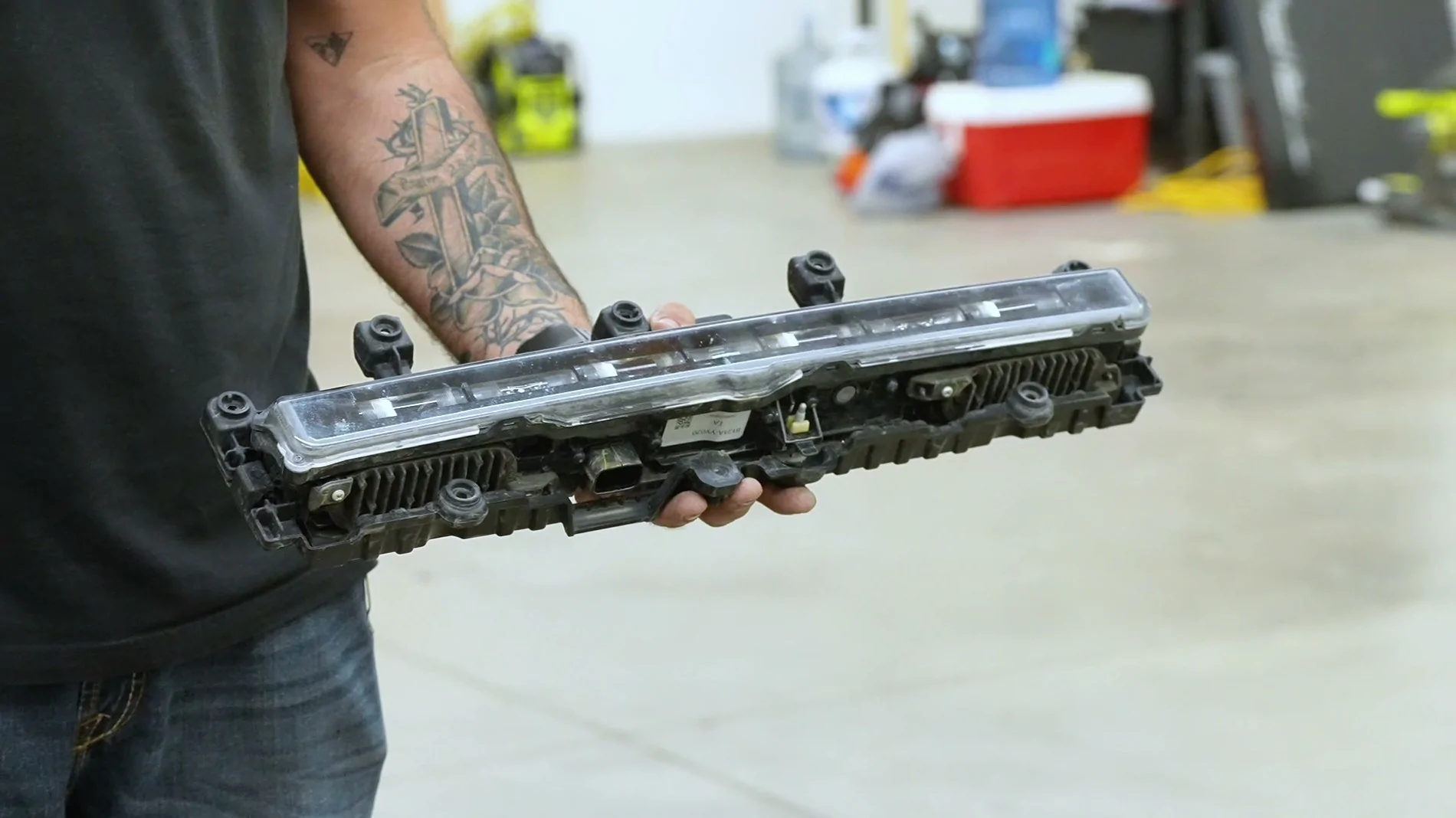

One small feature on the TRD Pro and Trailhunter factory grille bar matters more than you'd expect once you start researching aftermarket upgrades. It turns on automatically when you flip the stalk for high beams. Pull the stalk, bar lights up with your brights, with nothing to do from the driver seat. Swap in any drop-in aftermarket bar on this platform and you lose that. The signal isn't an analog 12V wire anywhere in the engine bay. It rides the CAN bus as a digital message, which means aftermarket kits can't see it without a decoder. So every replacement kit ends up shipping with a cab switch and a relay harness you mount somewhere on the dash, and you reach for that switch every time you want more light.
Triple-R out of the UK has built a module called the CANNY Interface that reads the 2024+ Tacoma's CAN bus directly and closes a 12V trigger circuit when it sees the high-beam message. That's what caught my attention. Factory behavior is preserved on the driver side, with the Linear-18 Elite+ lamp in the grille instead of the OE bar. No switch in the cab, no wire through the firewall, no thinking about it after install day.

2024 Tacoma Triple-R's Linear-18 Elite+ grille kit on a Trailhunter: install, CAN bus, dual-color 03-factory-bar-canbus-modul
The factory grille bar pictured above has its own CAN bus module built in, which is why disconnecting it doesn't throw codes and why aftermarket wiring gets complicated on this platform.
CANNY is a sealed decoder module from Triple-R's sister brand Lazer Lamps. It sits between the truck's CAN bus and the bar's trigger leg, reads CAN frames, filters by message ID, and closes a 12V relay when it recognizes the high-beam event. Two SKUs at checkout with the same end capability:

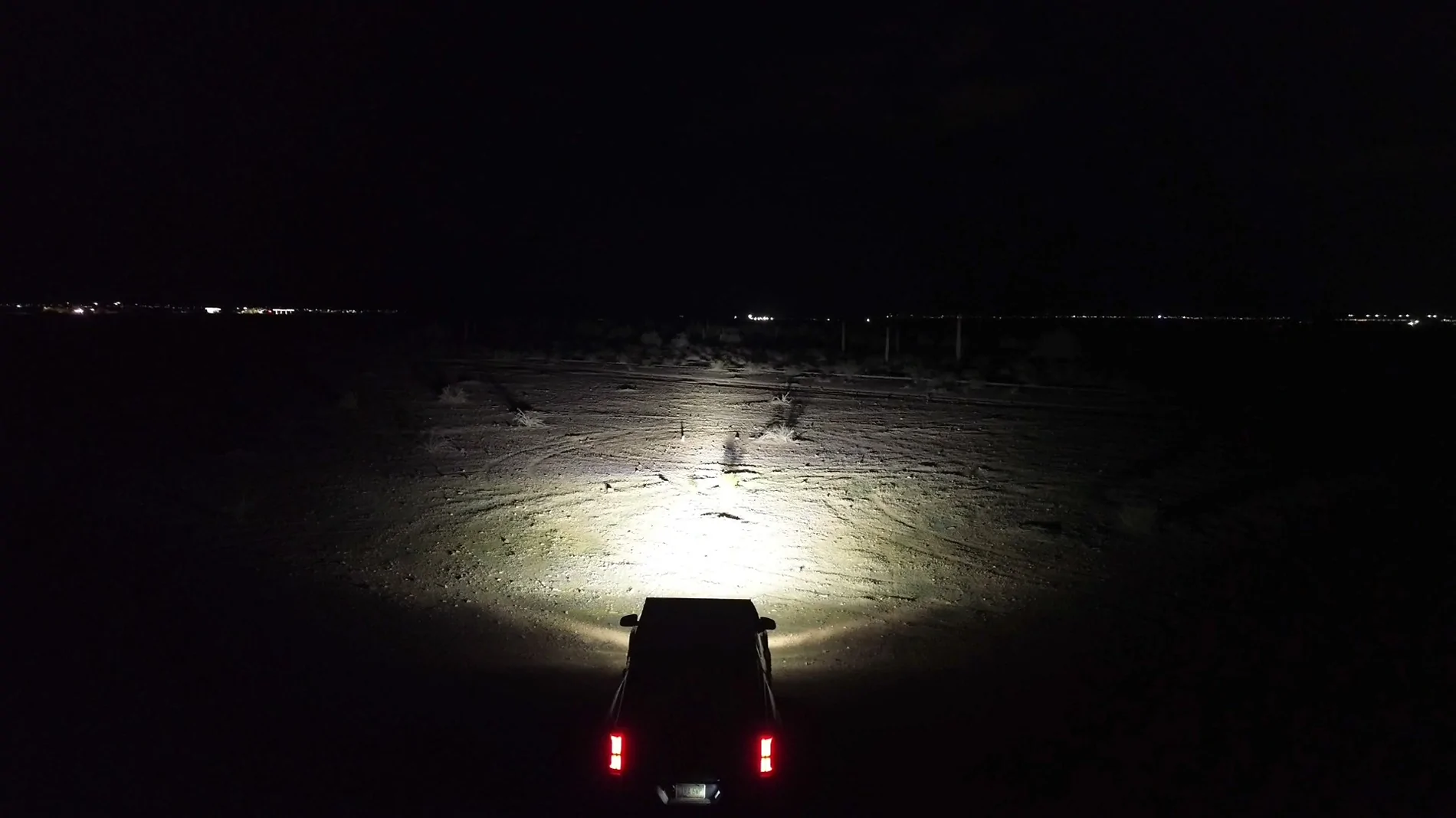

Same location, same camera angle, three modes:
2024 Tacoma Triple-R's Linear-18 Elite+ grille kit on a Trailhunter: install, CAN bus, dual-color 04-mode-whit
White mode at 5000K, full 14,850 lumens, broad spread for open desert and trail running.
2024 Tacoma Triple-R's Linear-18 Elite+ grille kit on a Trailhunter: install, CAN bus, dual-color 05-mode-yello
Yellow mode (PC-amber): cuts through dust, fog, and snow without scattering back into your eyes the way white light does.
2024 Tacoma Triple-R's Linear-18 Elite+ grille kit on a Trailhunter: install, CAN bus, dual-color 06-mode-combo
Combo mode: 36 white + 18 yellow LEDs all active, 21,000 combined lumens with a warm bias that balances distance throw and peripheral visibility.
Yellow mode was the feature I didn't know I wanted. Living in Arizona, dust plumes from lead vehicles turn white light into a wall because the particulates scatter the beam right back at you. Yellow cuts through that the way fog lights do. First time I ran it behind another truck on a dirt road the difference was immediate.

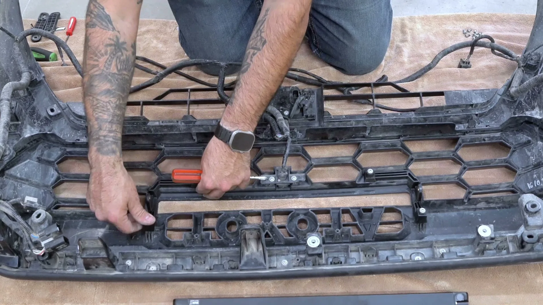

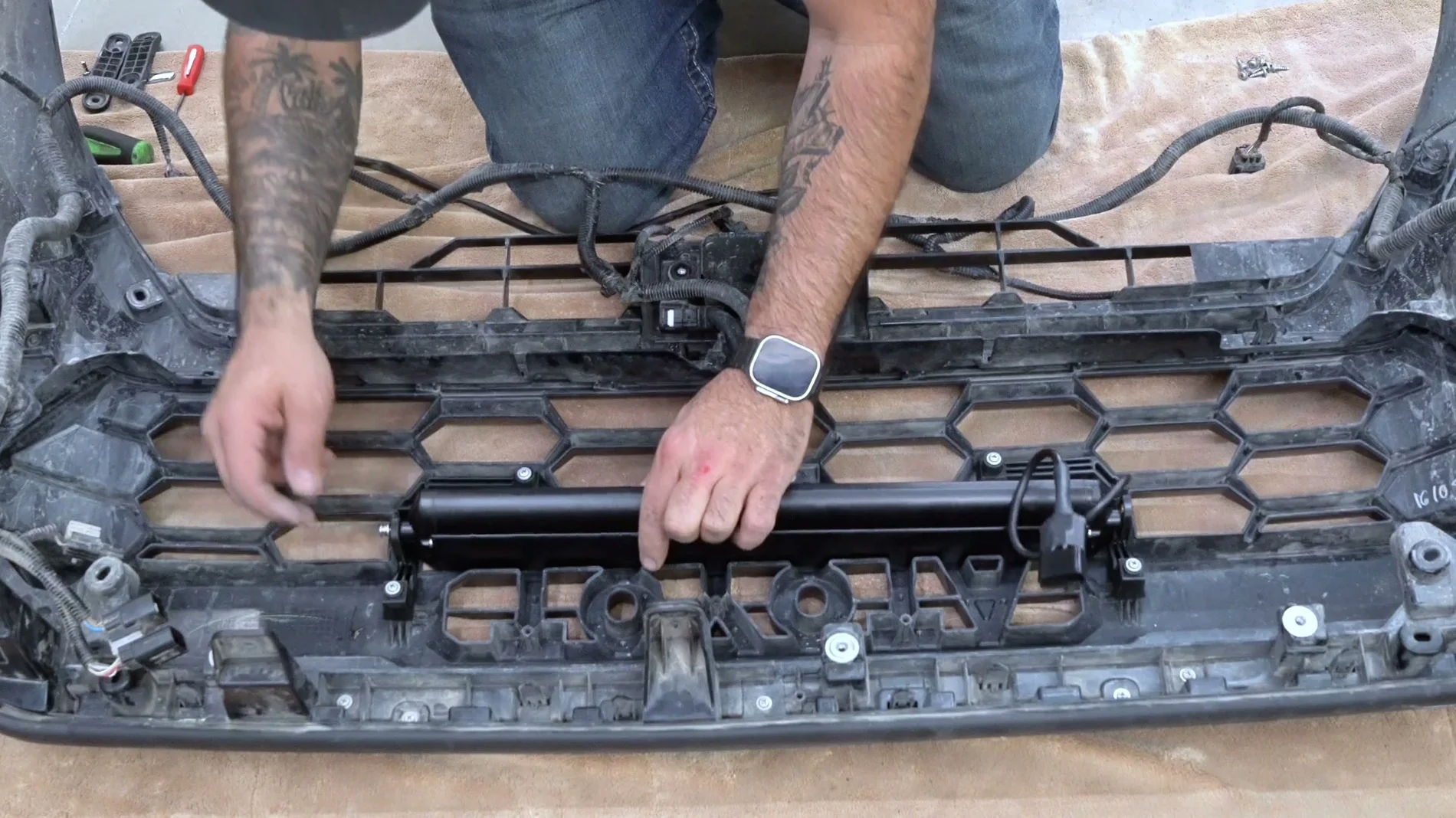

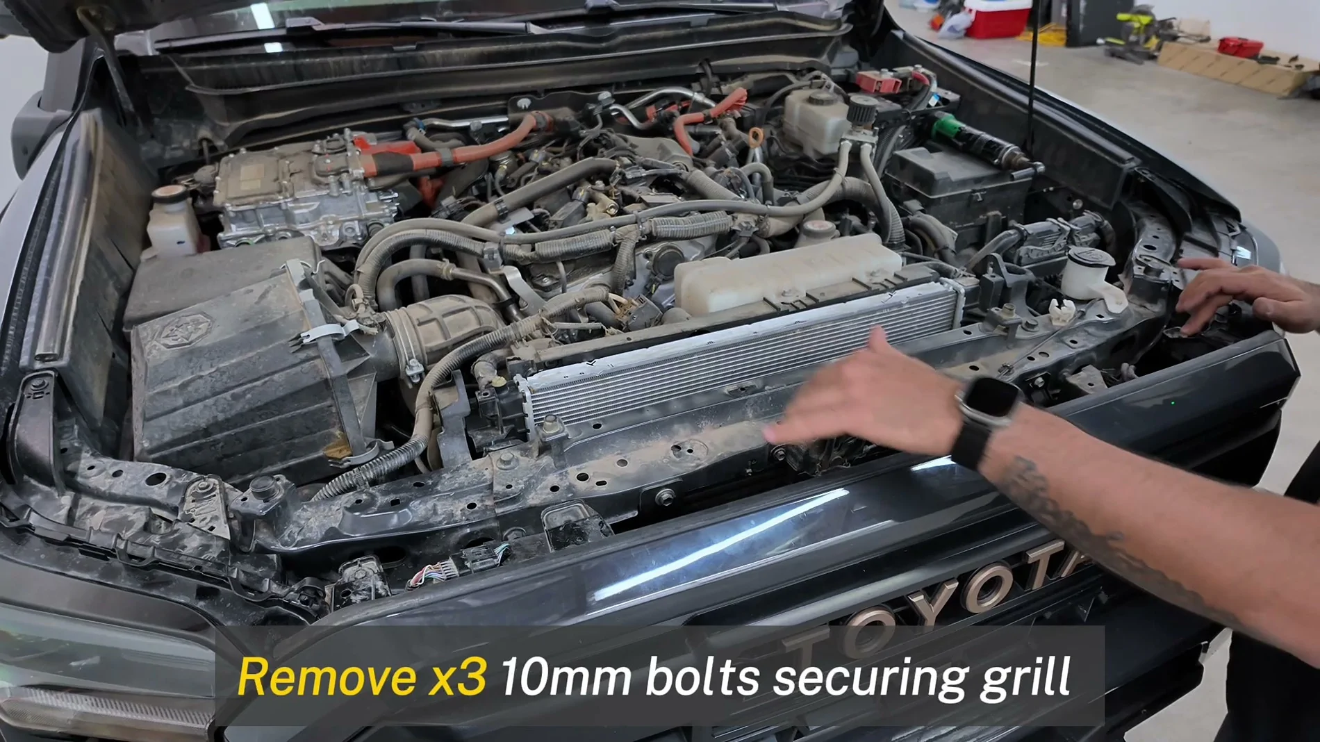

About 45 minutes on the grille side for someone comfortable with basic hand tools. Three 10mm bolts hold the grille to the core support. Unplug the fog lights and parking sensor harness on each side, release the retaining clips along the bottom edge, and the whole grille assembly slides forward and off.
2024 Tacoma Triple-R's Linear-18 Elite+ grille kit on a Trailhunter: install, CAN bus, dual-color 07-grille-removal
Triple-R ships two composite brackets coded LHOB (left) and RHOB (right) that engage with the factory mounting points on the grille frame. Anti-theft fasteners secure the bar, and Triple-R recommends thread seal compound with an 8 Nm torque spec.
2024 Tacoma Triple-R's Linear-18 Elite+ grille kit on a Trailhunter: install, CAN bus, dual-color 08-brackets-mounted
Cover pieces snap over the bracket ends for a clean finished look. Reverse of removal to reinstall.

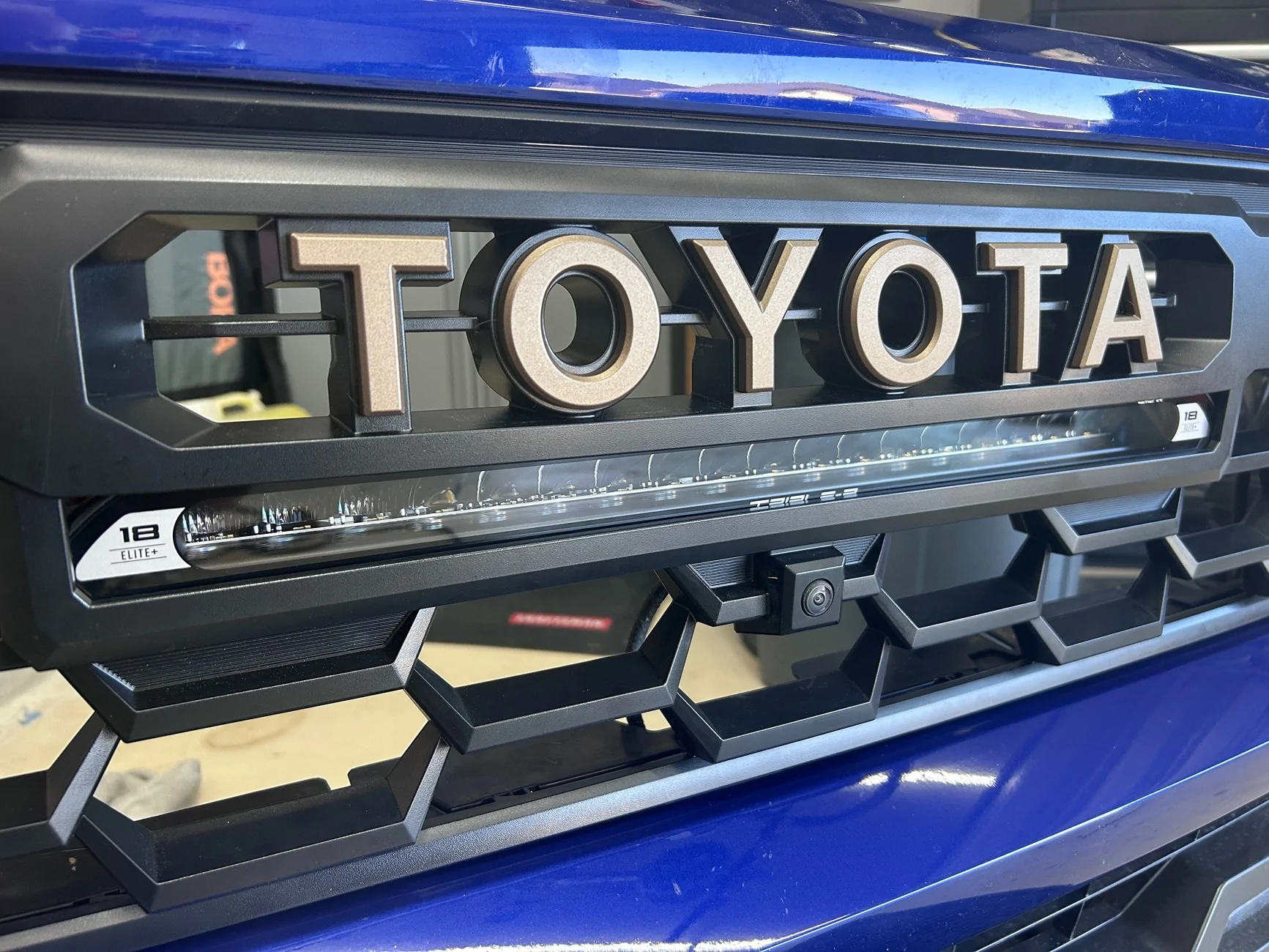

Very nice write up. I have the exact same bar in my grill, however I went overboard with 3d printing a bracket to utilize more of the OEM mounts. I found just using the ones on the sides resulted in a lot of vibration since the grill itself is a tad flimsy. I also eliminated the CAN bus by utilizing a module to translate the momentum switch into a toggle switch and used a TRD Light Bar switch from the Tundra, and then rigged a blank momentum switch next to the aux lighting buttons to toggle modes (the black one next to Aux3). Definitely overkill, but I wanted it to look close to OEM as possible.
