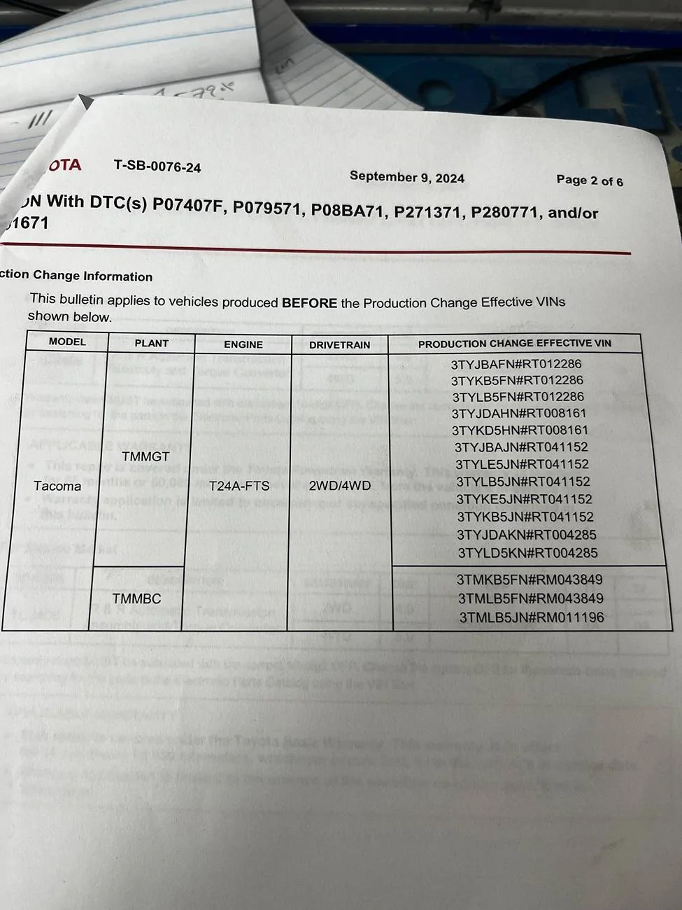

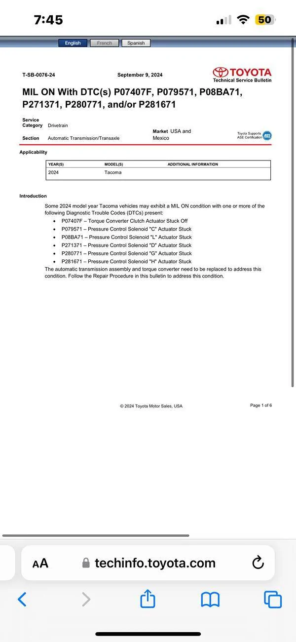

Here it is guys, official technical service bulletin for the codes that relate to transmission failure.
**UPDATED WITH PRODUCTION CHANGE EFFECTIVE VINs**
Steps to figure out if your VIN is in the TSB (by @taco_overlander).
1. your VIN is an exact match to the letters and numbers to the left of the "#" in the TSB list
2. your VIN has a number to the right of the "#" that is less than the number in the matched line found in 1.
If you can do both 1. and 2., your VIN is in the TSB

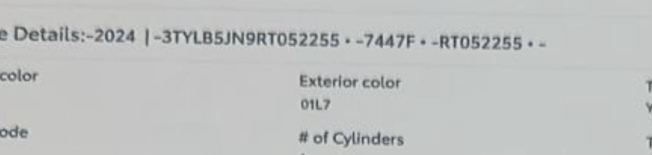

Hi, I’m about to buy a news Tacoma but I have no idea how to tell if my unit is affected.. I don’t understand how to tell, this is my vin please somebody help me

You do not fall under the TSB
