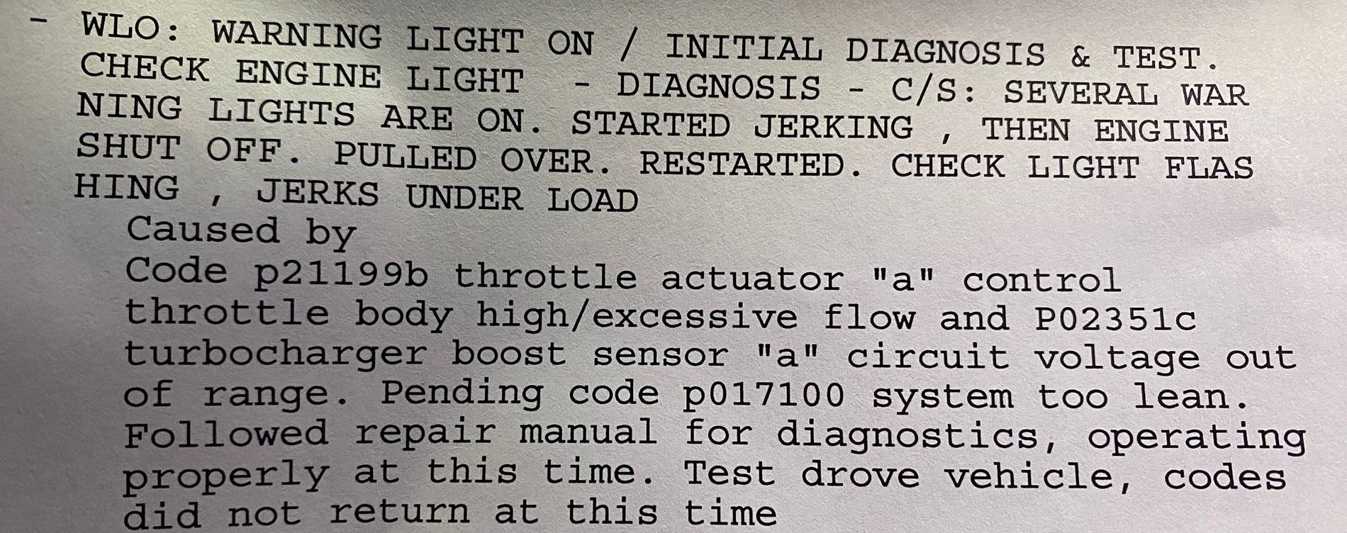

Well the good news is they were able to look at it tonight. The bad news is the results were inconclusive. The error codes didn’t indicate a definite problem and after they cleared the codes and test drove it they had no issues.
Honestly I NEED the truck badly for the next few days. Visiting a few different sites in the mountains during a bomb cyclone! Don’t want to try making it around in a rented Elantra. Just hope this problem doesn’t get worse until I get home.
I hope they documented the codes that were thrown in case it turns out those are the ones needed for the TSB.
Were the error codes the same as what was listed in the TSB? ( If so they are supposed to replace the tranny and torque converter.
Were the codes for solonoids and same as what was listed in the TSB? If so they are supposed to replace the transmission and torque converter. It's apparently not supposed to be that you drive around after this incident and get stuck somewhere. I would check with them again and/or Toyota Corporate and see what the protocol is! Nothing worse than driving around with a ticking time bomb!
Great question. I didn’t even look at that. Here is the report I got:
None of those codes are on the TSB. So if this wasn’t transmission related then WTF happened?? I’m actually more concerned now! Haha
Looks like you're fuel started to cut out and a throttle body got stuck open causing the lean code and the first code. Then probably as it was throwing codes something got messed up in the crossfire and that was your turbo sensor reading too high

Good points Fisher. Maybe the event happened because as you mentioned you're driving at altitude and in the mountains. Maybe a sudden change in altitude, temp or since you're in the "bomb/river", humidity or moisture. All meaning maybe/hopefully it was a one-time event. It sounds like it's running MSFT Windows where a reboot might have fixed the problem (unbelievably).
