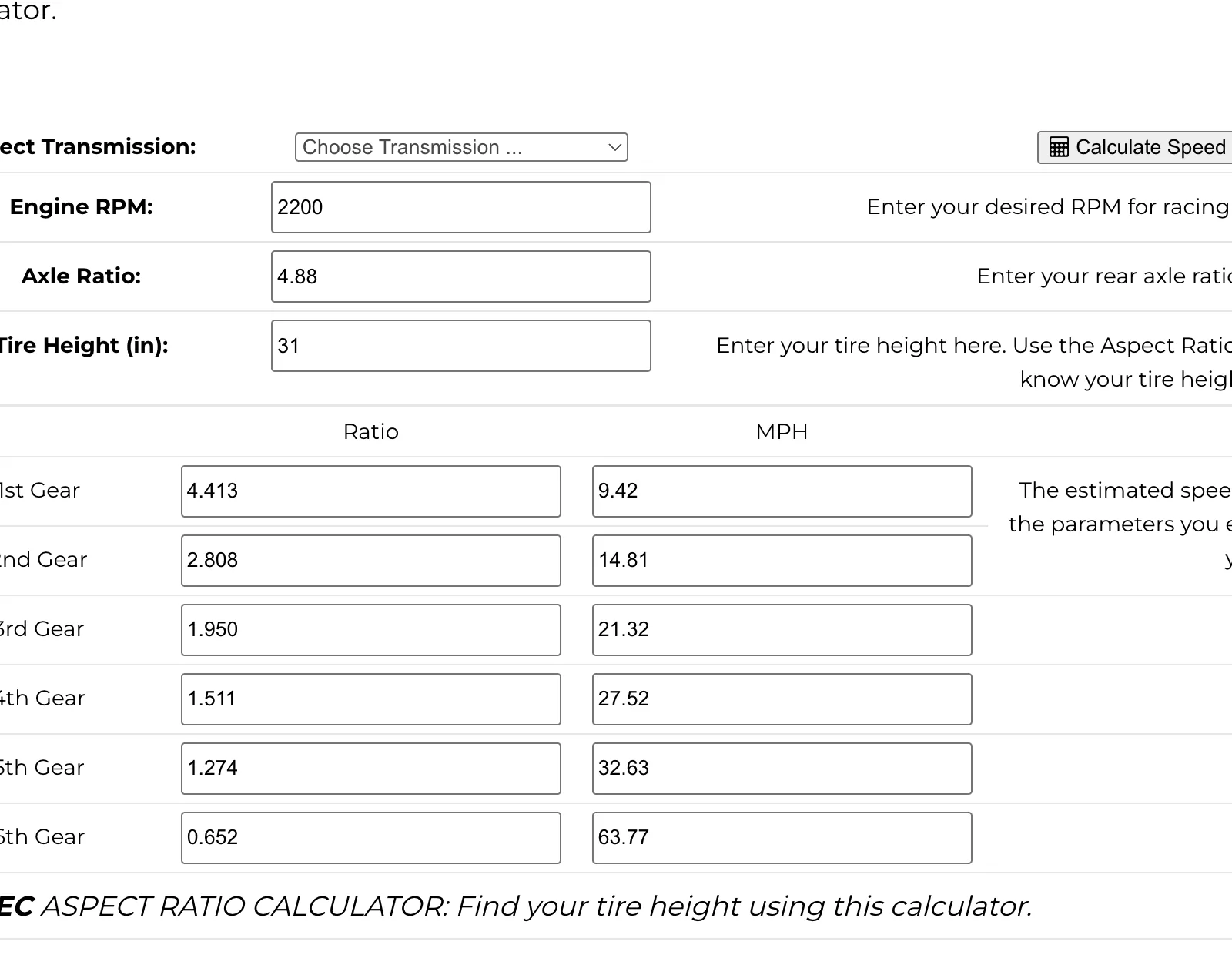

Plugged in the AL80F numbers here:
First gear checks out, that's short enough.
But 1500RPM @ 15mph should be more in the 2nd gear range and not the 3rd gear.

Here I dropped in 4.88 gears and "6th" is actually the 8th gear ratio for the AL80F, 63mph = 2200 RPM which is actually fine, since I ride around in 7th gear @ 65 which is about 2000RPM.
4.56 gears are also an option..

I really think the factory 3.58 gears are just way too tall for a small engine without doing some really wonky tricks to make power.
