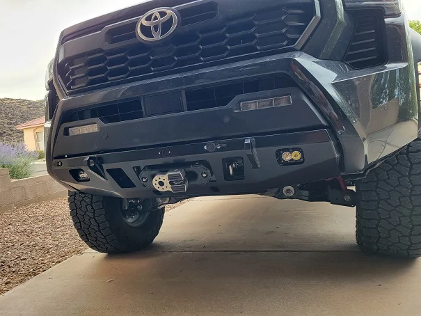

I have two issues with this type of winch bumper. First, you can't see the spool. Anybody who has used a winch knows the line can bunch up on one side during a pull. Especially during an off-angle pull.
Second, the winch control box is inaccessible. A provision will need to be made so the winch can be controlled. Some folks use a battery powered remote. Others remote install the solenoid box under the hood. I installed the control box extension and mounted it to the front of the bumper.

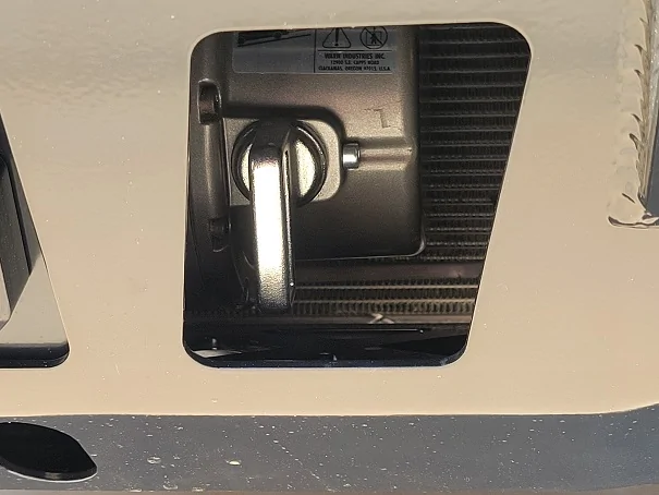

There is a third issue, but it's easily resolved. Access to the clutch handle. The solution is to clock the gear box handle to point toward the opening in the bumper.
My C4 bumper.

Clocked clutch handle for easy access.
My C4 bumper.

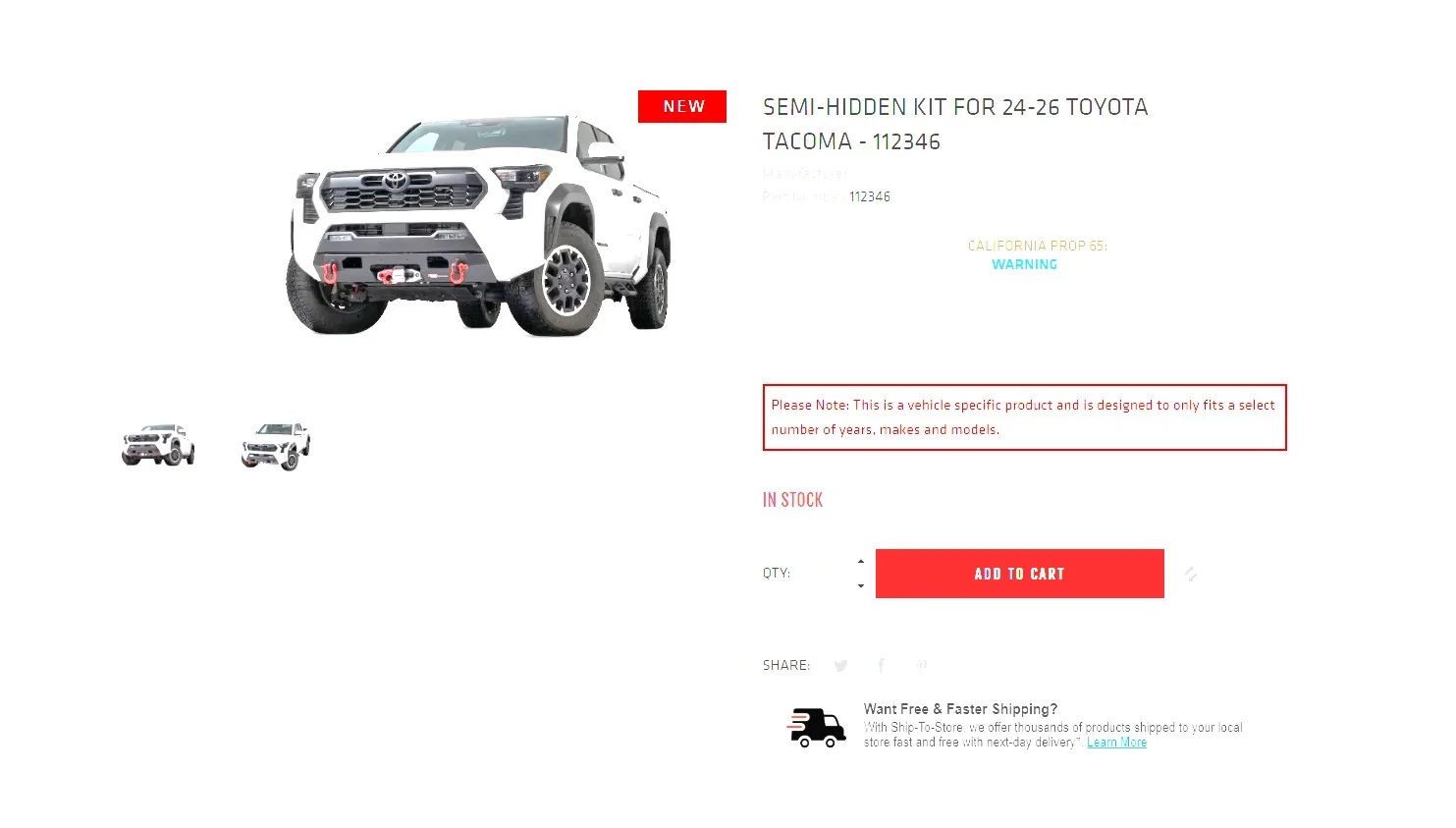

Anyone try this out yet? On their site, its in stock and can ship as early as 2 days to a local retailer.

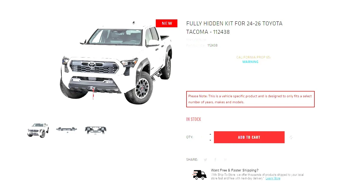

And, they also have a fully hidden option as well
Ive emailed asking for more info, weight, install, etc
