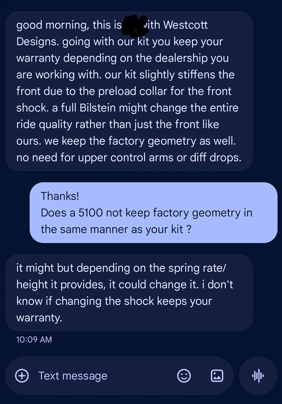

Just curious about other folks' thoughts/experiences regarding these claims from Westcott. Anybody checked with their dealerships to see about warranty post-westcott lift ?
My hunch is: no, your suspension will not be covered under warranty if you install an aftermarket lift or level and something fails. Sure you're protected under Magnsusson Moss, but I'd put money on just about any dealer denying any suspension claim if the preload touches it or alters it in anyway.

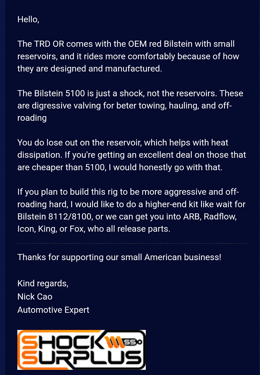

Bilsteins were $505 delivered which, with the SR5 suspension, were an upgrade so I ordered those. But a member here is actually giving me his Hybrid OR take offs, so might go that route and see about a preload or spacer later.
Side note: Shock surplus has some damn good service. I had reached out with a question about Bilstein v.s. OEM OR and they didn't even try to sell me anything. Just helped.

That's a great response from a vendor who is effectively talking you out of a sale. And he is correct in his statements.
Also - "digressive" damping is marketing for a regular shim stack valve. The damping reduces as shock shaft speed increases, which flexes the shims away from the piston port for more fluid flow. Most performance shocks are "digressive" unless they have some additional tech/features.

I just called two dealers in my area. One said it would void anything the aftermarket touches or effects if there is an issue, even if it is TRD take-off suspension since it did not come installed in my SR5 from the factory.
The other said as long as it is TRD branded, like the Off Road Hybrid take off suspension a member is giving me, then they'd cover it. Bilsteins or a preload collar they would void the warranty on suspension parts if it changed any associated angles.
