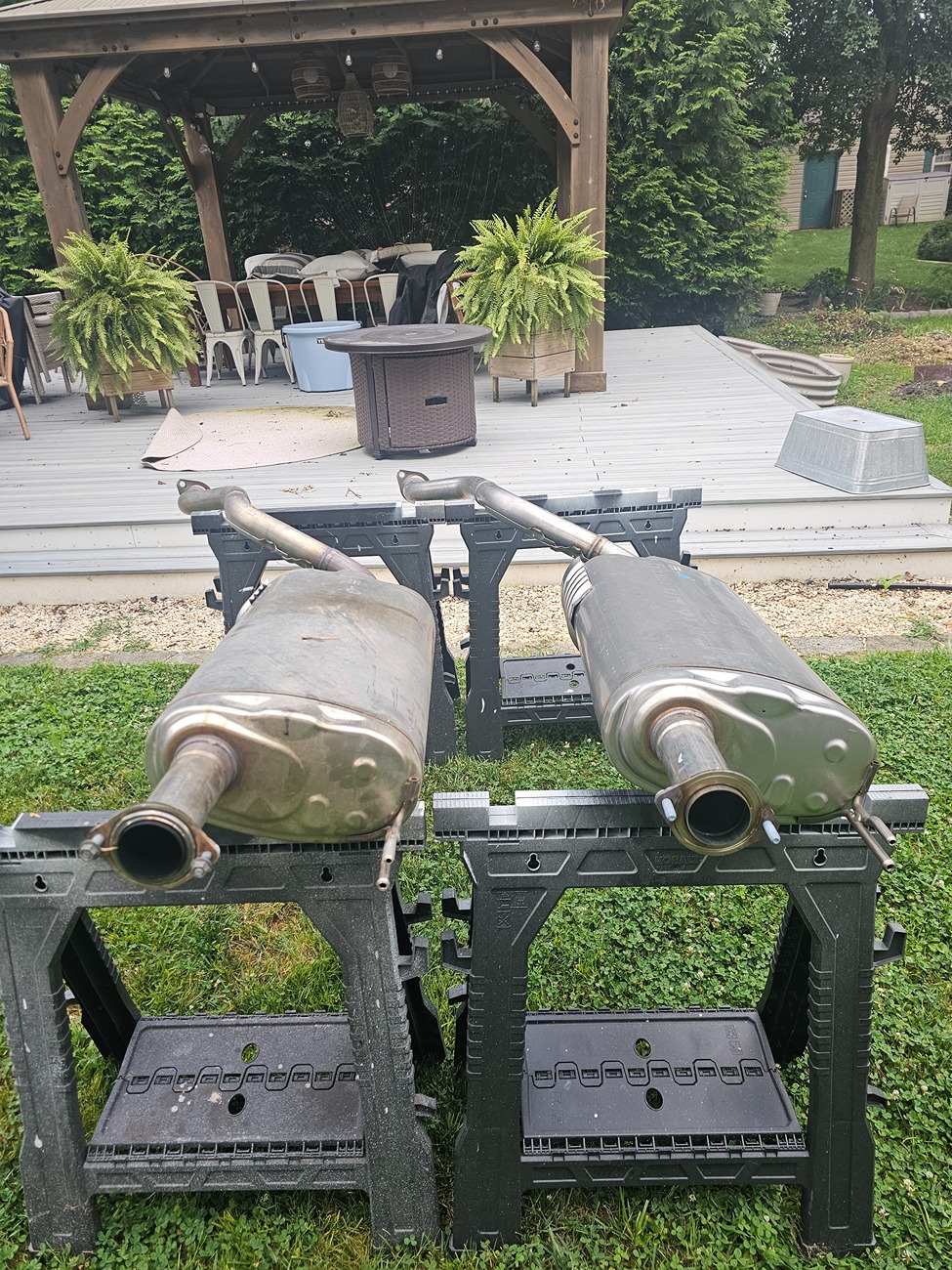

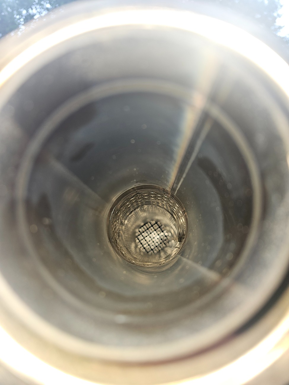

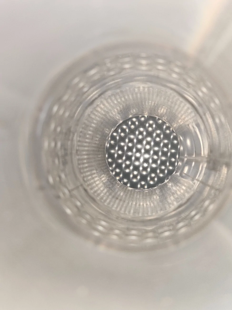

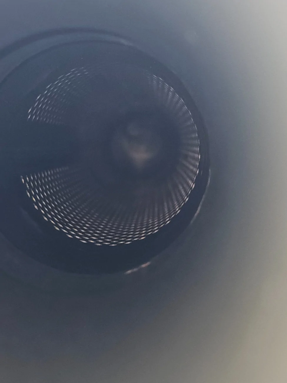

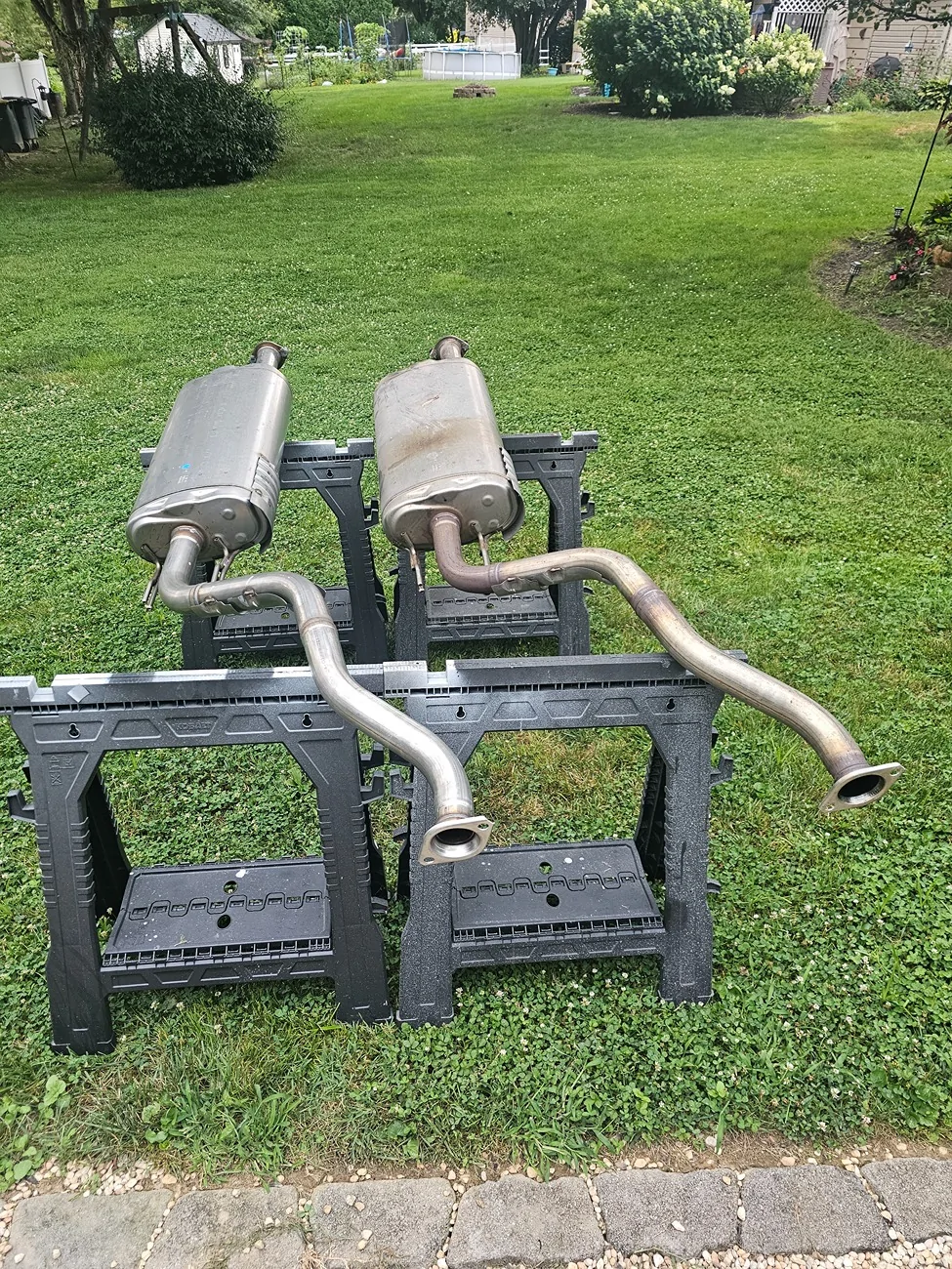

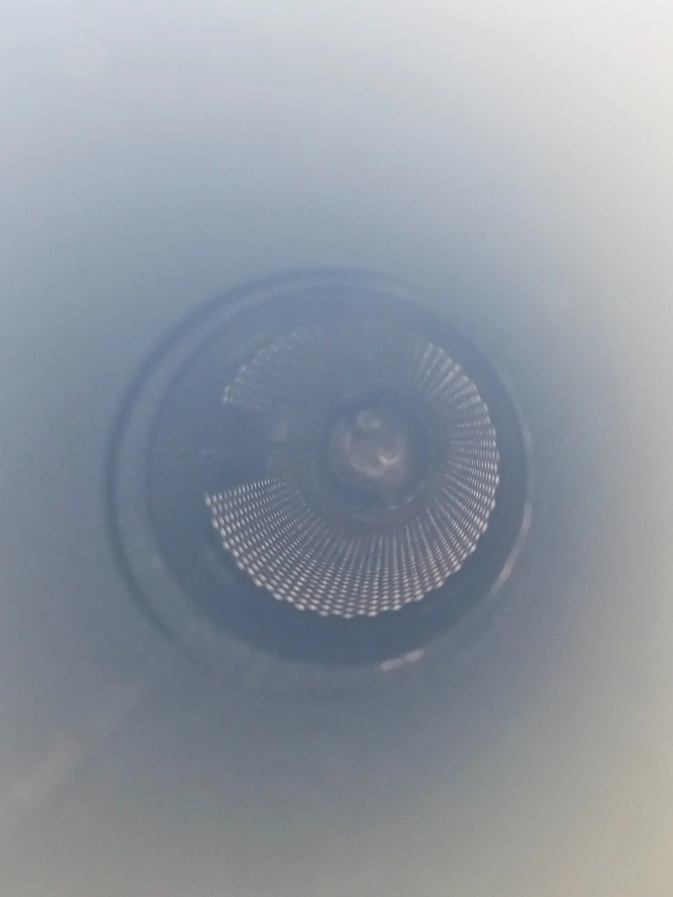

So for anyone interested, I just bought the TRD muffler for comparison purposes. They allowed me to return it if I decided not to use it. It is identical the stock center pipe assembly, however on the inside, it is infact a bit different. Haven't had the chance yet to install though.

Interesting…. Thanks for the pictures.
My truck came with the TRD ā€˜cat back’ as a factory installed option, and I’ve wondered if the center pipe/muffler is in fact any different or not….
