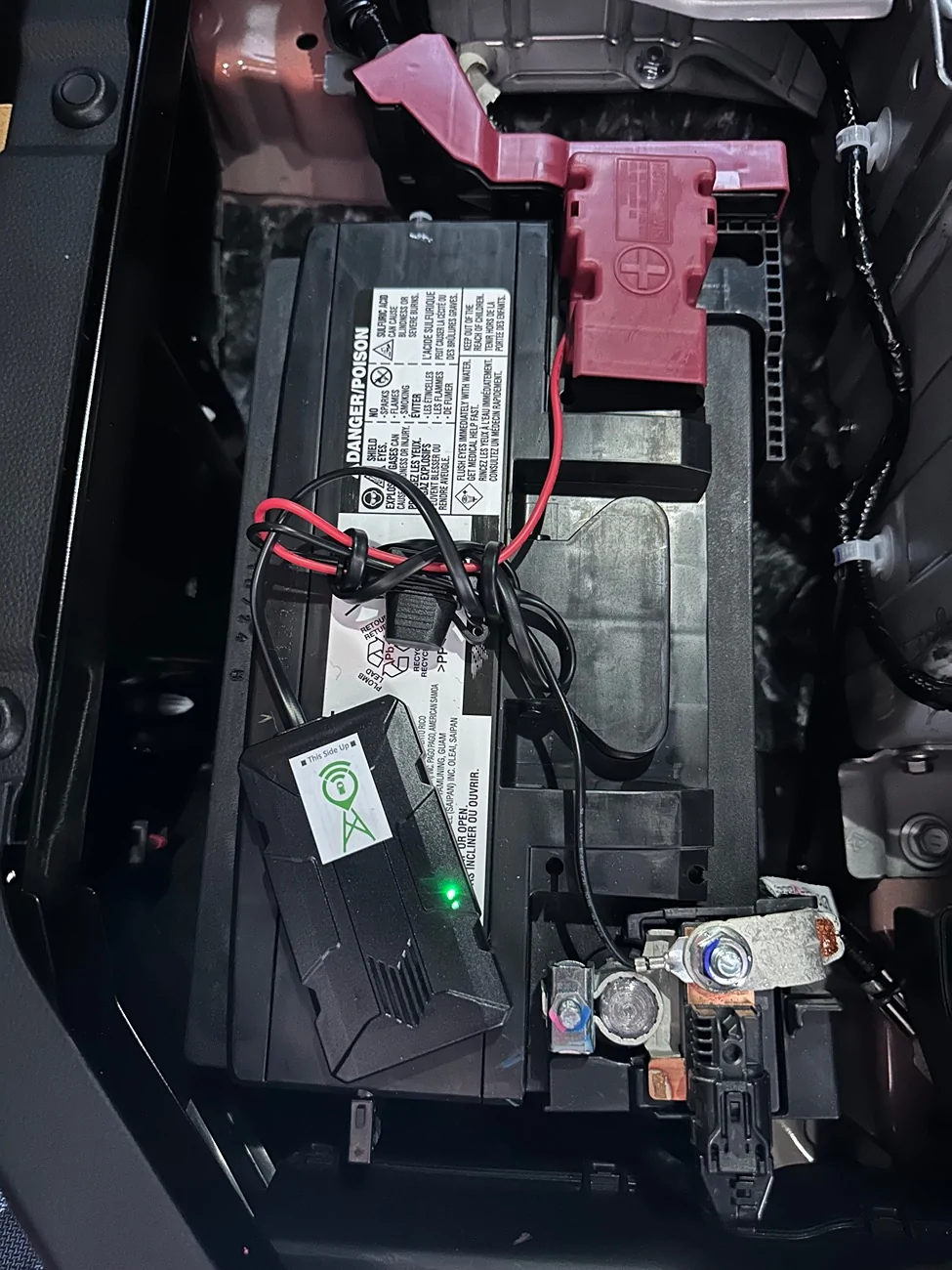

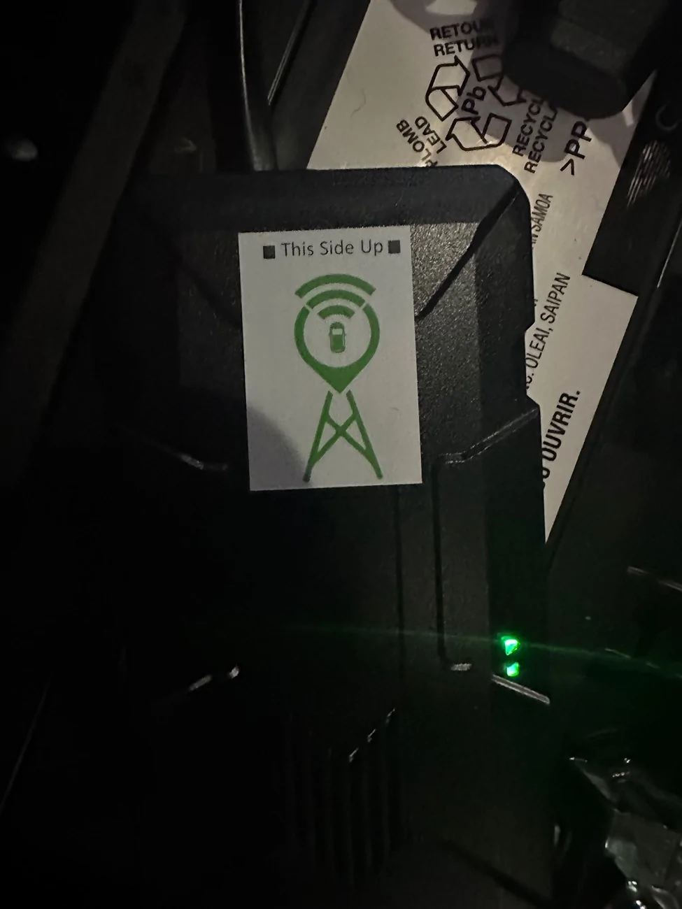

Any idea what this signaling device is or does?
mattski2112
Nov 15, 2024
92
90
Georgetown, TX
2024 TRD Off-Road Premium, Hybrid. As you can see, this device is hooked to the 12v battery under the rear driver’s side seat. Any idea what it is or does? I’m about to disconnect it and toss it in the trash…
2024 Tacoma Any idea what this signaling device is or does? IMG_2226
2024 Tacoma Any idea what this signaling device is or does? IMG_2225

As Sagebrush said, that's a 3rd party GPS unit. My dealer had one on my truck and I told them at purchase to remove it because it wasn't financed through them and was no longer their property once I had keys in hand. They "conveniently" forgot to remove it, so I did when I got home that day and tossed in the trash.
...I should have connected a small battery to it first :crackup:

That's an aftermarket GPS tracking device. Is your truck leased?
Yep. I Google searched the image, and it's an Ikon Technologies GPS tracker. Commonly used in rental, loaner, demo, or BHPH lot cars. Sometimes added as a dealership option but nobody ever really wants it.
If your truck is leased, leave it. If you own your truck, remove it.

During the finance guys BS about getting a monthly subscription to track in case of thief, I said I'd throw an air tag in the truck and it wouldn't cost me every month. He said fine and started to move on. I asked him if a tracker was already in the truck, and he said yes. I said I wanted it removed and I got the lazy "we will not activate the subscription so it will not be active". I told him if I find it, its going in the trash. They didn't care.
BTW, when I found it, it was under the dash and wired via a pass-thru OBDII port lit up like a Christmas Tree, lots of blinking lights even with the truck off, so I am not believing that is not active if there is no monthly subscription.
Mine went straight to the trash can, just like I told the dealership. Never heard a word from them. They make enough off of these to let a lot of them just be given away.

Are there any locations in particular that these trackers would be? I already disconnected my antennas from the telematics module and there doesn't appear to be anything connected to my battery in the engine bay. I guess I need to go look in the dash for this fella...
