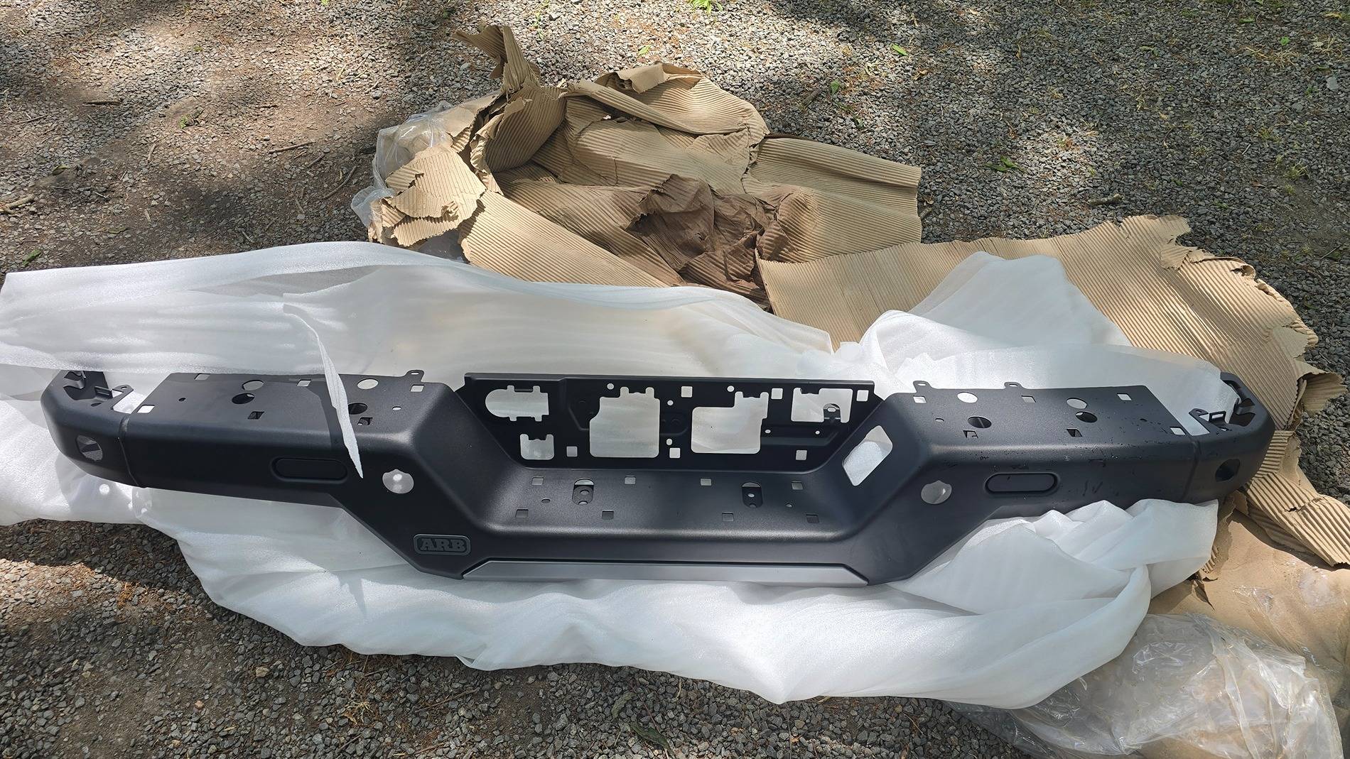

What parts do i need for a ARB rear bumper?
Novax
Michael
Mar 4, 2025
Novnov111!!!
Tacoma 2024
I bought this bumper on FB but does anyone know what other parts I need to put in my off road? Can I use the parking sensors that I already have?

Check out my install thread. It has the install instructions and tells you to reuse the stock sensors rather than the new ones provided.
You likely can reuse the stock harness, but the harness clips will not be in the same place. You can zip tie the harneess down after everything is connected
https://www.tacoma4g.com/forum/threads/arb-rear-bumper-installed.11111/
One comment on your post, it is hard to tell if other things are missing and if you just got the shell or the brackets, covers and other peices that normally come with it. The install instructions have a parts list. My comments above assumed you got all the misc parts that comes with it

You can completely reuse everything, Toyota will tell you you have to bye all new sensors and harnesses because they want to reprogram the truck after it throws all the nanny codes. Just like anything with the truck, be sure to keep the key fob, at least thirty feet away from the truck, be sure to disconnect the power before you start.
If you use new harness and new sensors, the truck will have to be taken in and recalibrated fyi. I've looked into this extensively. I hope you got a good deal. Good luck with your project.
Thanks for the info. I'll be reusing all the stuff I can but there are some plastics on both sides I need to find the part number. Yeah I did, for 250 I couldn't say no

Please post some pics when you finish the project. And please share the part numbers for the plastics if you find em. Thanks!
