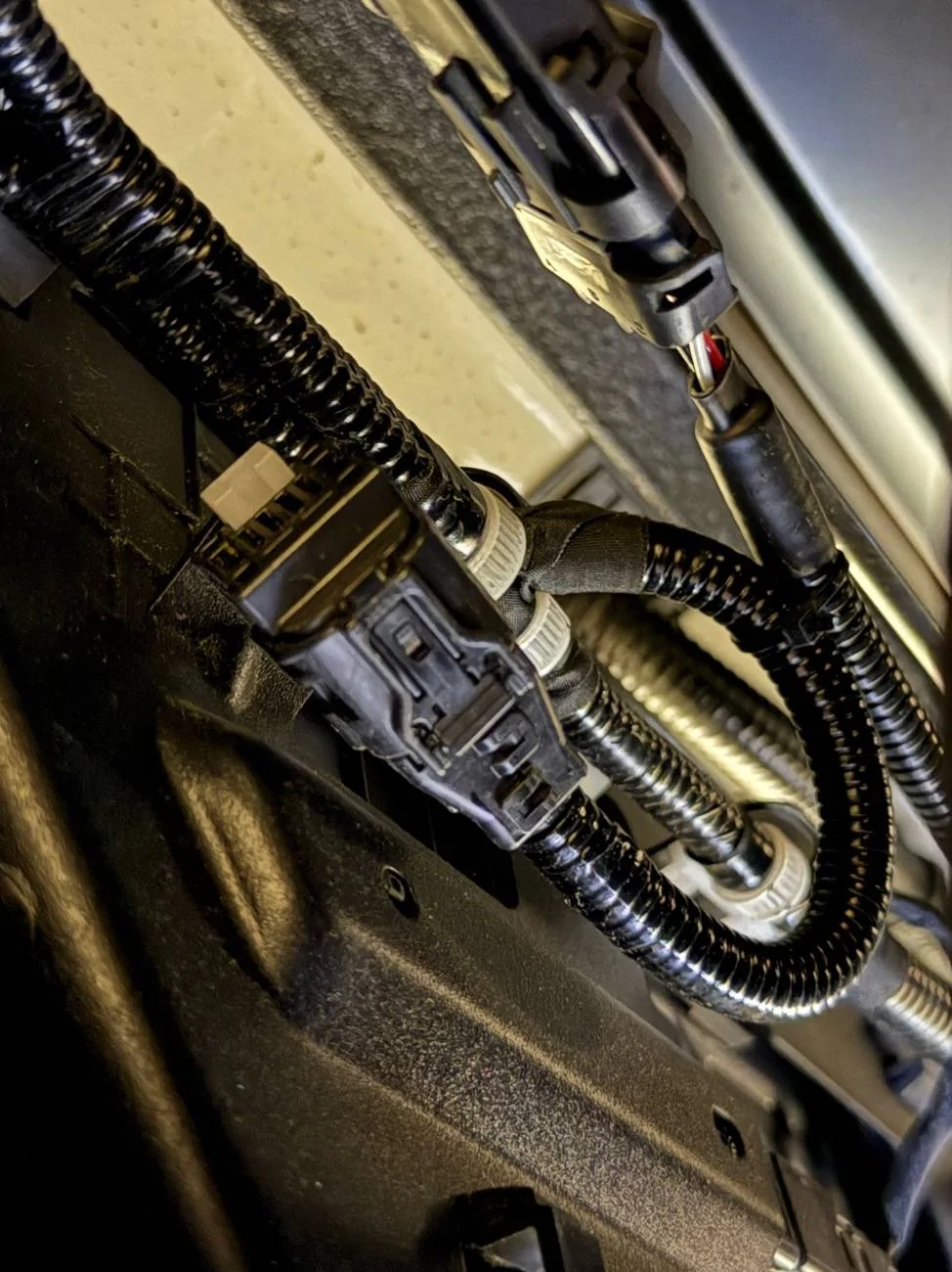

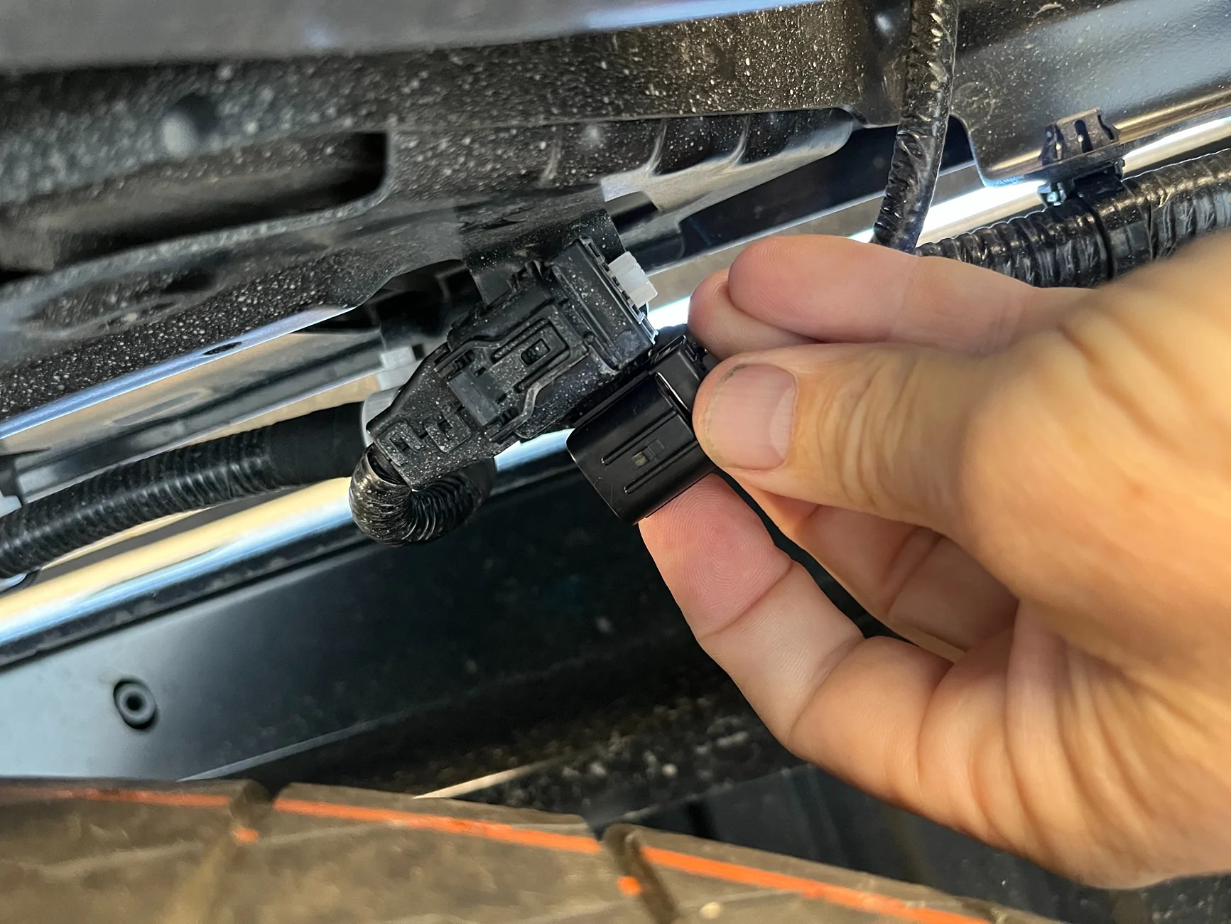

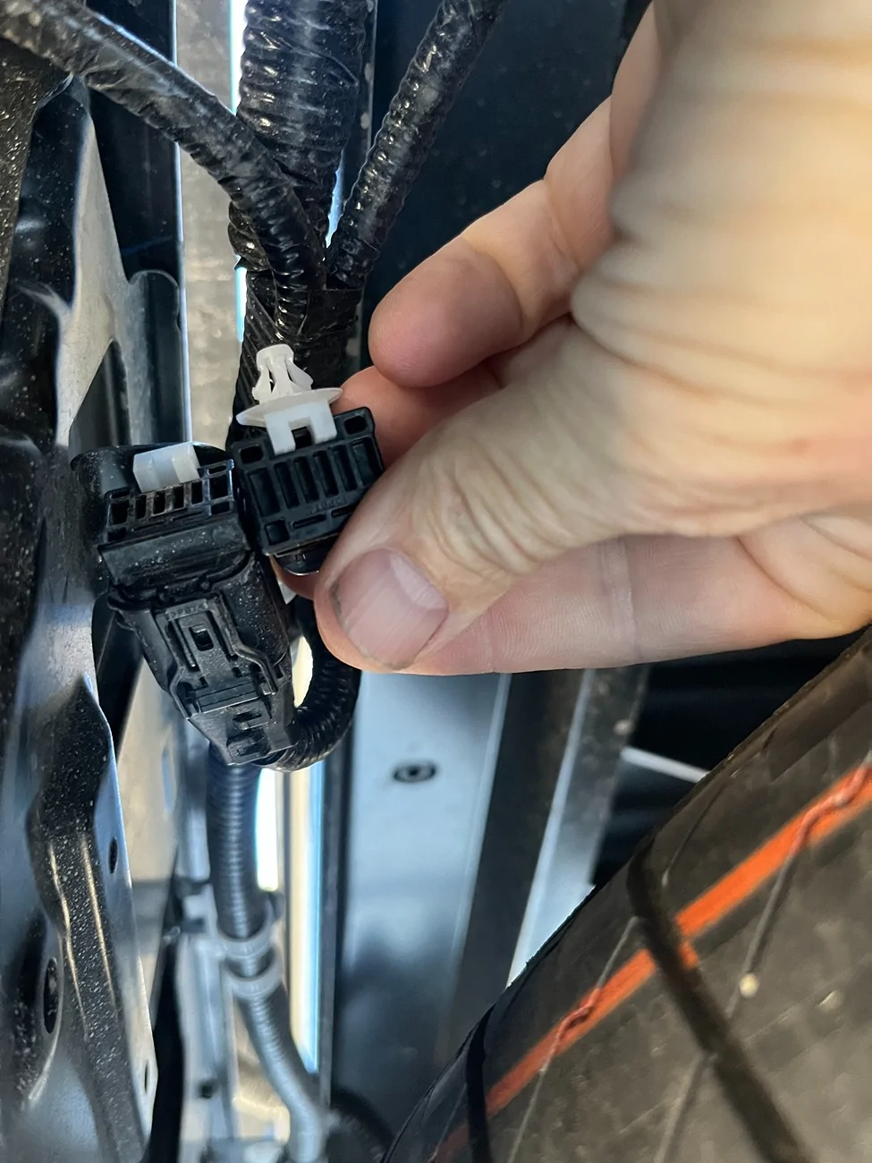

Thanks, so you are confirming you have the same unused connector. At least I didnt miss anything in my install
I wonder what it is for?
So, I had my 5k service today at my local dealer, and I walked through the showroom and they had two Tacos, an SR5 and TRD. Looking underneath the back both had this same plug, as well as my TH. I asked the tech guy what's with the plug? All the Tacos have it. Without extensive research, which he was going to do, he said it's probably something to do with towing and a camera system.

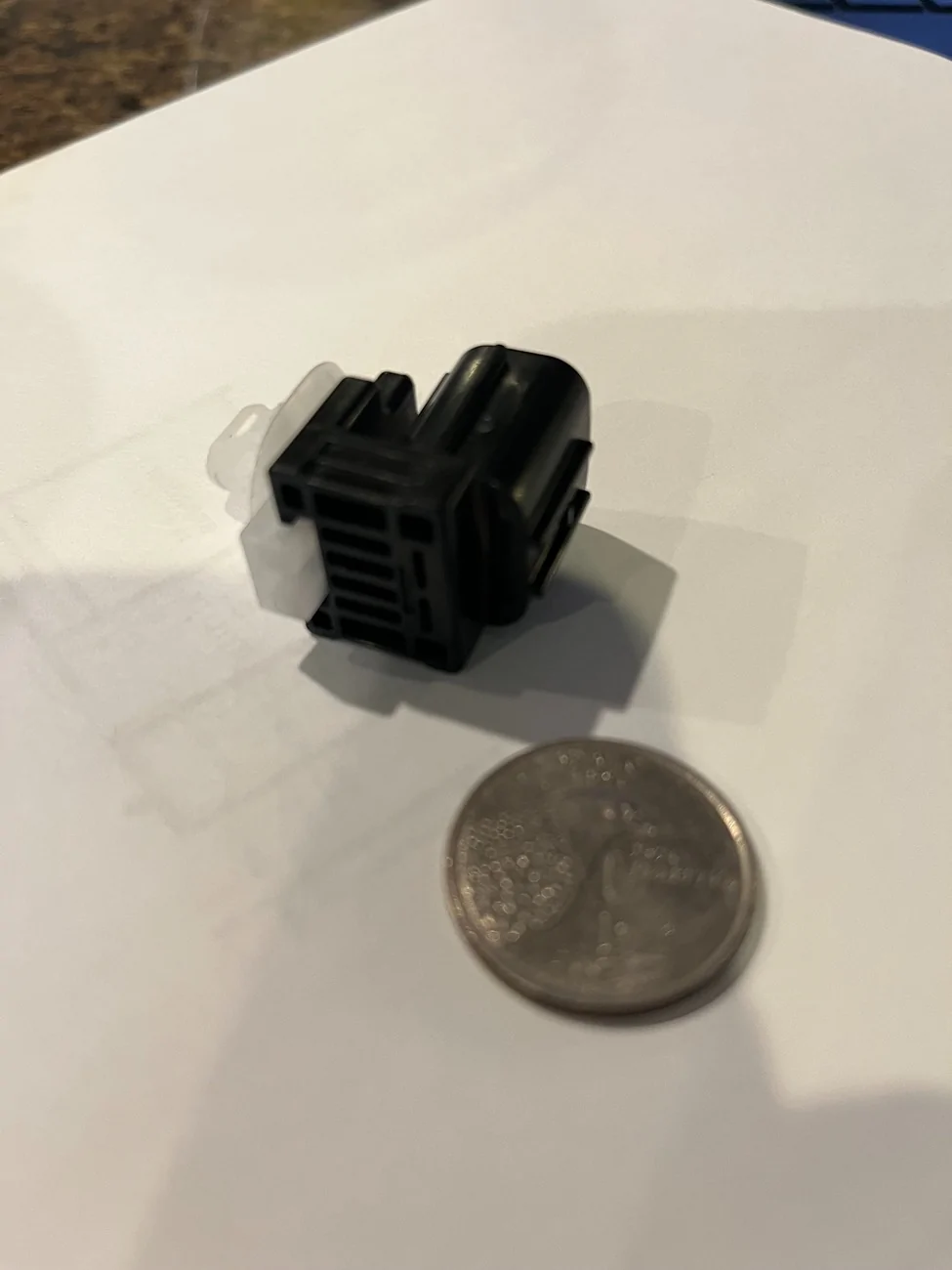

I believe that connector is a termination point for the CAN Bus (Controller Area Network). There are several other connections around the truck that are the same. The only reason I recognize that connector is that I pulled the one on the driver kick panel out when I tuned my truck. This is the terminator that I removed for my other harness, and it fits in the connection at the rear of the truck that you have in that picture.
