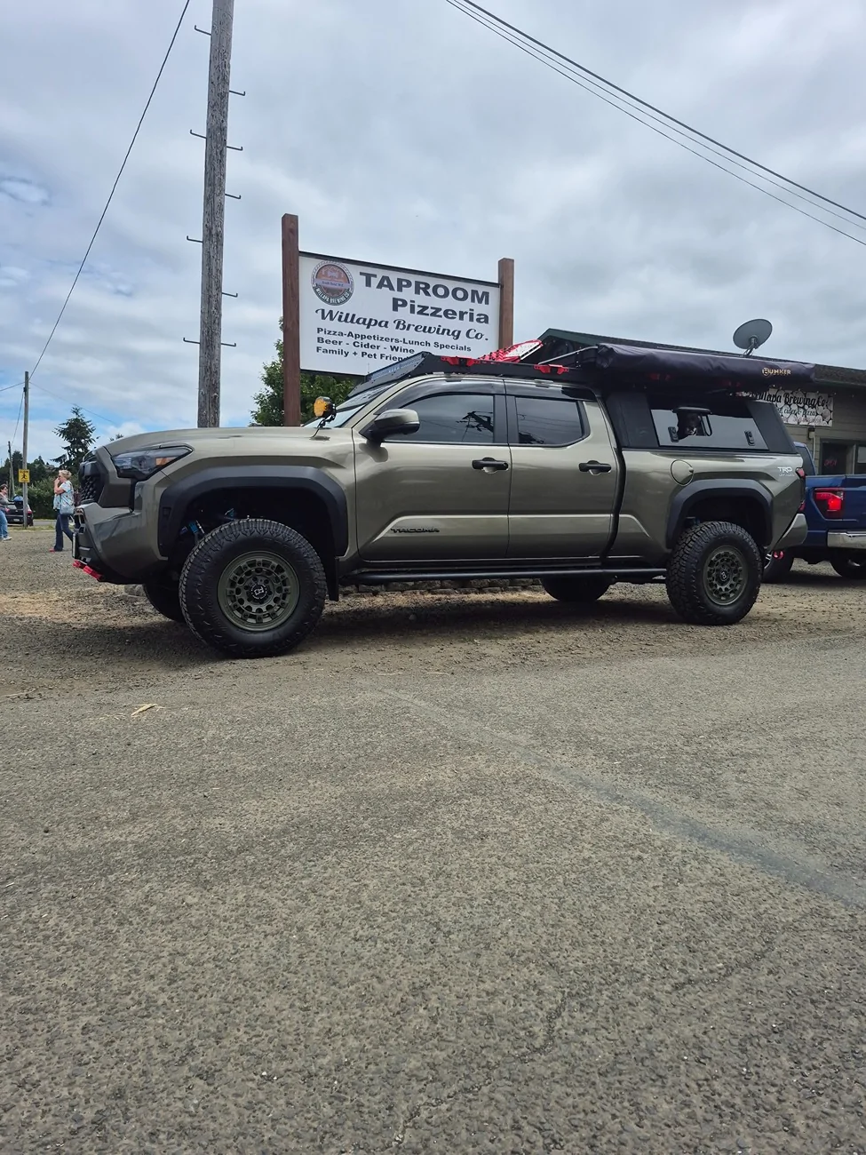

These trucks are only meant to haul bags of groceries and look good on the road..😡 after adding some mods, all the suspension would do is bottom out. So I upgraded to him, the king, this iafter adding some mods, all the suspension would do is bottom out. So I upgraded the widow with a custom king total chaos suspension with Dobson 819 rear Springs and problem solved 😉
2024 Tacoma Why won’t Toyota provide actual payload numbers? 20250727_135822
