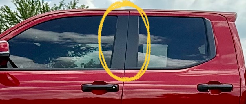

And did your rattle sound like it was coming from the front of the door or B pillar? Mine sounds like it’s coming from between the window and b pillar
Yes. Mine sounded like a little plastic piece was rattling against the area circled.

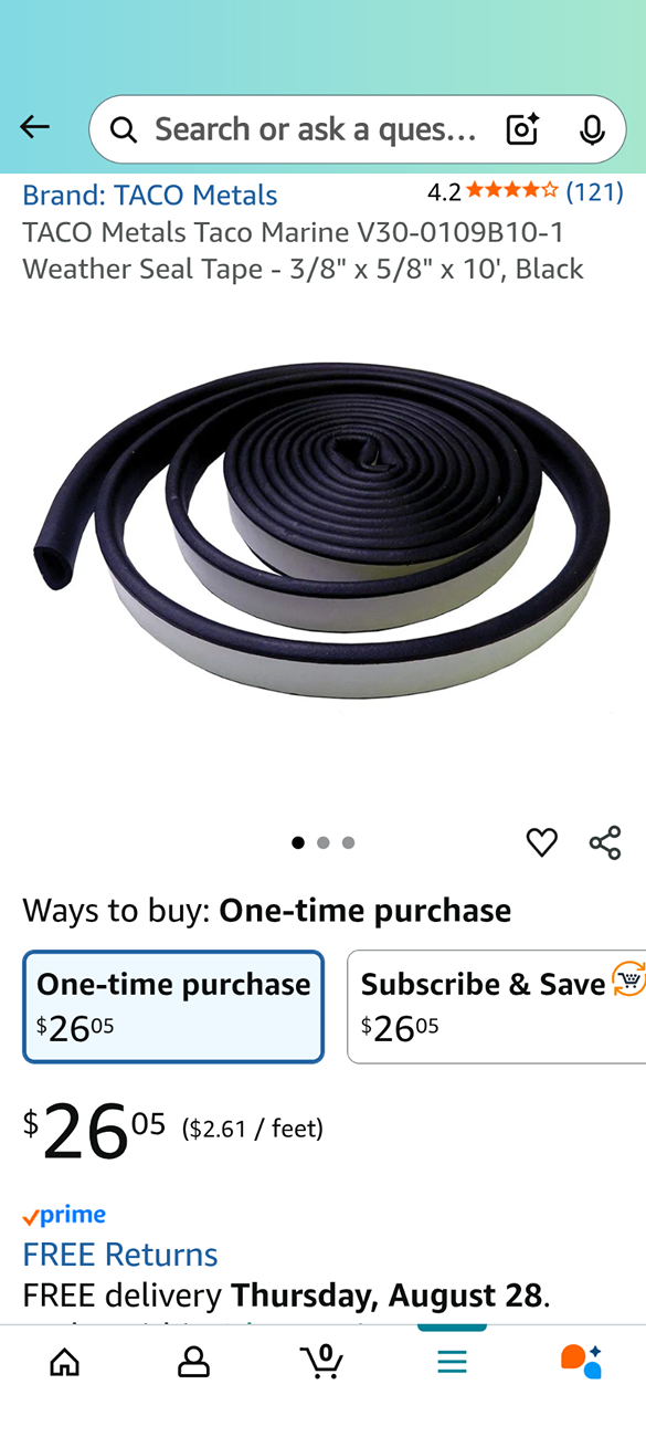

try this blub seal

Thanks for the link. I looked today, and have no idea how you would remove the piece in front of the door. Is it a 5 minute job? What else do you have to remove to get to the front of the tabs to remove them?
Or am I looking at it wrong?
