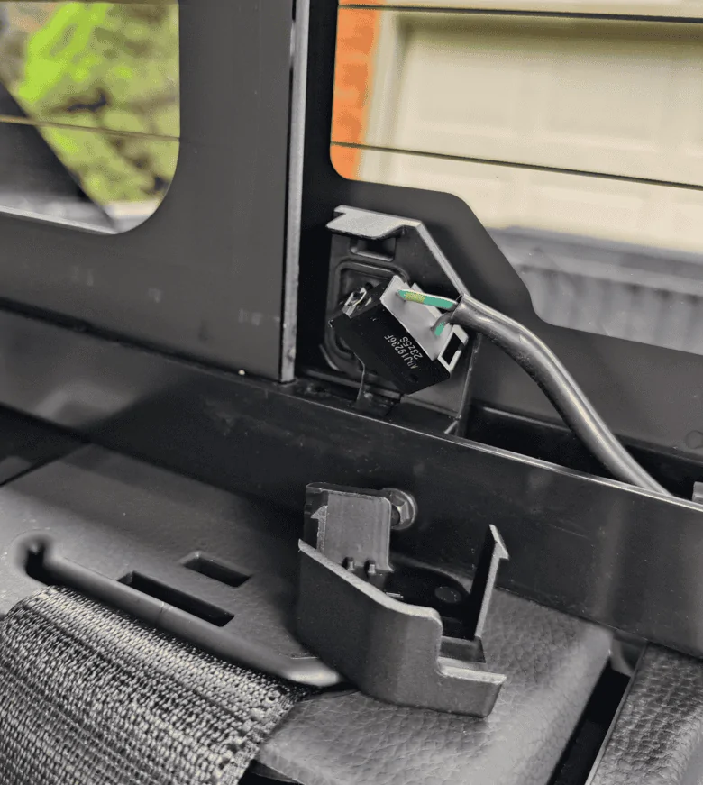

This not true. The back window does have a sensor. And mine was broken and caused this message. My local dealer refused to fix it under warranty, and tried to say that I damaged the switch. When I got it back from them, it was just hanging loose out of the little groove in front of the rear window. It's nothing more than a microswitch with a small metal tab that acts as the sensor. I have not been able to fix it yet.

Well - window was closed but found the switch jacked up. back working now, thanks for the hints. that's right where the seatbelt is, guessing that's what knocked it off. Doubt I'll be the last. worst case to just short those wires and remove the rear window status switch.
This......
I installed seat covers and accidently bumped / dislodged the switch for the rear window slider... All I had to do to fix the "window open" notification was reattach the switch and cover plate. Problem solved.
