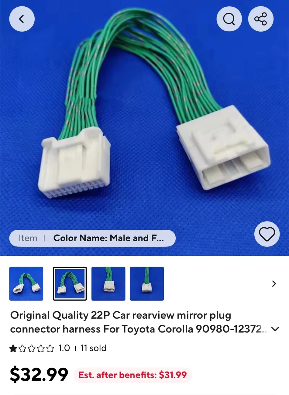

I'm still waiting on the CAN harness extension to arrive, and when it does I'll be plugging it in for a few days to make sure it runs clean, and then I'll splice in quality connectorsto attach the Wolfbox wires to the system.
....Hopefully they are actually working on an ECU update.... since we have another person with identical issues, I'm thinking it's an issue with the supplied connectors, or the CAN signal is getting noise/backfeed from the wolfbox ECU (a choke? filtering Capacitor? diode? - an optical isolator would probably be ideal)
