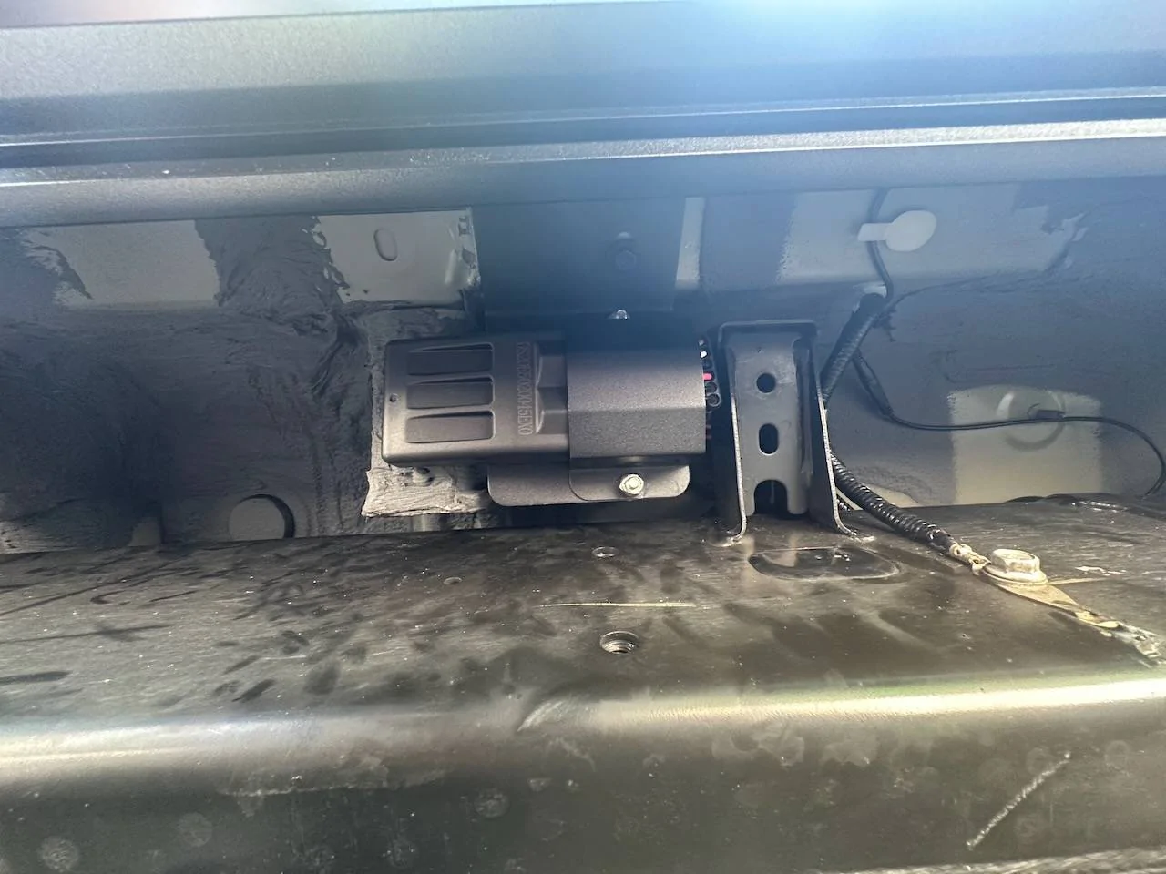

So I am using the Rough Country e -boards.
Install went fine including the oem switch mod. Followed the pinouts provided by another member that was posted to a different forum (the link I provided earlier). A good resource.
Not much drama but took much longer than I expected. Also, my first challenge was fitment of the control module under the truck. Maybe has been mentioned by others, but I called RC and they had me flip the module to the other side of the bracket (see attached). The two screws were seized to the nuts and broke requiring an unplanned trip to the hardware store for replacement fasteners. Still tucks up nicely and is protected by the frame rails. After that was mostly smooth sailing.
Cheers.
