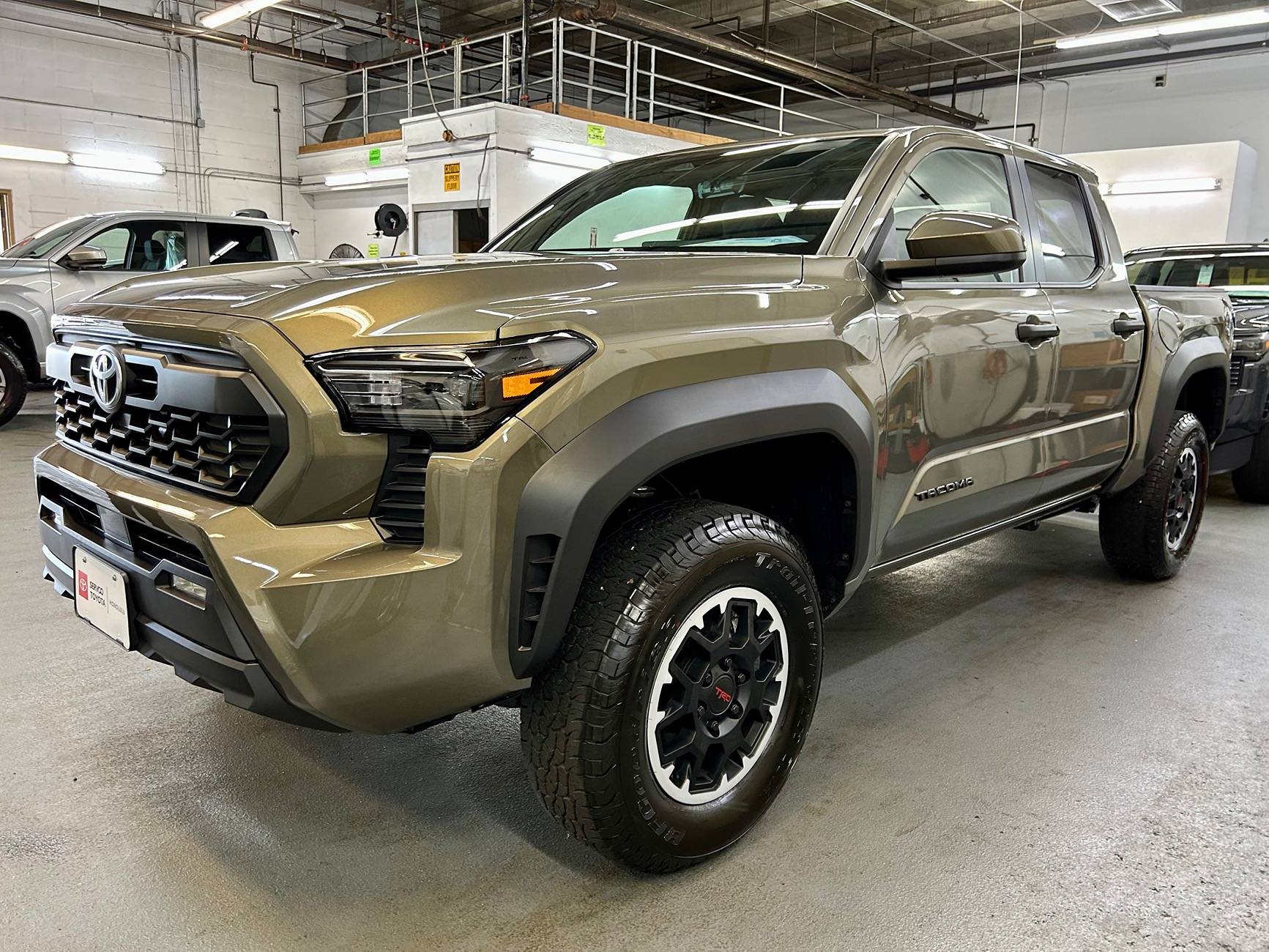

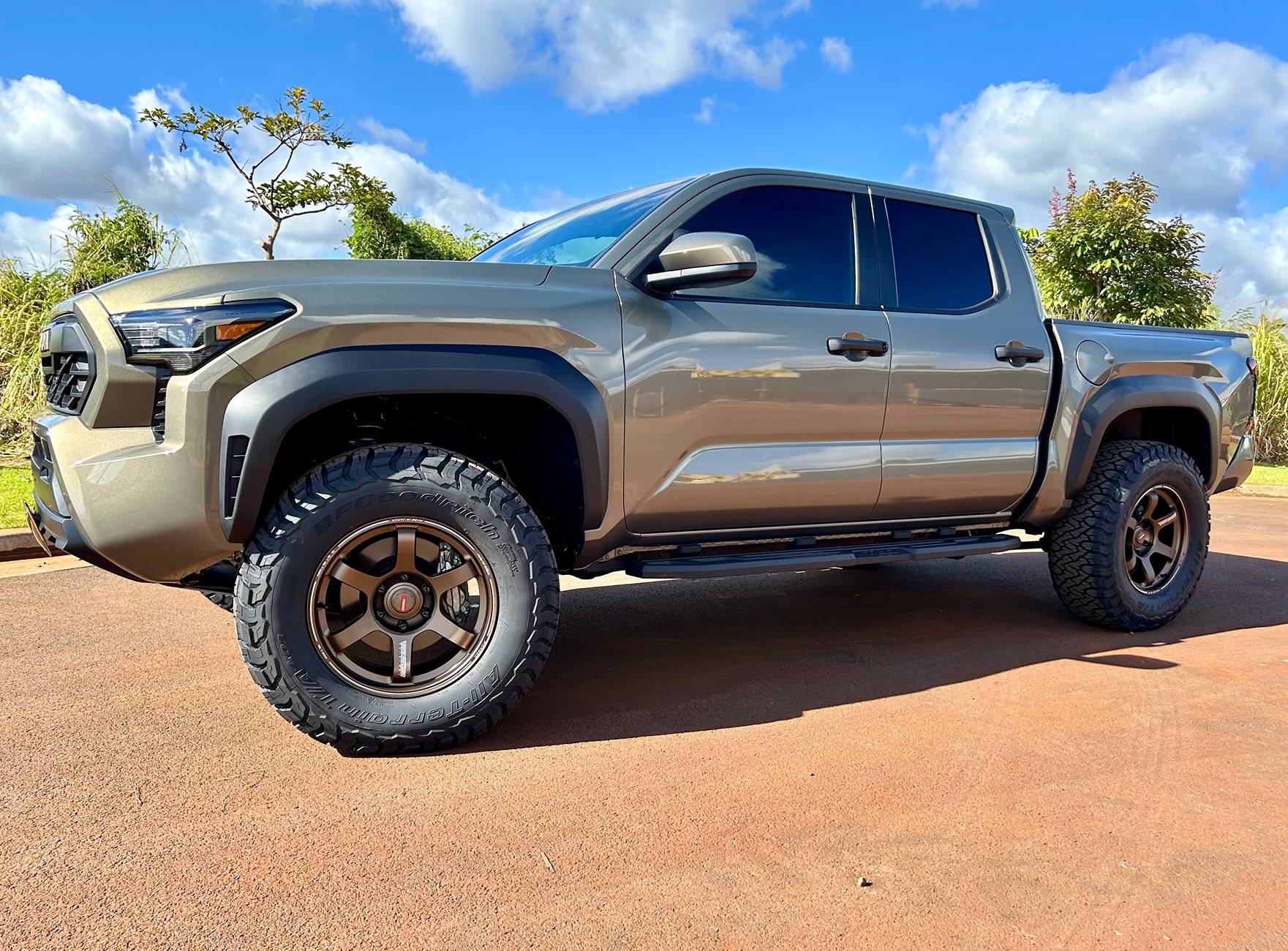

Hey folks,
I’ve been modding vehicles for about 25 years now, but haven’t been part of a forum for the last 15. Got married, had 2 kids, and my hobby got placed on the back burner. I’ve owned a couple of X-runners in the past, but other than that, just cars (‘19 STi, ‘97 NSX, ‘02 Celica, ‘95 Accord). So this is my first vehicle that I’m not lowering!
I had planned to buy a ‘24 taco from the moment I found out about the redesign. Ordered a 6mt OR back in Sept, and finally took delivery the first week of April at one of the dealerships on Oahu. I miss the community feel of a forum where people share their excitement for what they’ve purchased, as well as the sharing of knowledge and ideas, so I finally decided to join another forum (or two). I look forward to learning from you all in the coming months and years.
Mods:
18x9 +0 Volk TE37 Progressive 2
305/65/18 BFG KO3 tires
ReadyLift 1.5" spacer
OEM stuff:
Trailhunter bronze grille
TRD skid plate
TRD aluminum running boards
OEM tri-fold bed cover

Nice truck! What are the specs on your tires and wheels? Leveling kit?

Thanks! 18x9 +0 w/ 305/65 KO3s. Yup, just the Ready Lift 1.5" spacer.

Any trimming or modifications besides the lift to fit the wheels? I've been eyeing Rays/Volks but the normal fitments for 3rd gens and 17s were a no go because of the poke and difference in offsets. Thinking about gram lights now...

A few minor things were done for clearance. The back plate on the bottom inside was removed, some of the lower fender liner was folded under itself, and the bottom part of the front bumper was trimmed a little. Nothing super obvious, and the liner can be unfolded and re-bolted later if, for some reason, I ever choose to put the stocks back on. Posted a few pics so you can see.
The main issue was the 0 offset. The shop I went to had slapped 295/75/18 Baja bosses on a 4th gen that required less trimming, but the wheels were +18. Unfortunately with Rays/Volk, options are limited as you’ve stated.
