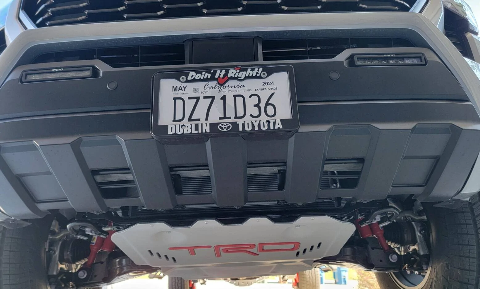

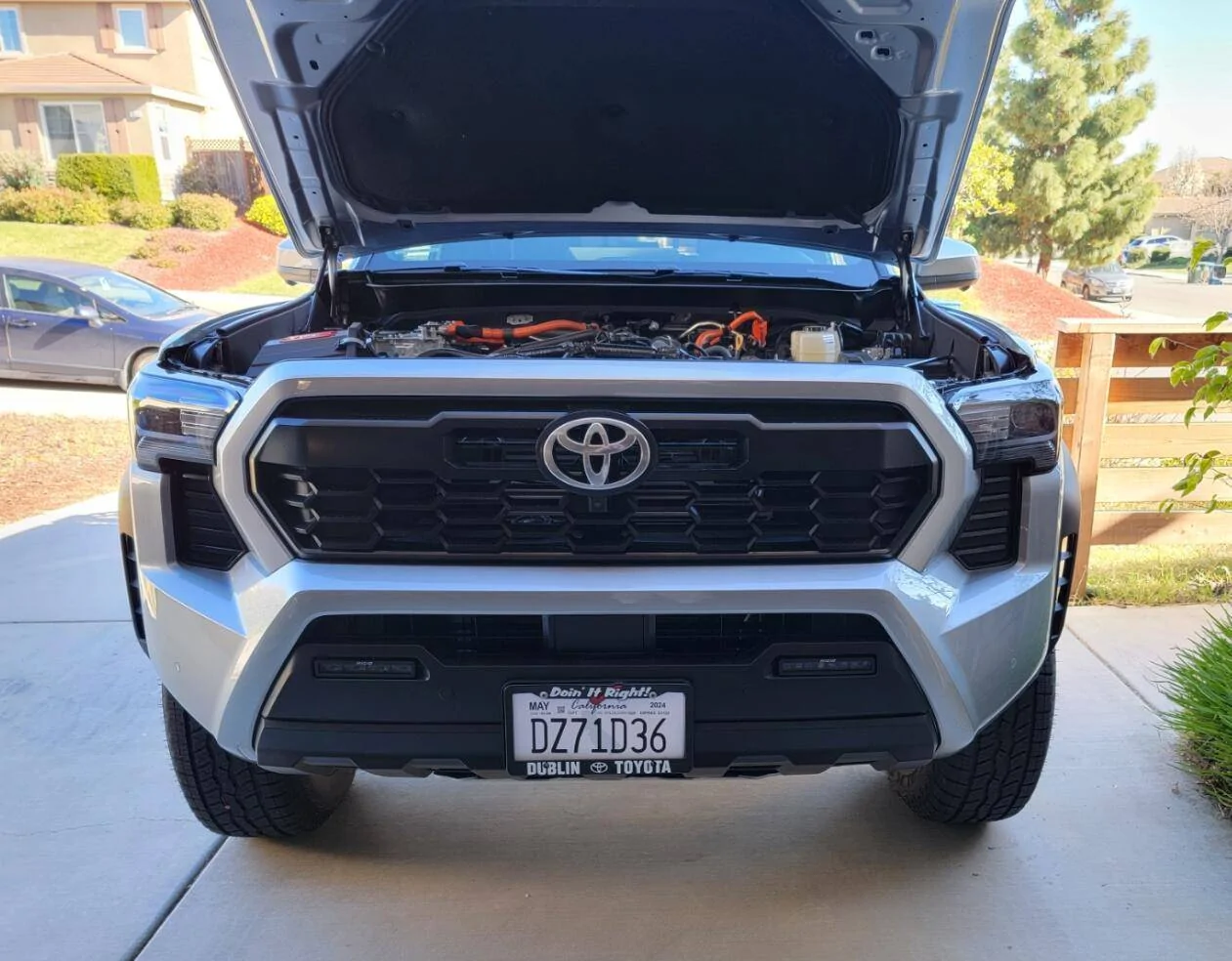

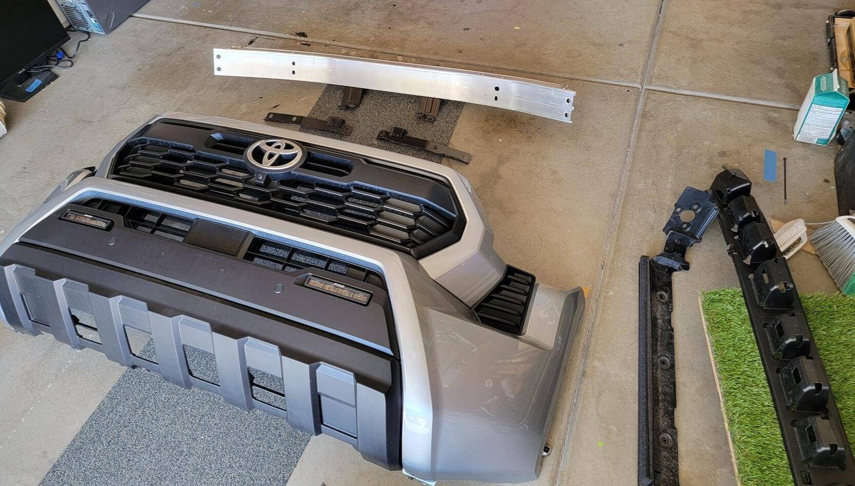

Before shots:
2024 Tacoma Rough Country Winch Mount + Badlands 12k (HF) install on a 4th Gen 2024 Tacoma Hybrid TRD Off-Road. Minimal trimming, huge PITA, but yessir! 1743359920551-gq
2024 Tacoma Rough Country Winch Mount + Badlands 12k (HF) install on a 4th Gen 2024 Tacoma Hybrid TRD Off-Road. Minimal trimming, huge PITA, but yessir! 1743360093234-9i

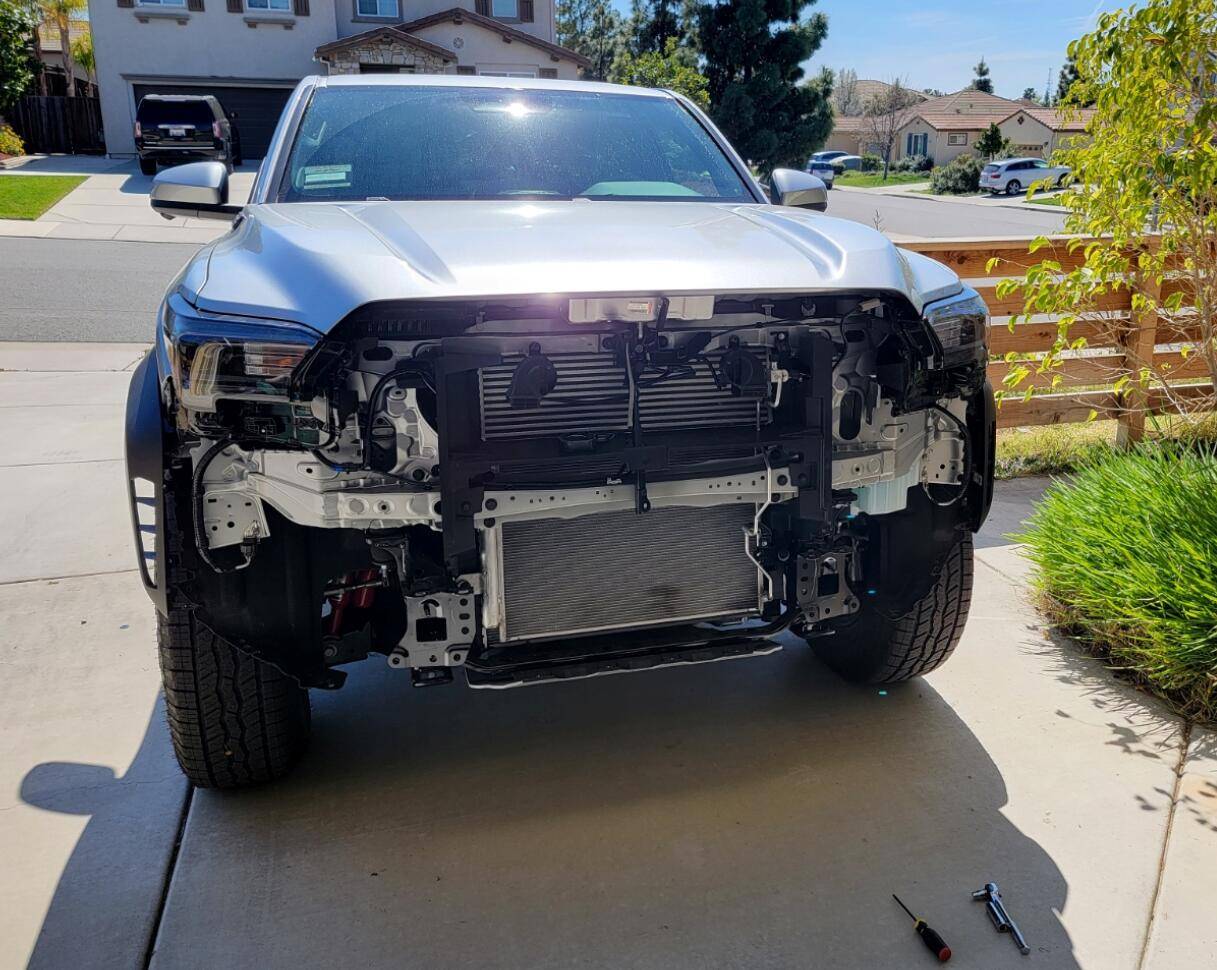

Day one was me working alone. Leonard couldn't come out till Saturday, but I took the week of PTO to line up with my son's spring break, and had all the parts by Tuesday, itching to get to work.
Got the bumper off following this guide by caliraised:
2024 Tacoma Rough Country Winch Mount + Badlands 12k (HF) install on a 4th Gen 2024 Tacoma Hybrid TRD Off-Road. Minimal trimming, huge PITA, but yessir! 1743360153097-n9
2024 Tacoma Rough Country Winch Mount + Badlands 12k (HF) install on a 4th Gen 2024 Tacoma Hybrid TRD Off-Road. Minimal trimming, huge PITA, but yessir! 1743360263282-e3

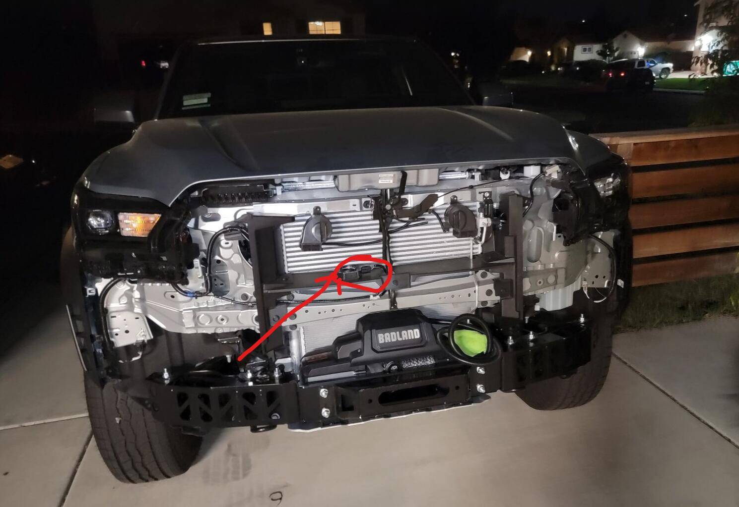

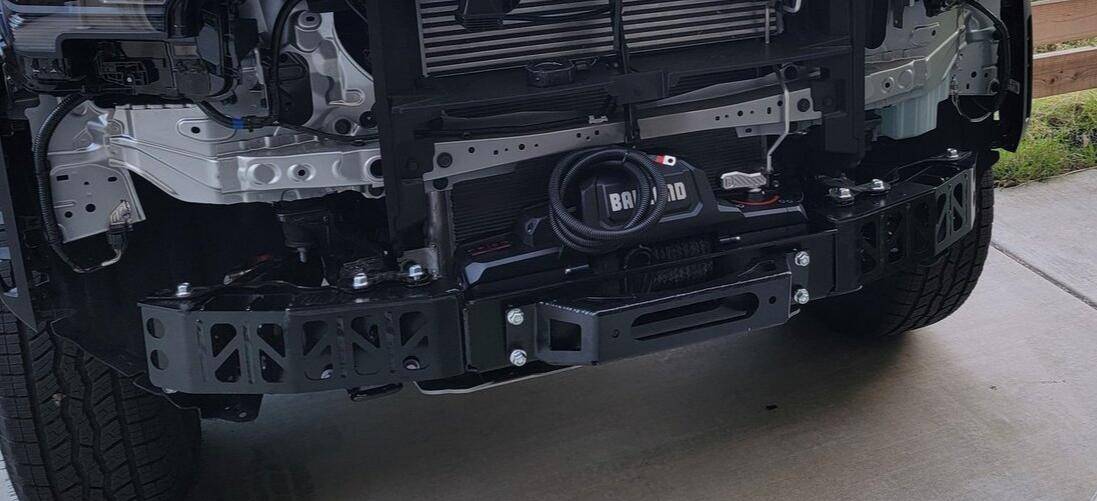

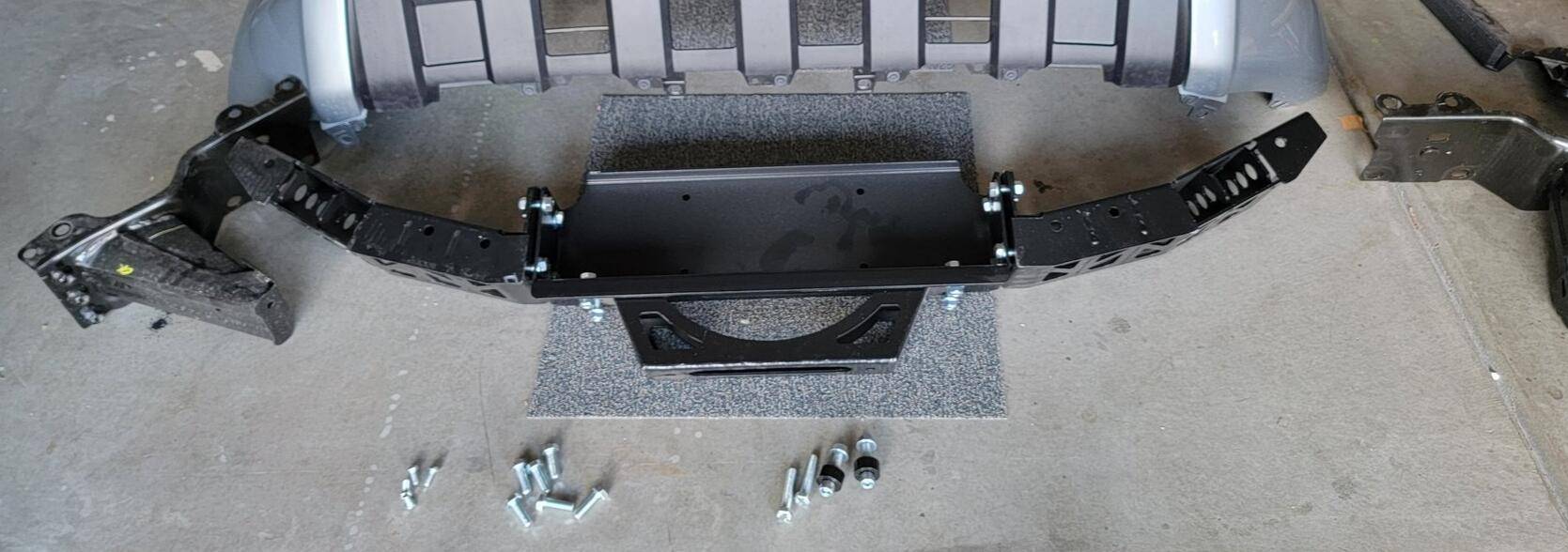

Laid out the RC bumper and finger tightened everything:
2024 Tacoma Rough Country Winch Mount + Badlands 12k (HF) install on a 4th Gen 2024 Tacoma Hybrid TRD Off-Road. Minimal trimming, huge PITA, but yessir! 1743360314936-q
They dont say to crank down yet, but be aware THESE four bolts will come back to haunt you, so I'd recommend getting them "snug" early if I could go back in time... tight enough they can still move around, but not loose to where you'll spend 15 minutes on each one just getting the bolt moved up the shaft:
2024 Tacoma Rough Country Winch Mount + Badlands 12k (HF) install on a 4th Gen 2024 Tacoma Hybrid TRD Off-Road. Minimal trimming, huge PITA, but yessir! 1743360378187-68

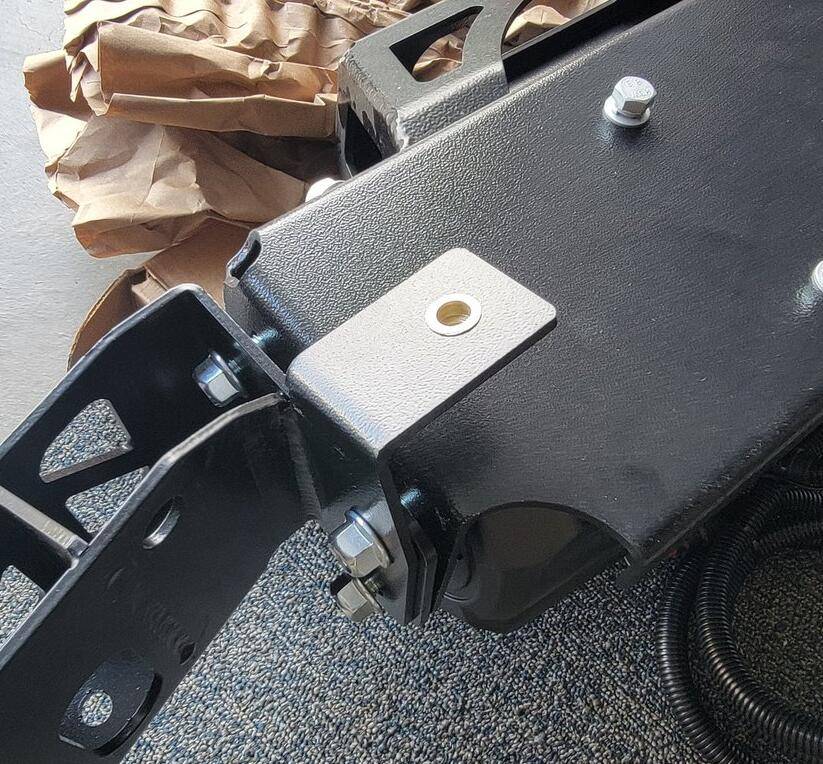

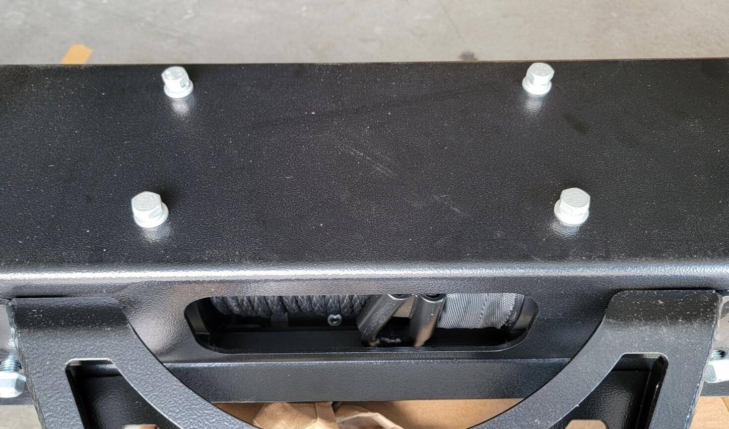

Got the little nutsert holder things in place (this comes up later):
2024 Tacoma Rough Country Winch Mount + Badlands 12k (HF) install on a 4th Gen 2024 Tacoma Hybrid TRD Off-Road. Minimal trimming, huge PITA, but yessir! 1743360536248-jk

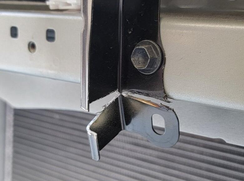

I trimmed this much of the hanging black bar:
2024 Tacoma Rough Country Winch Mount + Badlands 12k (HF) install on a 4th Gen 2024 Tacoma Hybrid TRD Off-Road. Minimal trimming, huge PITA, but yessir! 1743360856228-zx

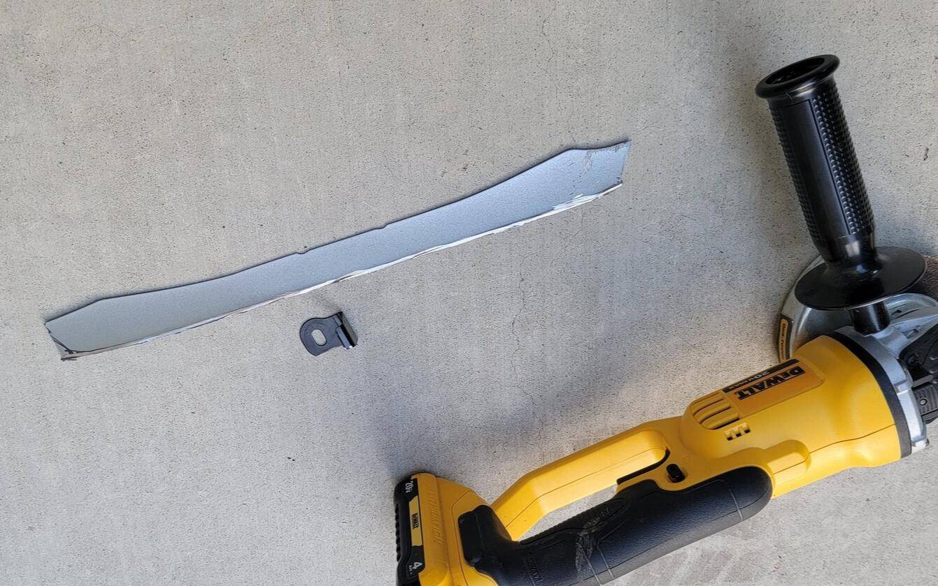

And then angled it a bit further, and sketched out the part of the silver bar I wanted to remove:
2024 Tacoma Rough Country Winch Mount + Badlands 12k (HF) install on a 4th Gen 2024 Tacoma Hybrid TRD Off-Road. Minimal trimming, huge PITA, but yessir! 1743360904851-yt
Easy:
2024 Tacoma Rough Country Winch Mount + Badlands 12k (HF) install on a 4th Gen 2024 Tacoma Hybrid TRD Off-Road. Minimal trimming, huge PITA, but yessir! 1743360929079-xq
Hit the cuts with some Rustoleum, and called my son back downstairs to try again:
2024 Tacoma Rough Country Winch Mount + Badlands 12k (HF) install on a 4th Gen 2024 Tacoma Hybrid TRD Off-Road. Minimal trimming, huge PITA, but yessir! 1743360994034-r1
Bingo:
2024 Tacoma Rough Country Winch Mount + Badlands 12k (HF) install on a 4th Gen 2024 Tacoma Hybrid TRD Off-Road. Minimal trimming, huge PITA, but yessir! 1743361023156-ka

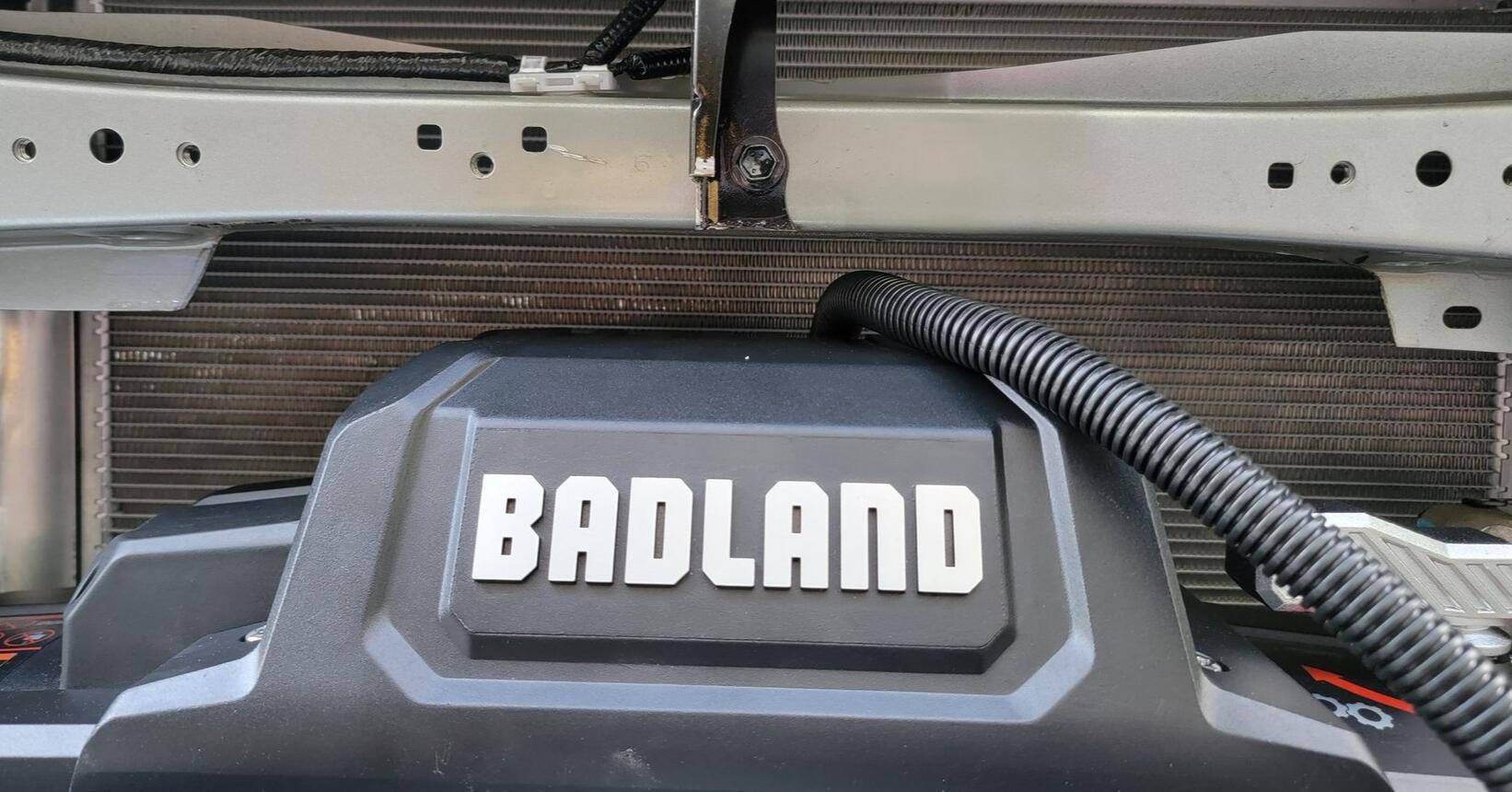

The clearances are tight, but nothing is obstructed or gets pinched:
2024 Tacoma Rough Country Winch Mount + Badlands 12k (HF) install on a 4th Gen 2024 Tacoma Hybrid TRD Off-Road. Minimal trimming, huge PITA, but yessir! 1743361077886-44
The winch JUST touches that pipe, but is not deforming it at all. With my fingers I can push against that bracket and flex the pipe away, then let go and it comes to rest again. If that bothers you, you could probably tweak that bracket to keep it off the winch, but again, it's just resting against it. Imagine putting a can of beer on a table. It's not deforming the can or table, they're just touching. That feels about the pressure required to move the pipe to slide paper between them. One 12oz beer can. That's SCIENCE, baby!

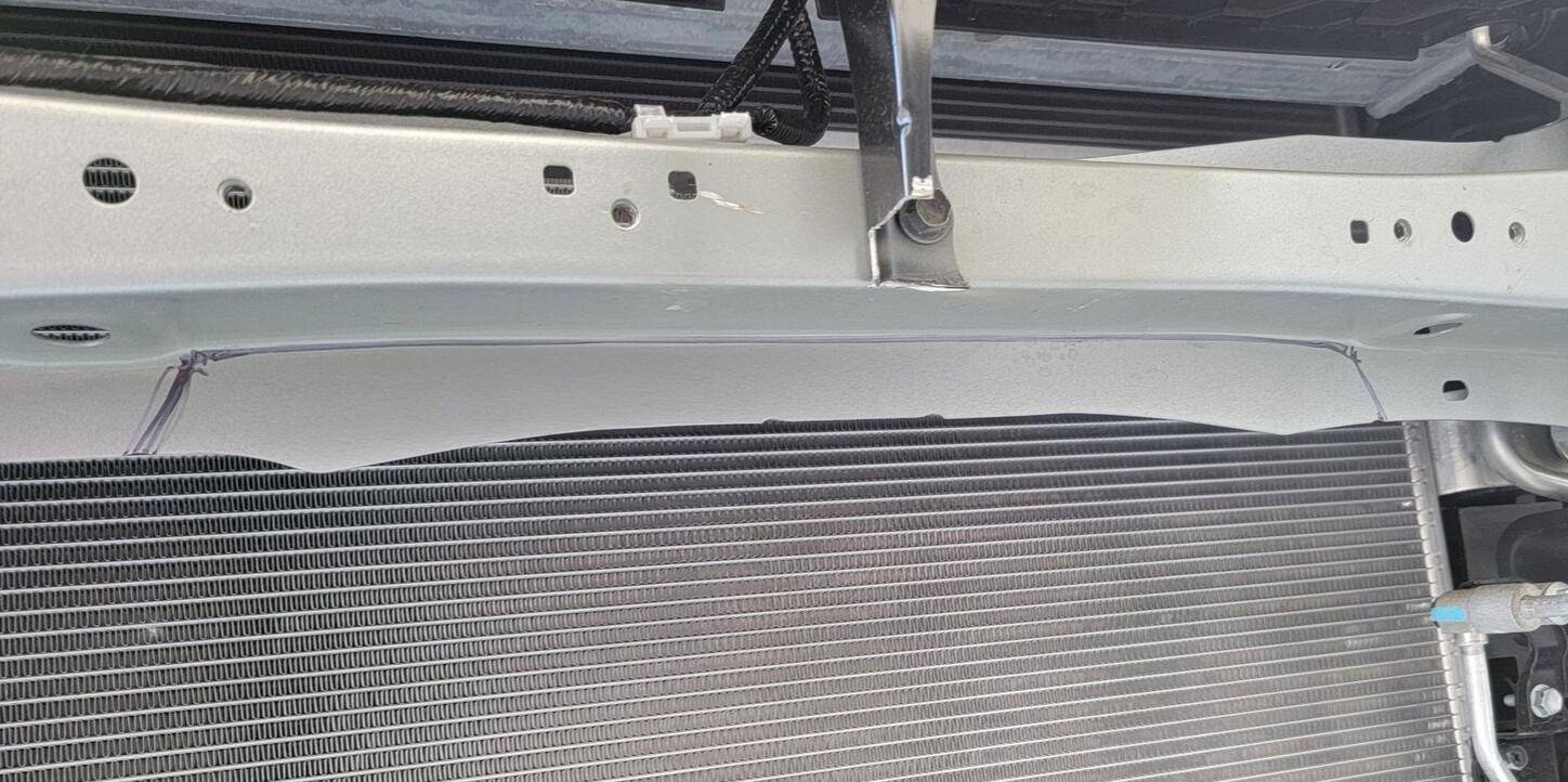

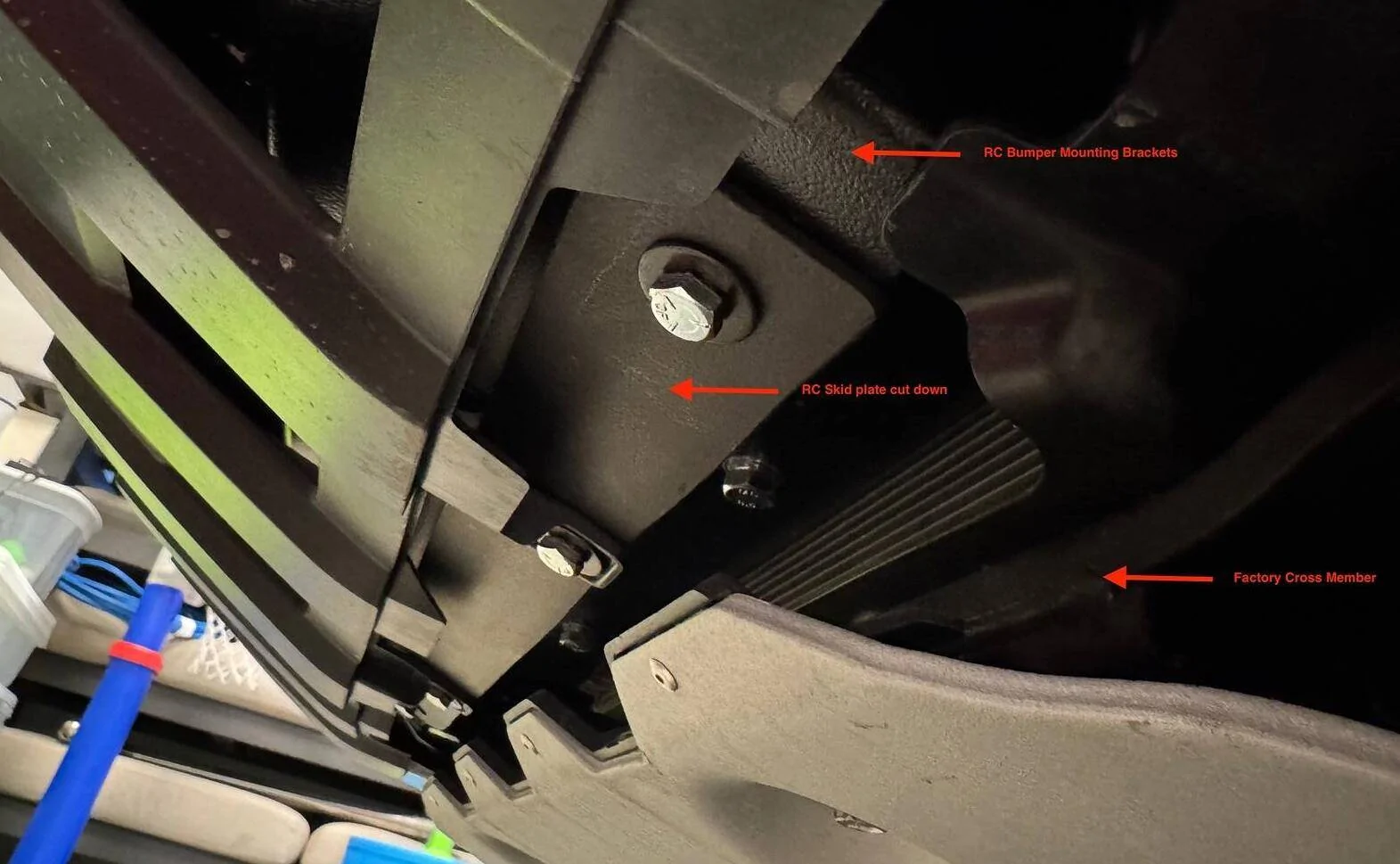

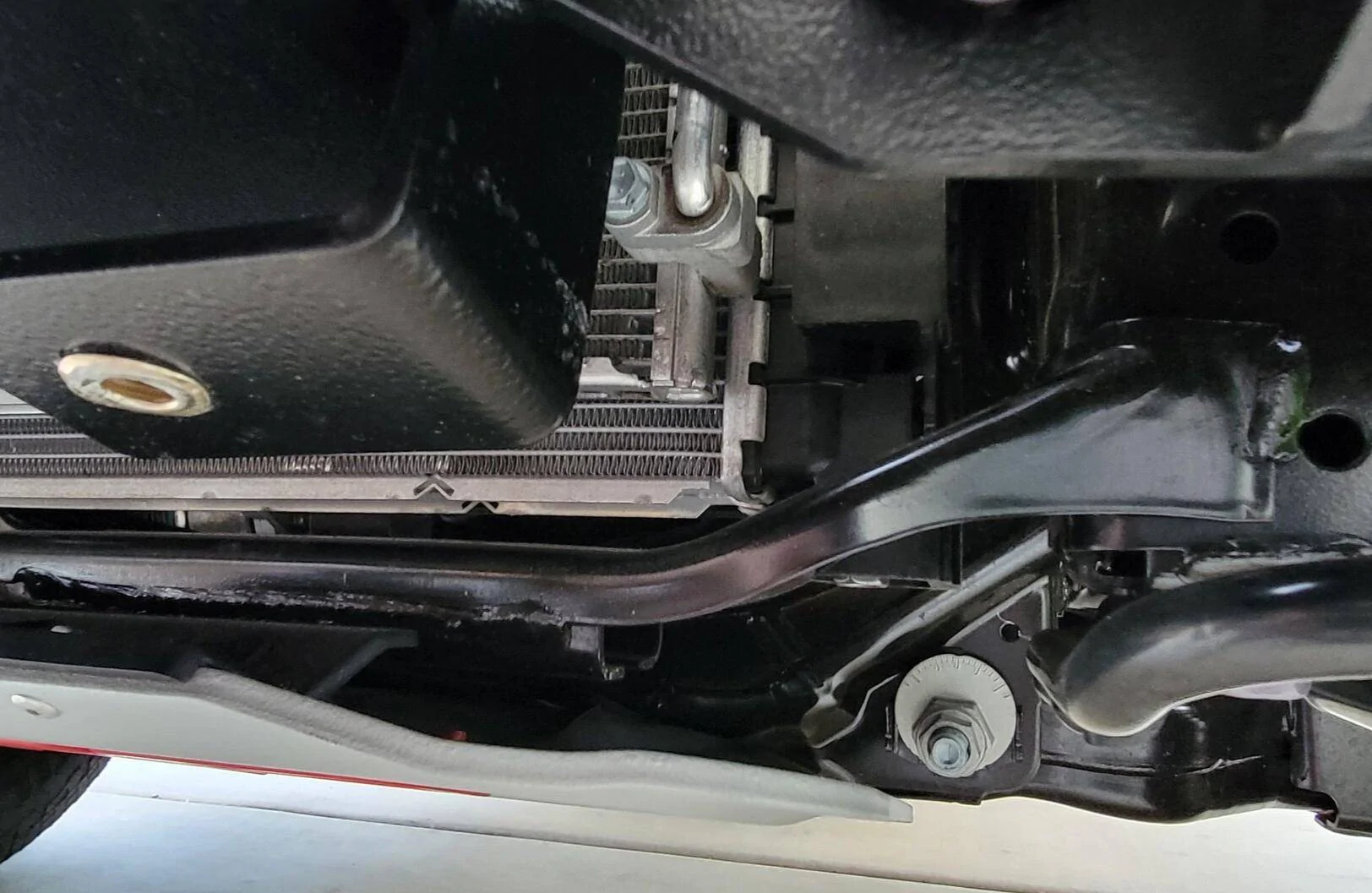

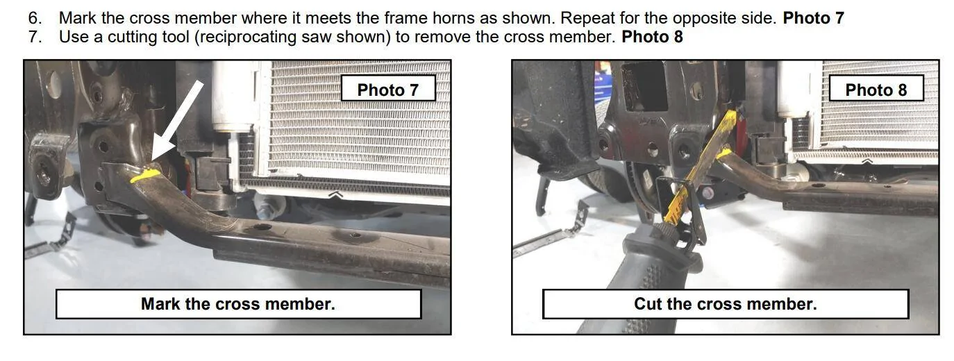

A look from below, directly at the crossbar RC wants you to cut:
2024 Tacoma Rough Country Winch Mount + Badlands 12k (HF) install on a 4th Gen 2024 Tacoma Hybrid TRD Off-Road. Minimal trimming, huge PITA, but yessir! 1743361401532-3j
HERE's their install guide, pictures 7 & 8:
2024 Tacoma Rough Country Winch Mount + Badlands 12k (HF) install on a 4th Gen 2024 Tacoma Hybrid TRD Off-Road. Minimal trimming, huge PITA, but yessir! 1743361596616-5s

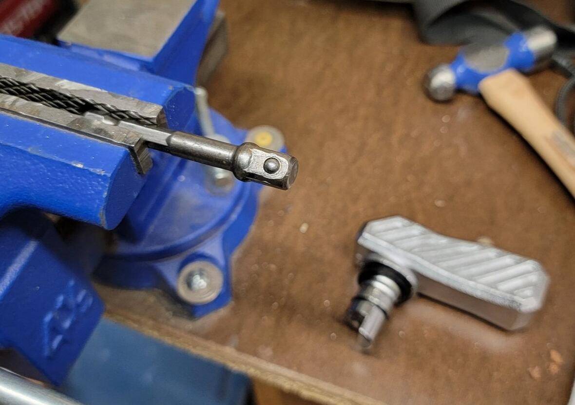

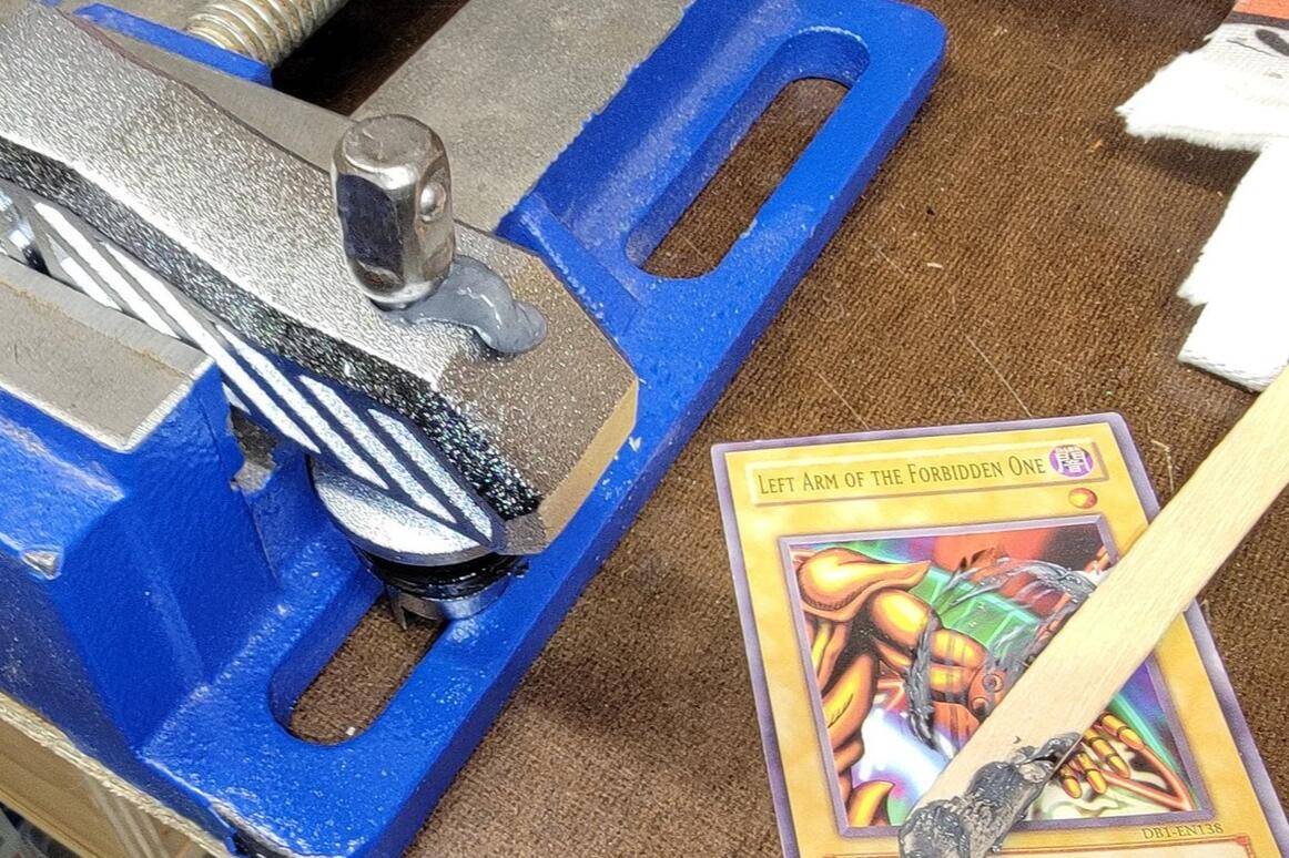

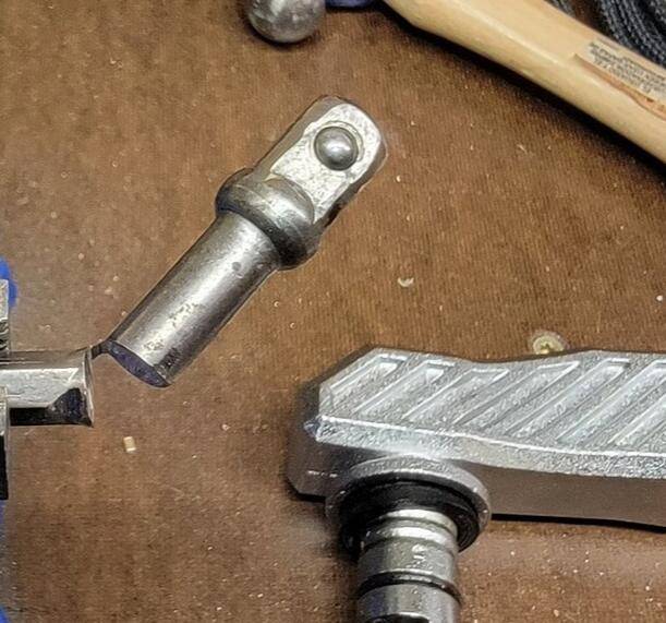

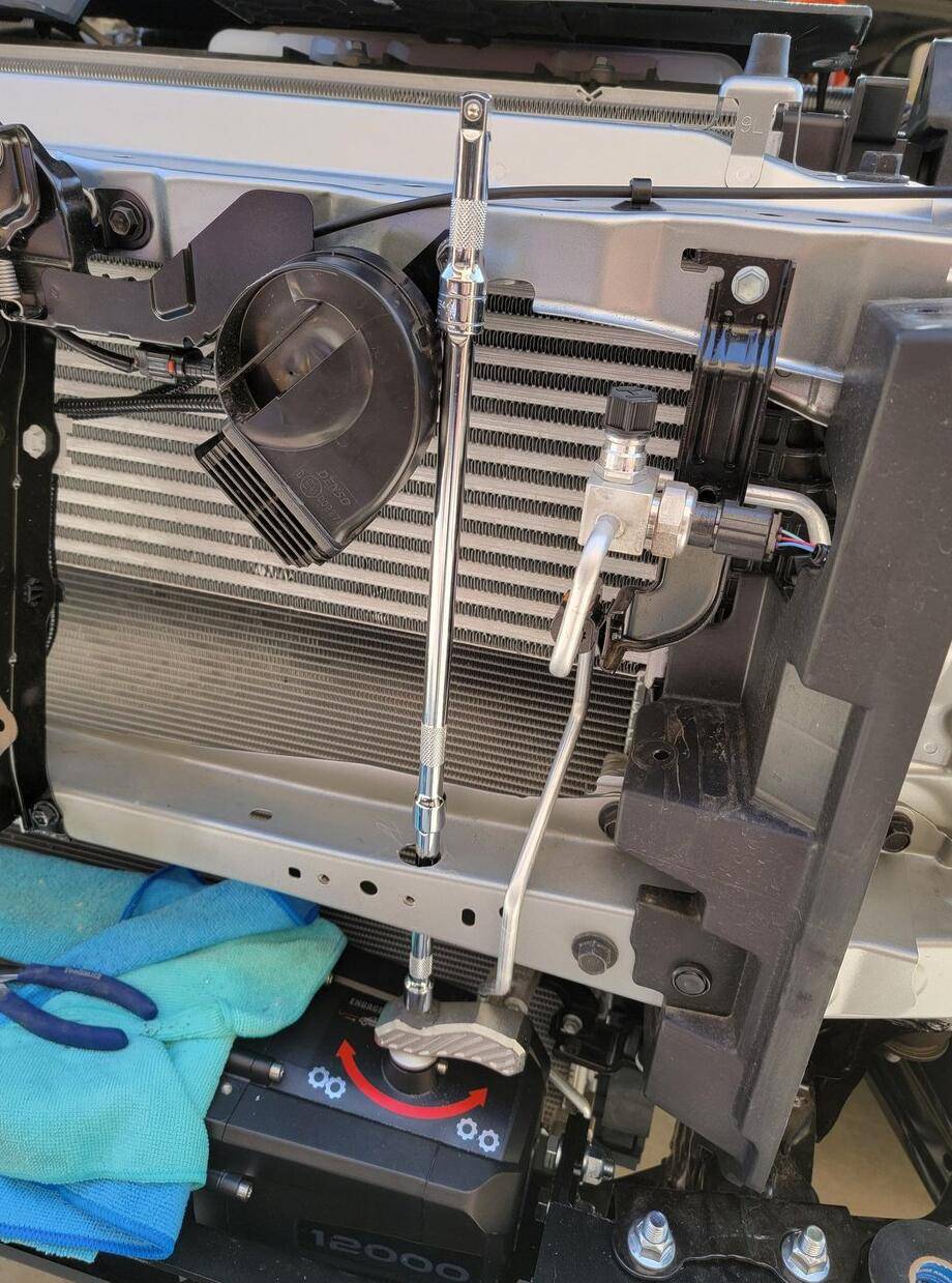

At this point I'm killing time until Saturday, so I began working on the winch extension that I've seen many do.
Again, inspired by Team Oil Drop who was the first that I saw do this, but I've seen many others since.
Taking off the handle from the winch, and affixing a way to get a ratchet linkage to "move" the clutch handle:
2024 Tacoma Rough Country Winch Mount + Badlands 12k (HF) install on a 4th Gen 2024 Tacoma Hybrid TRD Off-Road. Minimal trimming, huge PITA, but yessir! 1743361857203-qh
2024 Tacoma Rough Country Winch Mount + Badlands 12k (HF) install on a 4th Gen 2024 Tacoma Hybrid TRD Off-Road. Minimal trimming, huge PITA, but yessir! 1743361874686-93
2024 Tacoma Rough Country Winch Mount + Badlands 12k (HF) install on a 4th Gen 2024 Tacoma Hybrid TRD Off-Road. Minimal trimming, huge PITA, but yessir! 1743361893981-w9
2024 Tacoma Rough Country Winch Mount + Badlands 12k (HF) install on a 4th Gen 2024 Tacoma Hybrid TRD Off-Road. Minimal trimming, huge PITA, but yessir! 1743361911289-q7
2024 Tacoma Rough Country Winch Mount + Badlands 12k (HF) install on a 4th Gen 2024 Tacoma Hybrid TRD Off-Road. Minimal trimming, huge PITA, but yessir! 1743361966724-fi
(Exodia doesn't mind, we're pals)

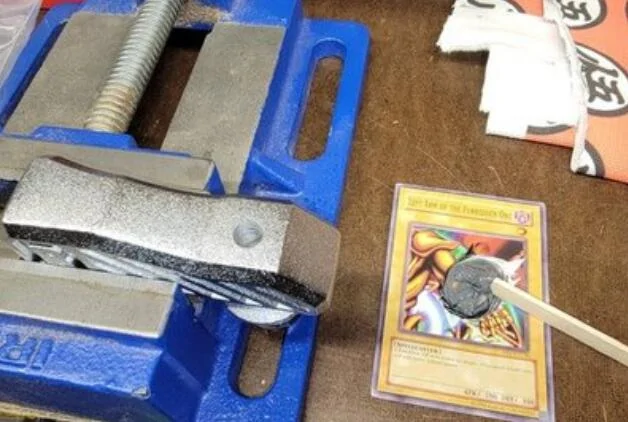

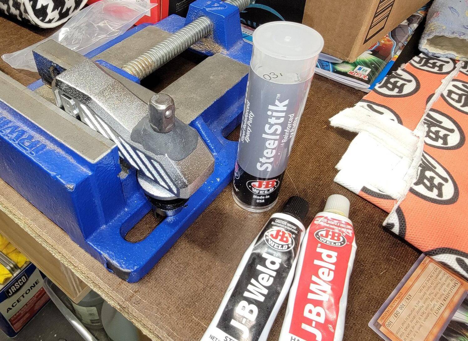

Had to cut a channel in the shaft for the goop (JB Weld) to escape, and scuffed up the shaft for better grip to the JB Weld:
2024 Tacoma Rough Country Winch Mount + Badlands 12k (HF) install on a 4th Gen 2024 Tacoma Hybrid TRD Off-Road. Minimal trimming, huge PITA, but yessir! 1743362012605-30
2024 Tacoma Rough Country Winch Mount + Badlands 12k (HF) install on a 4th Gen 2024 Tacoma Hybrid TRD Off-Road. Minimal trimming, huge PITA, but yessir! 1743362052626-g4
wiped up the goop, and applied some SteelStik around the edge for good measure:
2024 Tacoma Rough Country Winch Mount + Badlands 12k (HF) install on a 4th Gen 2024 Tacoma Hybrid TRD Off-Road. Minimal trimming, huge PITA, but yessir! 1743362115853-07

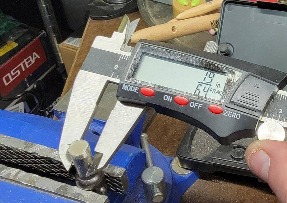

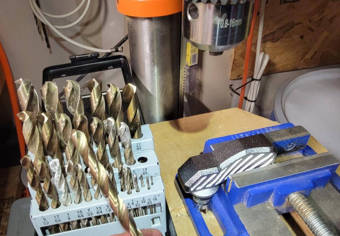

My clutch assembly ended up not needing any universal joints to flex and bypass trim. It just went straight up from the clutch handle itself, which makes it VERY easy to turn. Most people put two universal joints in there to move around trim, but I just plowed through it directly, moving my horn a bit to the side:
2024 Tacoma Rough Country Winch Mount + Badlands 12k (HF) install on a 4th Gen 2024 Tacoma Hybrid TRD Off-Road. Minimal trimming, huge PITA, but yessir! 1743362662572-i7
There are two other pieces of plastic "on the way up" but a 1/2 inch drill bit is the correct size to allow these extension bars through, and that's not rocket science.
Final look:
2024 Tacoma Rough Country Winch Mount + Badlands 12k (HF) install on a 4th Gen 2024 Tacoma Hybrid TRD Off-Road. Minimal trimming, huge PITA, but yessir! 1743368943804-j1
I need to fabricate a handle to actually "turn" the clutch, but a little 3/8 wrench fits perfectly on that square, so I'll probably sacrifice one for the task. TBD.

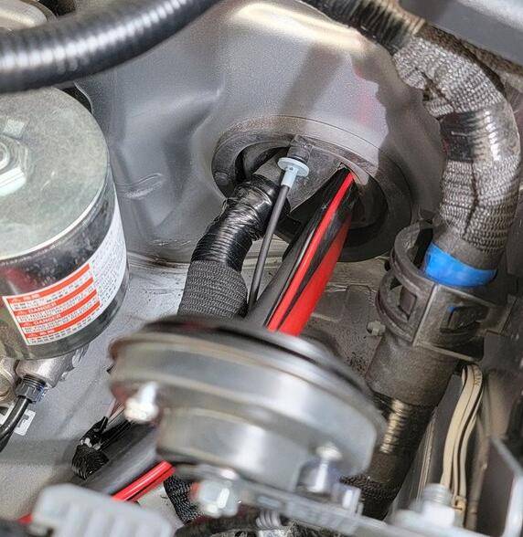

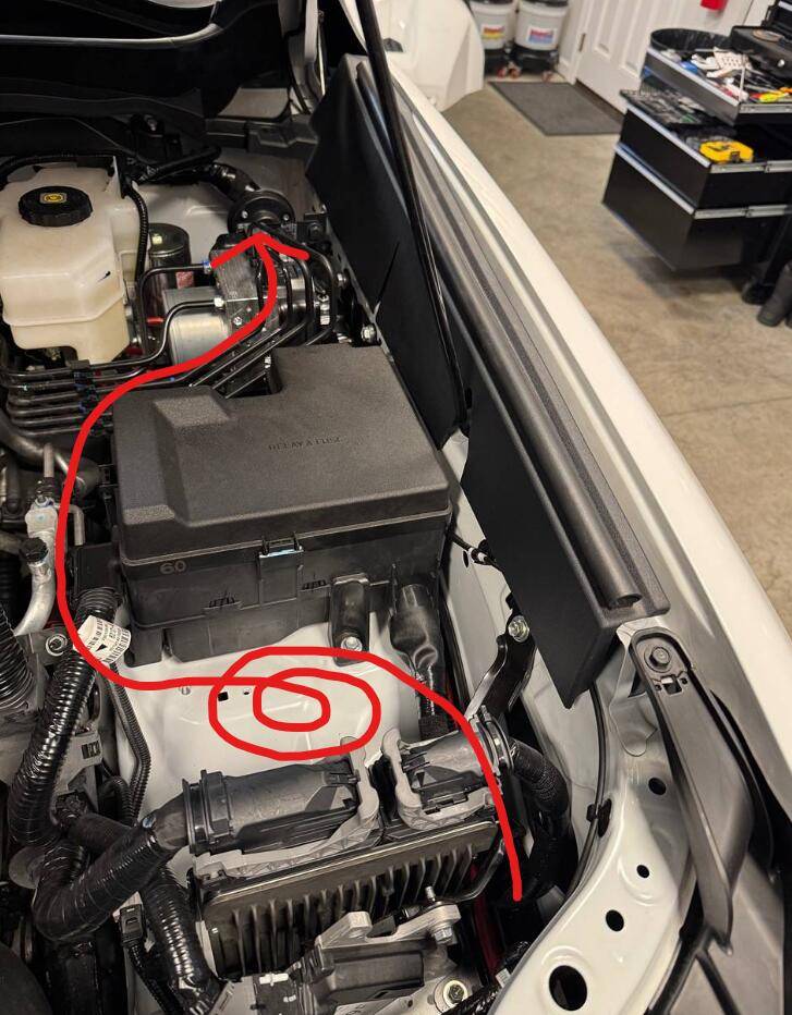

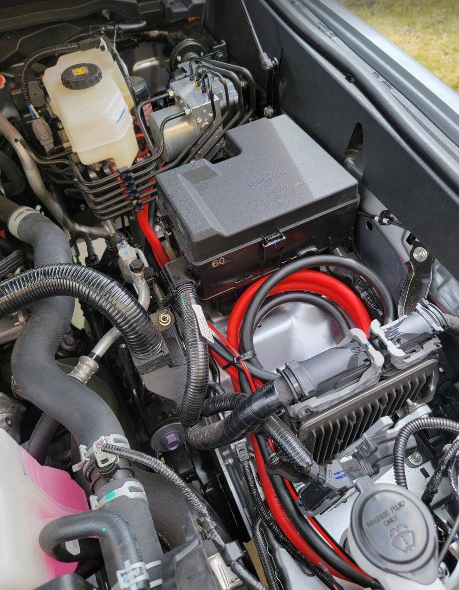

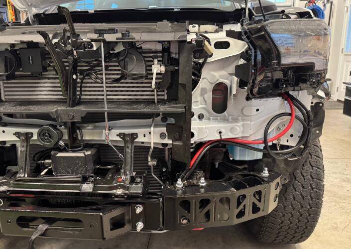

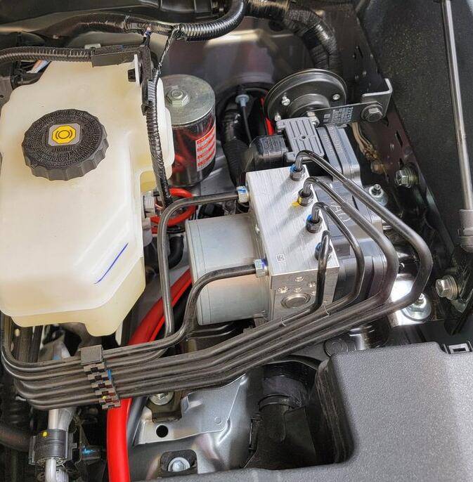

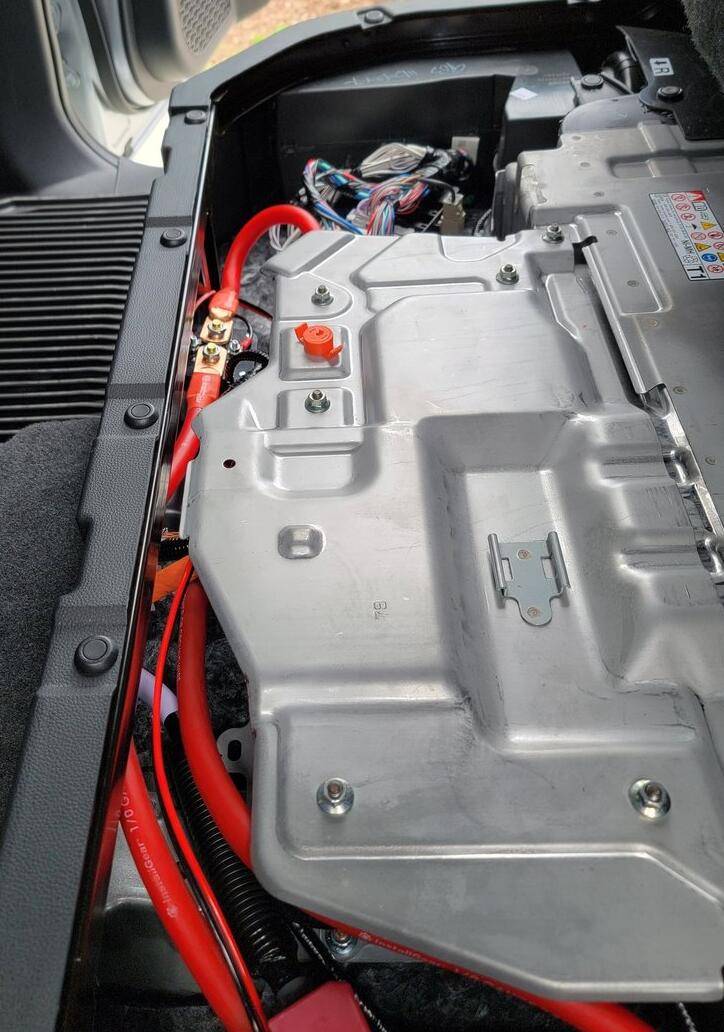

For the wiring, we used full 1/0 wire, which was the biggest challenge. I've seen others get away with 2 gauge, but we went full hog. "If it's a job worth doing it's worth doing right" / "good enough usually isn't". The best I can do is show the route we took and pop a few panels back to show to end result, but we weren;t taking photos all day, we were busting our ass in the sun.
I followed the same routing as @jettaway did, but using chonkier wires:
2024 Tacoma Rough Country Winch Mount + Badlands 12k (HF) install on a 4th Gen 2024 Tacoma Hybrid TRD Off-Road. Minimal trimming, huge PITA, but yessir! 1743363127740-l

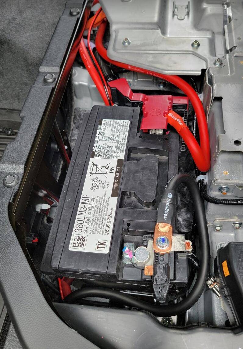

Removing the stock wires from the Badlands also was helped by the extra clearance created by my trimming. If I did not do this proactive trimming, I'm not sure I would have been able to get the control box off and remove the default positive lead. Also, taking the control box off allowed easier access to the negative terminal on the back. We continued to follow Jettaway's routing in the engine compartment, again just with larger wires:
2024 Tacoma Rough Country Winch Mount + Badlands 12k (HF) install on a 4th Gen 2024 Tacoma Hybrid TRD Off-Road. Minimal trimming, huge PITA, but yessir! 1743363328388-qy
I left a few coils of this wire for a later project. I intend to put a distribution block in this empty space so I have a true run back (with 1/0 gauge) to the actual battery terminals, since the hybrid battery is under the rear seat.
2024 Tacoma Rough Country Winch Mount + Badlands 12k (HF) install on a 4th Gen 2024 Tacoma Hybrid TRD Off-Road. Minimal trimming, huge PITA, but yessir! 1743364027084-so
to the firewall:
2024 Tacoma Rough Country Winch Mount + Badlands 12k (HF) install on a 4th Gen 2024 Tacoma Hybrid TRD Off-Road. Minimal trimming, huge PITA, but yessir! 1743364048733-70
2024 Tacoma Rough Country Winch Mount + Badlands 12k (HF) install on a 4th Gen 2024 Tacoma Hybrid TRD Off-Road. Minimal trimming, huge PITA, but yessir! 1743364064637-si

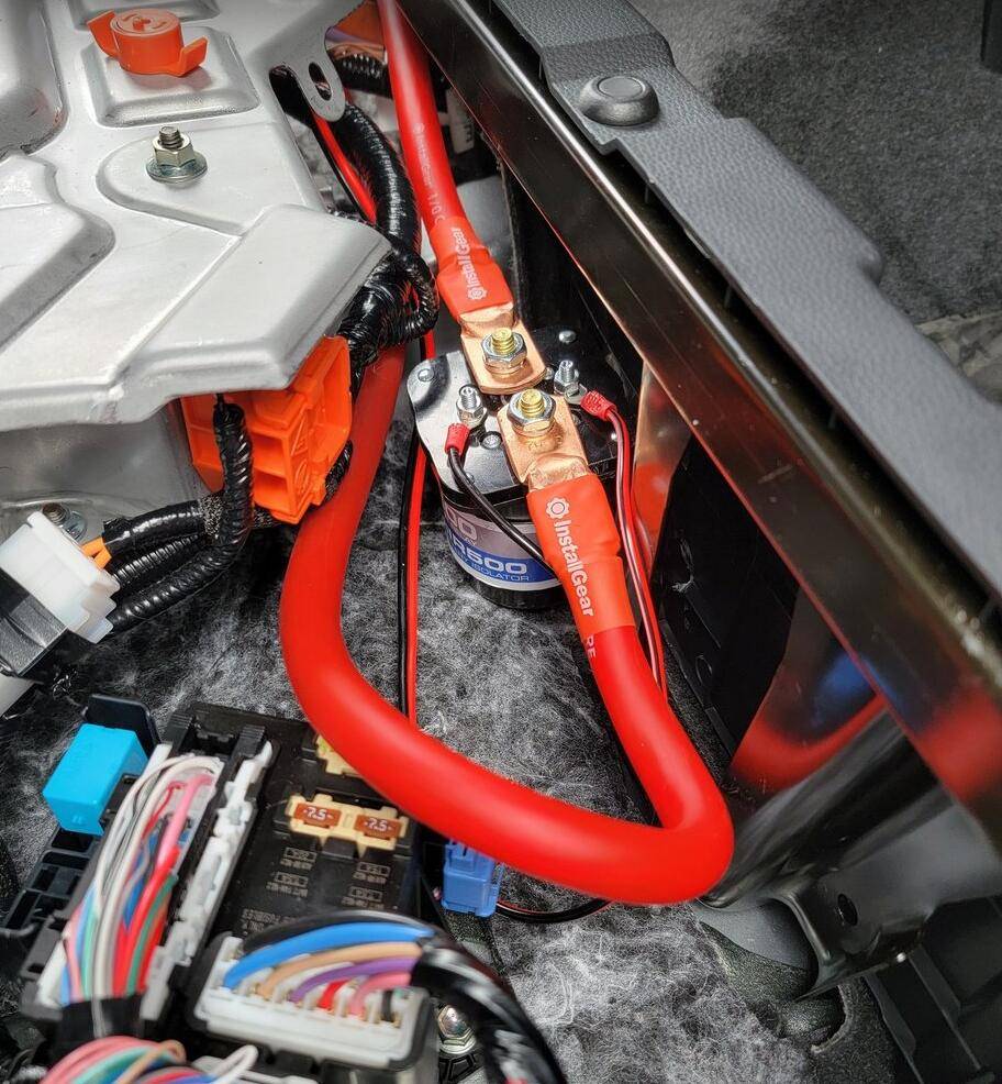

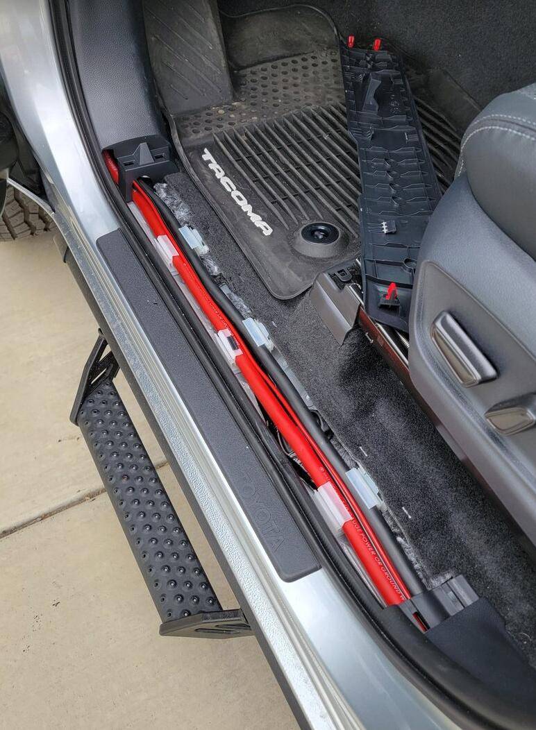

We routed off the AUX3 switch, and ran 16g wire along with the two chonky boys to the rear seat for a power interrupt solenoid I saw mentioned in another thread.
The run:
2024 Tacoma Rough Country Winch Mount + Badlands 12k (HF) install on a 4th Gen 2024 Tacoma Hybrid TRD Off-Road. Minimal trimming, huge PITA, but yessir! 1743364385293-v0
2024 Tacoma Rough Country Winch Mount + Badlands 12k (HF) install on a 4th Gen 2024 Tacoma Hybrid TRD Off-Road. Minimal trimming, huge PITA, but yessir! 1743364400014-xw

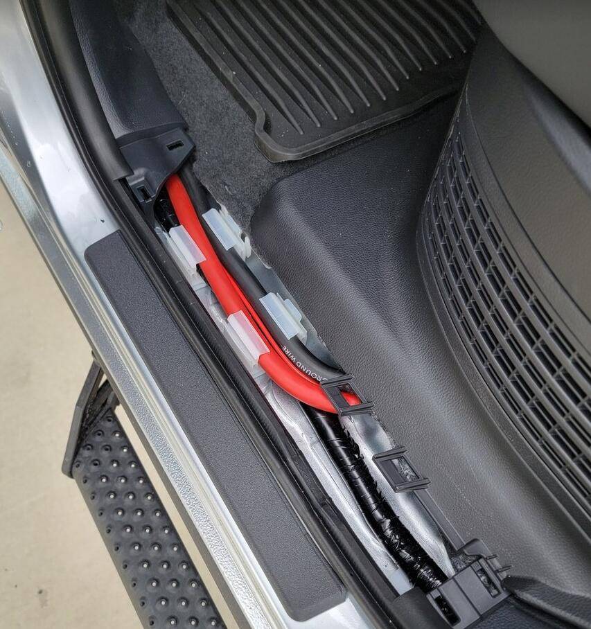

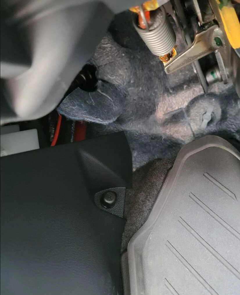

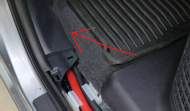

(we removed the seatbelt bolt and took off that piece, no photo, but made a clean run to the backseat. If smaller gauge, possible to fish it maybe? We just did it right.)
2024 Tacoma Rough Country Winch Mount + Badlands 12k (HF) install on a 4th Gen 2024 Tacoma Hybrid TRD Off-Road. Minimal trimming, huge PITA, but yessir! 1743364463598-dh
removed that trim also to feed it past the battery:
2024 Tacoma Rough Country Winch Mount + Badlands 12k (HF) install on a 4th Gen 2024 Tacoma Hybrid TRD Off-Road. Minimal trimming, huge PITA, but yessir! 1743364496046-m8
2024 Tacoma Rough Country Winch Mount + Badlands 12k (HF) install on a 4th Gen 2024 Tacoma Hybrid TRD Off-Road. Minimal trimming, huge PITA, but yessir! 1743364510973-4m

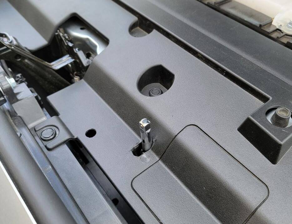

over to rear passenger, where we mounted the solenoid directly bolted to the trim piece:
2024 Tacoma Rough Country Winch Mount + Badlands 12k (HF) install on a 4th Gen 2024 Tacoma Hybrid TRD Off-Road. Minimal trimming, huge PITA, but yessir! 1743364544836-gw

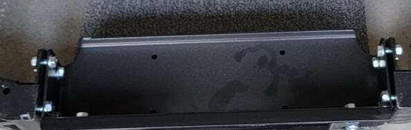

Buttoned everything up, and cut the fairlead access channel in the bumper. I REALLLY WISH i had some photos of this, but I simply was moving too fast with the dremel.
Using the magic of photoshop, I can give you the general gist. Just held the fairlead up to my (detached) bumper, and lined up the middle, and just put a dot for each hole and traced the INSIDE of the fairlead:
2024 Tacoma Rough Country Winch Mount + Badlands 12k (HF) install on a 4th Gen 2024 Tacoma Hybrid TRD Off-Road. Minimal trimming, huge PITA, but yessir! 1743365067904-pz
this gave me the rough shape:
2024 Tacoma Rough Country Winch Mount + Badlands 12k (HF) install on a 4th Gen 2024 Tacoma Hybrid TRD Off-Road. Minimal trimming, huge PITA, but yessir! 1743365149696-sf
I cut this as a narrow slit from left hole to right hole, all the way across, and held it up to make sure it looked "generally good" then widened it to the height of the fairlead hole, ALL the way across. So one long hole from bolt to bolt, the height of the fairlead:
2024 Tacoma Rough Country Winch Mount + Badlands 12k (HF) install on a 4th Gen 2024 Tacoma Hybrid TRD Off-Road. Minimal trimming, huge PITA, but yessir! 1743365290930-jv
I did NO cutting on the "upper" bumper. Just a oval from bolt to bolt, barely taller than the fairlead gap, then buttoned her up, held the fairlead in place, and screwed the bolts into the nuts, held from behind.
This puts me in a weird spot, I know. If I want to remove the front, I'll have to remove the fairlead, since it's essentially pinching the front bumper between the winch mount and the fairlead. I've seen people make entire cuts that go ALL THE WAY AROUND the fairlead, so the bumper can continue to be as removable as it was, and when teh time comes I need to do that, I'll likely trace around the fairlead very carefully, remove the fairlead to remove the bumper, and then cut the full fairlead shape out of the bumper for the final reinstall... but for now I like how clean it looks. You can't see any cuts, the fairlead itself blocks any sight of cut plastic.

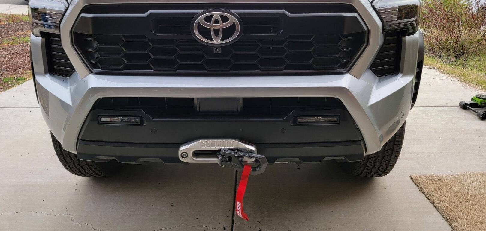

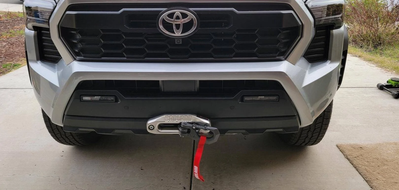

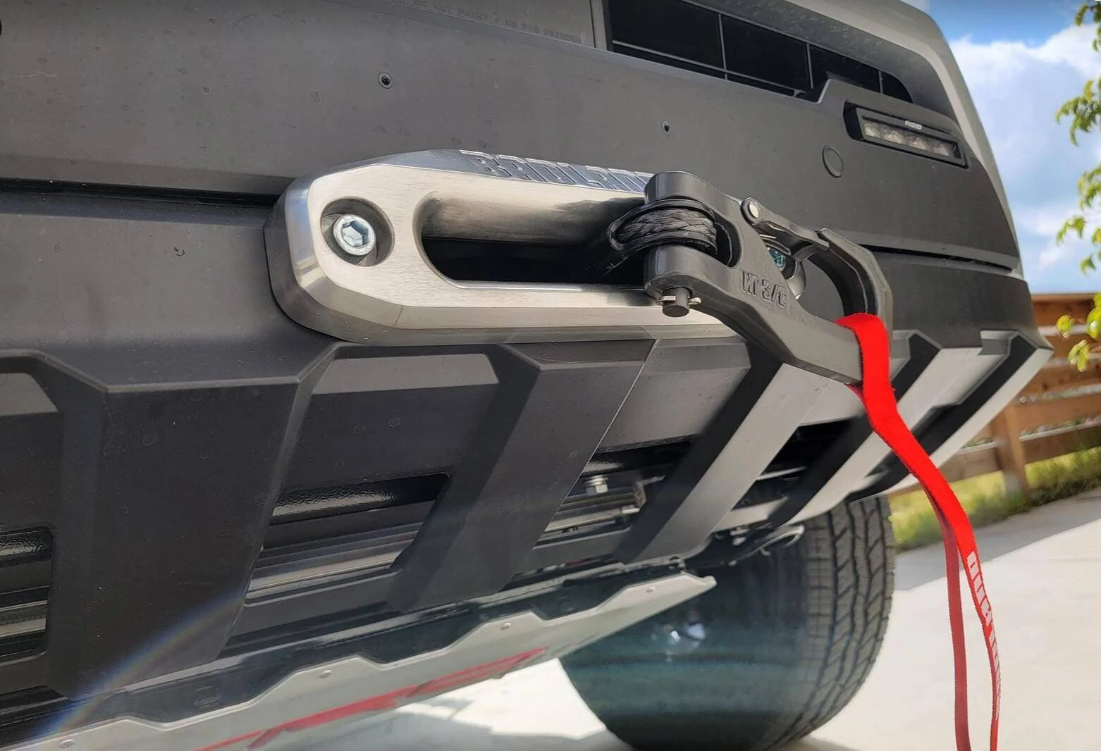

Anyway, the great reveal:
2024 Tacoma Rough Country Winch Mount + Badlands 12k (HF) install on a 4th Gen 2024 Tacoma Hybrid TRD Off-Road. Minimal trimming, huge PITA, but yessir! 1743365712401-6d
2024 Tacoma Rough Country Winch Mount + Badlands 12k (HF) install on a 4th Gen 2024 Tacoma Hybrid TRD Off-Road. Minimal trimming, huge PITA, but yessir! 1743365741377-xn

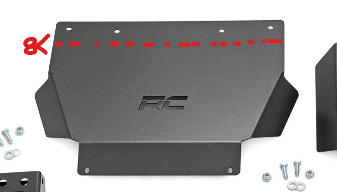

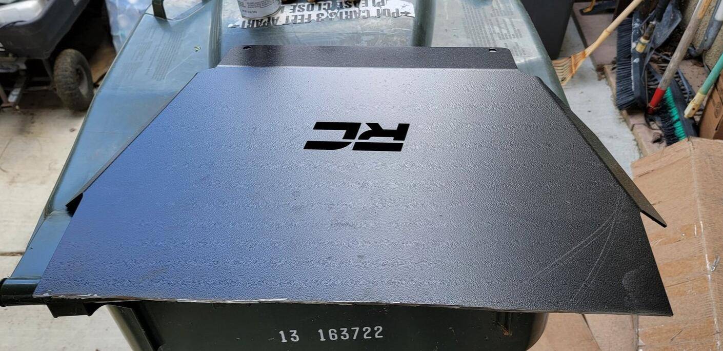

The final mounting also required the trimming of the RC armor, again, huge shout out to @jettaway for this:
2024 Tacoma Rough Country Winch Mount + Badlands 12k (HF) install on a 4th Gen 2024 Tacoma Hybrid TRD Off-Road. Minimal trimming, huge PITA, but yessir! 1743365915321-8r
You take their armor, and cut along the dotted line (after installing the nutserts line they say to do):
2024 Tacoma Rough Country Winch Mount + Badlands 12k (HF) install on a 4th Gen 2024 Tacoma Hybrid TRD Off-Road. Minimal trimming, huge PITA, but yessir! 1743366163650-3t
2024 Tacoma Rough Country Winch Mount + Badlands 12k (HF) install on a 4th Gen 2024 Tacoma Hybrid TRD Off-Road. Minimal trimming, huge PITA, but yessir! 1743366178234-p9
Clean it up, Rustoleum it, and install as Jettaway shows. What I show above is the garbage piece. You use the trimmed off bit to attach the OEM bumper.
Very happy.

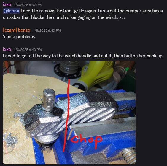

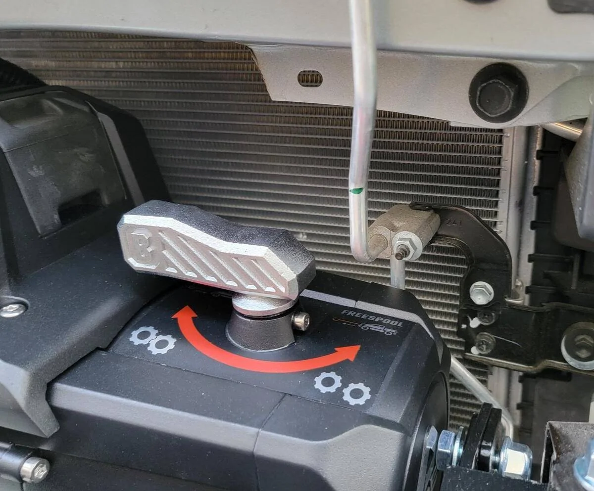

one note, I had to take the front back off and cut the handle to the winch clutch. The front assembly has some bars that interfere with the clutch handle itself rotating. Just opened her back up, got the clutch removed, and cut it off:
2024 Tacoma Rough Country Winch Mount + Badlands 12k (HF) install on a 4th Gen 2024 Tacoma Hybrid TRD Off-Road. Minimal trimming, huge PITA, but yessir! 1745439791002-ky
Works great now!

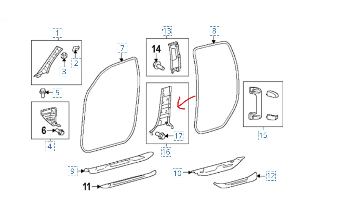

But tell me what you mean when you say you had to remove the seatbelt bolt to get to from the front seat to the back seat sill. And was running the thicker cable really as difficult as my shop is making it seem?
I opted to remove the actual plastic trim that "houses" the seatbelt retraction mechanism, and actually unbolt the seatbelt itself from the inner wall of the cab (just so that piece wasn't flapping around obnoxiously):
2024 Tacoma Rough Country Winch Mount + Badlands 12k (HF) install on a 4th Gen 2024 Tacoma Hybrid TRD Off-Road. Minimal trimming, huge PITA, but yessir! 1768413506937-x9
you can see that part here (viewed from the back door open):
2024 Tacoma Rough Country Winch Mount + Badlands 12k (HF) install on a 4th Gen 2024 Tacoma Hybrid TRD Off-Road. Minimal trimming, huge PITA, but yessir! 1768413562748-bm
You could MAYBE run the wires blind through that area, but I think the hassle of just removing that part was worth it. I was able to lay them flat and route them perfectly, so I'd just bite the bullet and do it.
It was a PITA to do this whole run, but you just gotta power though it. Having someone else do it and paying labor would be an option, but I'd rather know exactly how it was done than just give someone $300 and hope it was done well.
One other thing worth mentioning, with those chonky boys running in the channel where there used to be none, a few clips may be deformed as you clip it all back together. This is kinda to be expected.
2024 Tacoma Rough Country Winch Mount + Badlands 12k (HF) install on a 4th Gen 2024 Tacoma Hybrid TRD Off-Road. Minimal trimming, huge PITA, but yessir! 1768413903628-f
It WILL clip back cleanly, it's not like it looks janky now, but requires a little wiggling to get it to sit fully flush and properly "click" back into place again. Just be patient.
Good luck!
