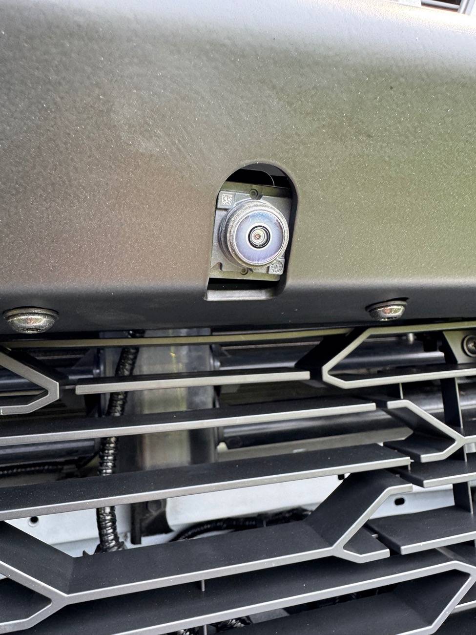

Kind of interesting - didn't realize that bumper is so tall, that it requires relocating the front-facing camera.

I did it with a shop, took them 5 hours to install and ARB book time is also 5 hours, comes with all relocation kit for the camera and didn’t have any problems with parking sensors and radar everything works as supposed too. Weight is about 300 lbs with the winch installed. I have the IRONMAN 4x4 3.5 lift with the medium duty springs all around which works perfectly with the weight of the bumper

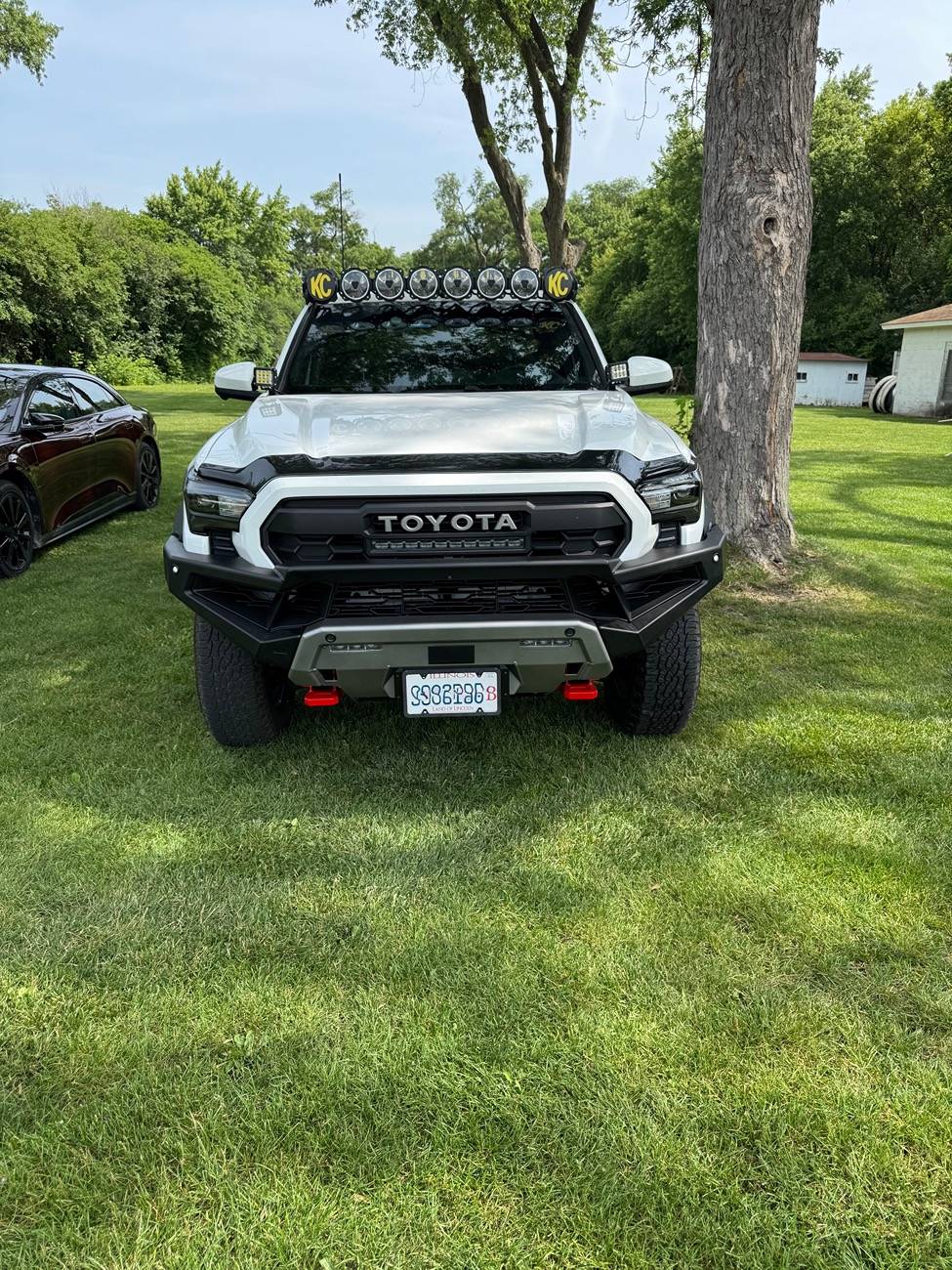

Just got the new ARB zenith front bumper installed with the SCAR 12,000 pound winch. I absolutely love the look next big buy will be tires and rims.

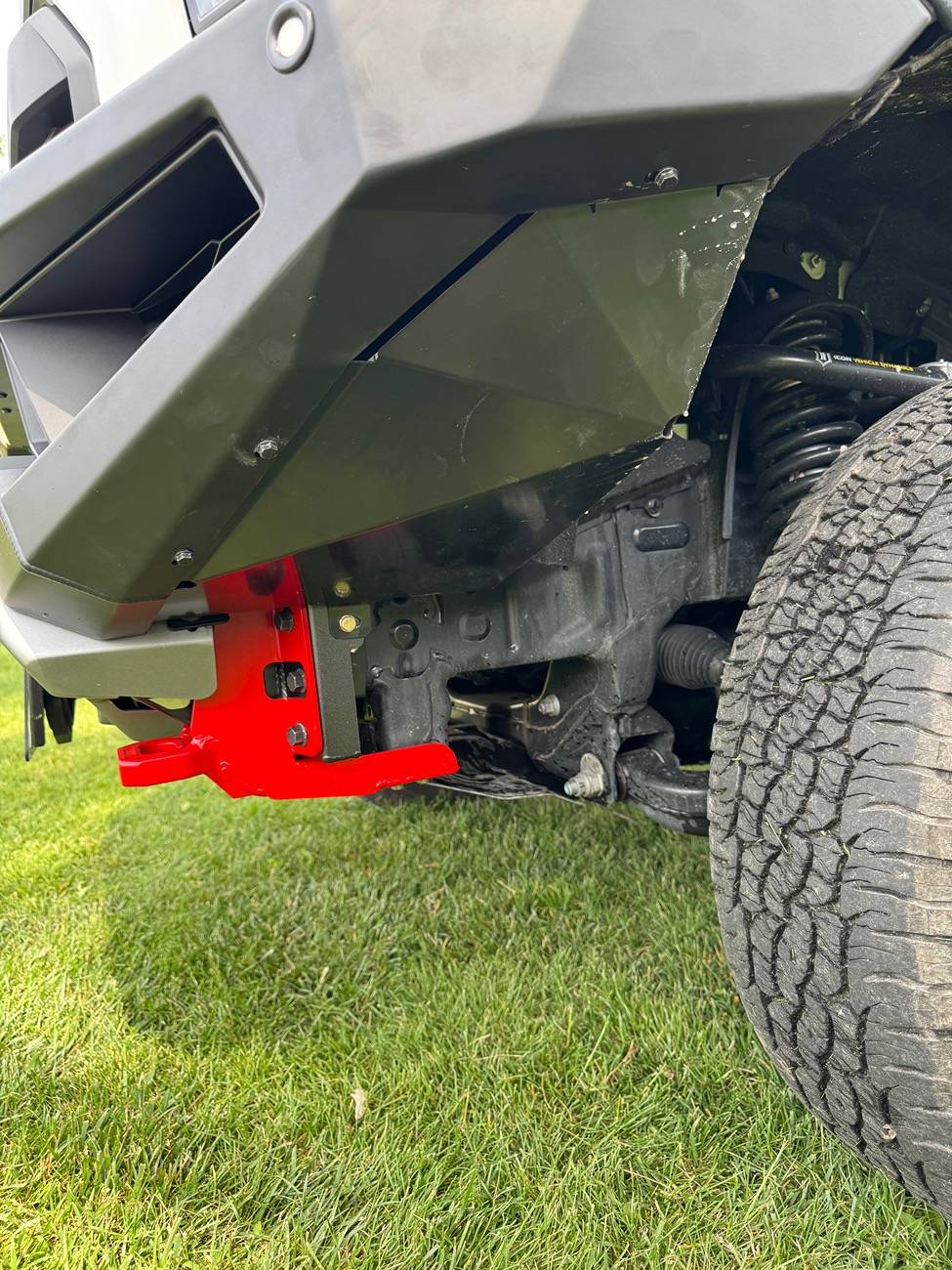

Can I see a picture from underneath? Do you have a skid plate and how does the Zenith bumper attach to the skid plate?

I don’t have a picture at this time but it lines up with the oem one that came with the truck didn’t need to change anything on mine

I'll post my own build thread later today or tomorrow. Just picked up my truck this morning from having this bumper installed. Here's a pic showing how the stock Trailhunter skids mate with the bumper.
