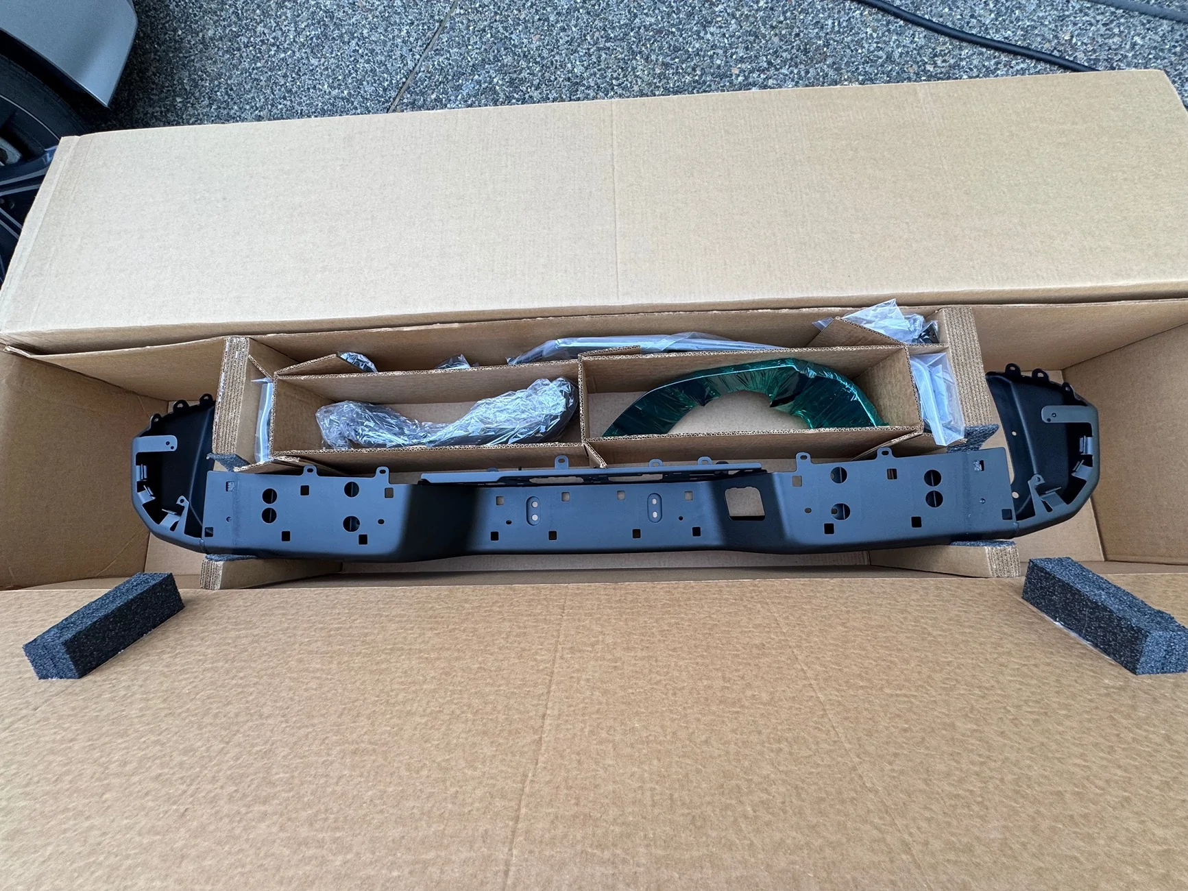

Double check all the parts prior to install, mine was short one of the sensor brackets.
