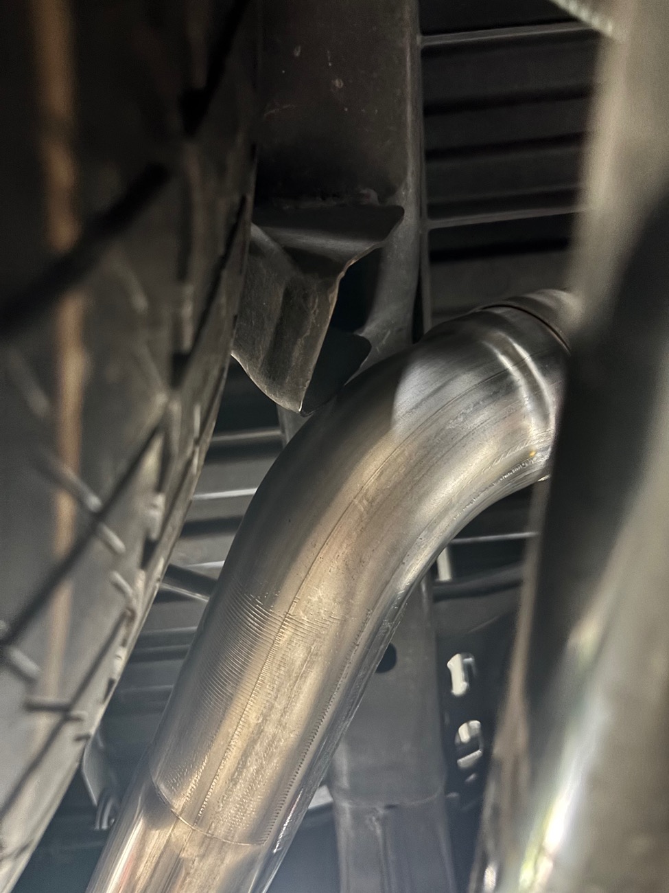

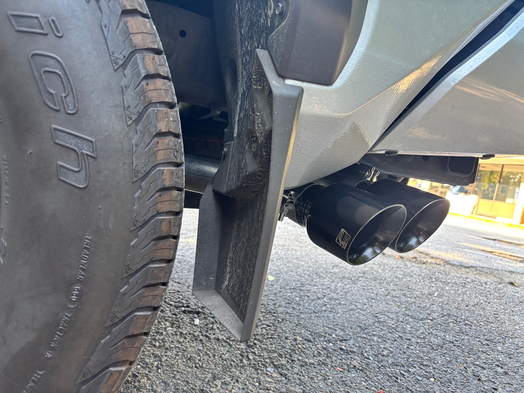

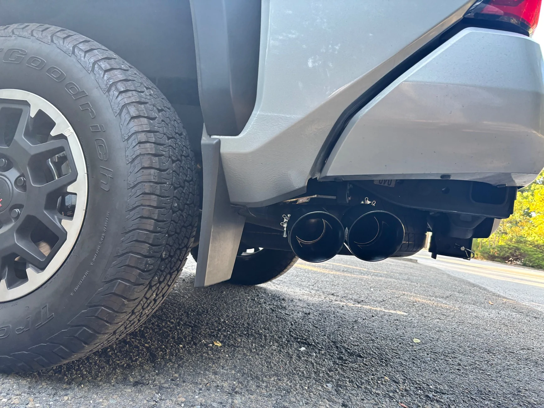

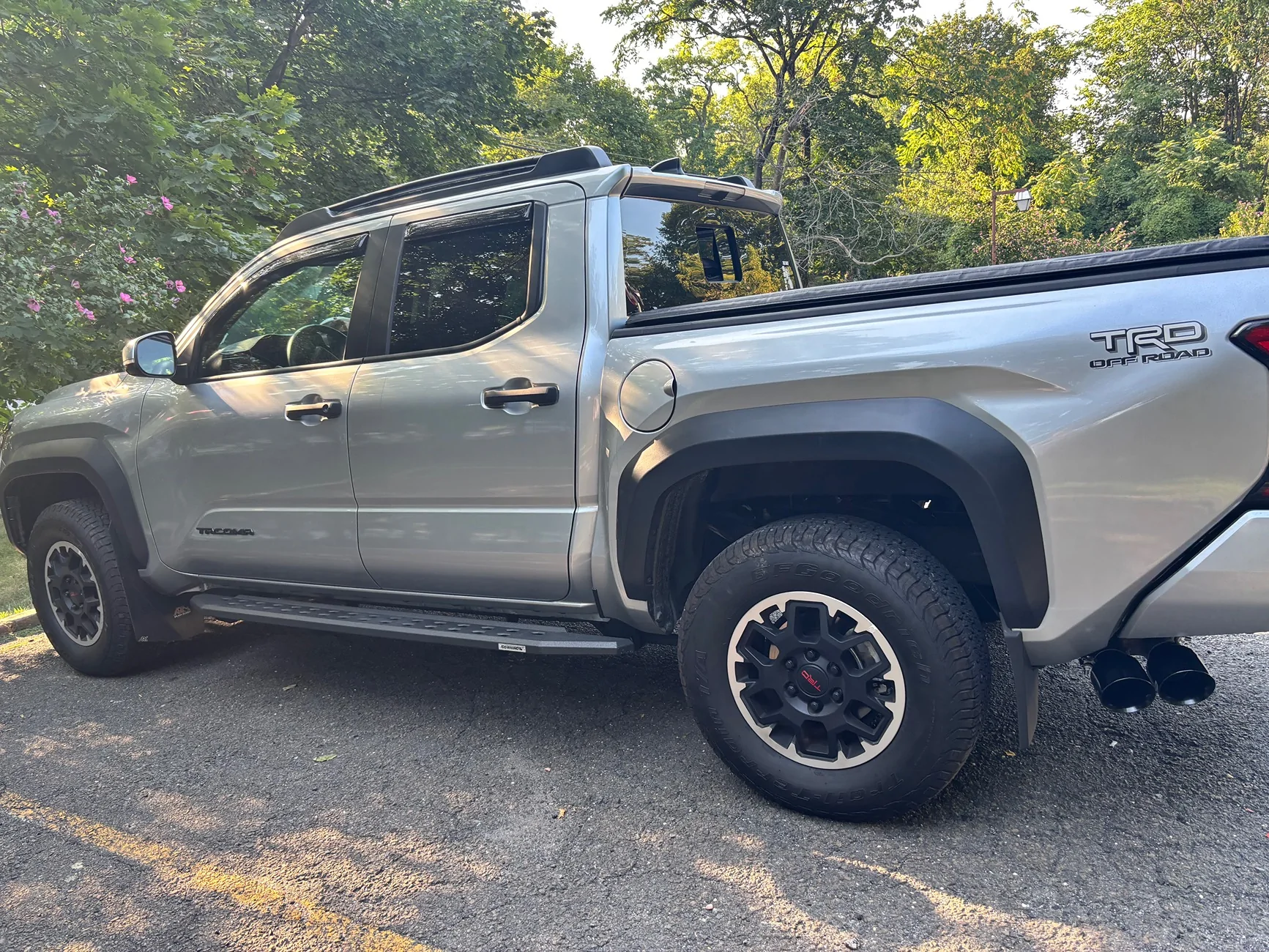

Just put on the AWE 0FG (@Sara/AWE), 99% smooth process but the sharp elbow of the system toward the spare tire area does touch the spare tire bracket. It just rests next to it. There is going to some hitting if I go over bumps but so far I don’t hear it transmitting into the cabin.

I wish the tips were welded to the pipes. Those clamps or claps look horrible.
Let’s hope the tips don’t fall off.

Hey OP, those tips are not positioned correctly, they should both be rotated 90 degrees so the logos are facing up and the slash is pointing backwards. From there you can rotate the clamps to the top of the tips so they are not visible. If they are properly tightened down there should be no issues with shifting, etc.
2024 Tacoma AWE 0FG Cat-Back Exhaust Fitment on 2024 Tacoma TRD Offroad 3015-33254_4_d58aff7e-cc98-4ec3-87a0-73d7a18050f
The pipe positioning is too close to the bracket, ensuring that all of the pipes especially those upstream are fully bottomed out will give you more clearance on that particular bracket. Be extra careful with G34 to G33, given the angle of the piping it is prone to backing out.
Tacoma Installation Instructions
If you are still unable to adjust it away from the bracket, please reach out to our customer support team before you do anything else and they can assist you in getting your system adjusted properly.

Sara, I am sure each section is pushed into the previous tube to the furthest, but I’ll check, my concern with this approach is that the G33 elbow that’s designed to “climb” up and down the rear differential will then be moved forward. It is already not exactly above the differential. I am going to try to twisting method. Based on the Motoroso installation video, there was a very quick shot that shows his G33-G34 is very far from the spare tire piece. By the way I can’t find your own install video anymore? :)
