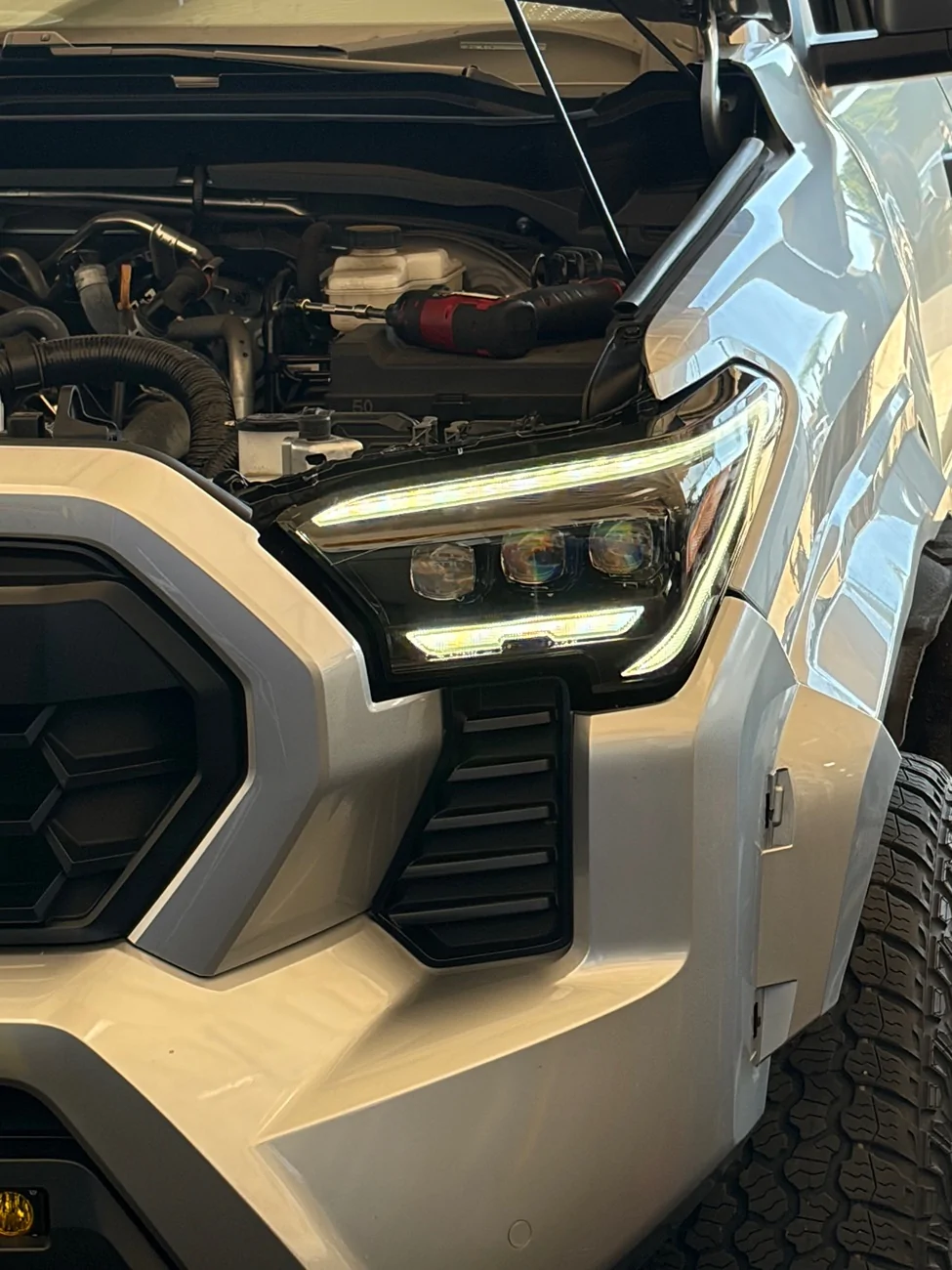

rijc99
Oct 1, 2024
436
233
I did not remove the entire bumper. I unbolted the upper portion including the two bumper support bracket in the middle and removed the flares. You will have to be real careful doing it this way though. There is one screw that goes in sideways right behind where the bumper meets the fender.
Alpharex nova series? Does this option come with the Amber daytime running lights instead of the white you’ve got there now? I’m told it’s possible to switch the color via smartphone app.
Also how do you feel about the light output? Is it similar to OEM or better?
Thanks!
rijc99
Oct 1, 2024
436
233
Better than OEM. Cutoff is more defined so it’s a toss up since I have more light on the ground but everything above the line is no longer illuminated.
It can do Amber. I initially had amber but felt it didn’t fit my silver truck so I switched it to white. I would have preferred to no have the bottom bar light up but it’s ok. I wish they had connected the two white wires to a toggle in back so we can switch white/amber without having to remove the light.
The app requires another module that isn’t available yet. It might be relesased after sema.
