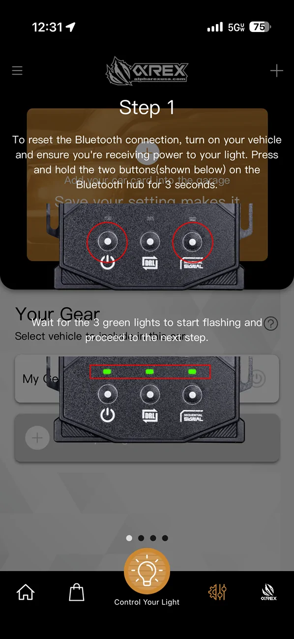

I didn’t think their app was up and running yet. I just downloaded it and will explore. Thanks! But I don’t think it will work unless I installed the drl harness.
rijc99
Oct 1, 2024
414
213
I was told the app requires another module or board that wasn’t available yet. They said it would be after SEMA. Since SEMA happened I’m not sure if it’s been released.
Edit. Yeah. I definitely don’t have these buttons on my unit.
