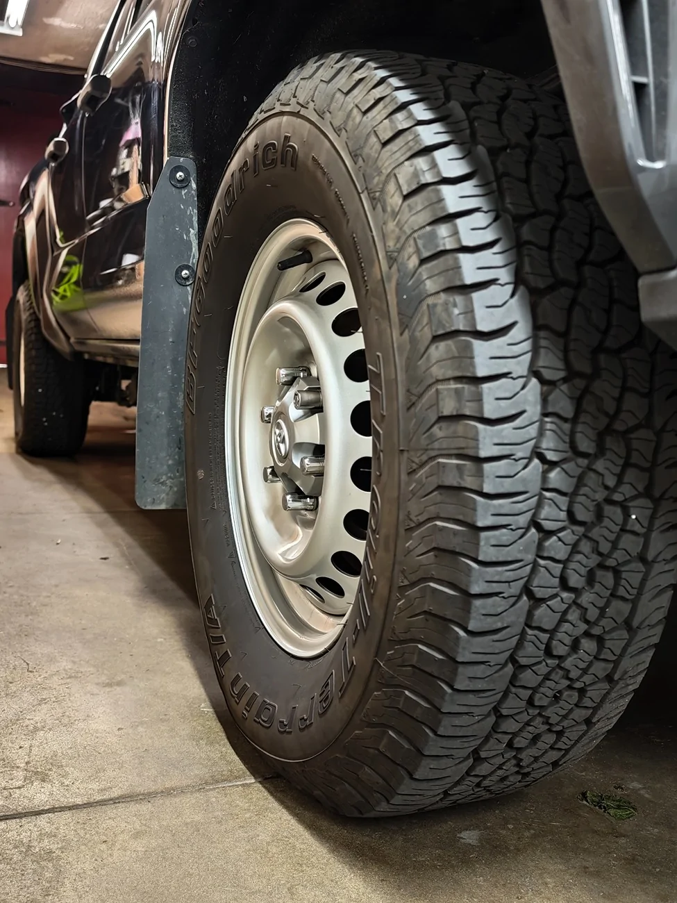

You're fine to go with the smallest wheel the tire manufacturer deems acceptable.
I've got 265s on 17x7, looks nice and rides well at 29psi. According to the tire spec, x7 is the smallest wheel they should be mounted to.
On trucks you're not taking sidewall flex into consideration when looking at handling (because it's a truck not a sports car) so fuck it, run thick tires on a small wheel.
2024 Tacoma 17 x 8.5 better than 17 x 7.5? IMG_20260113_101402
