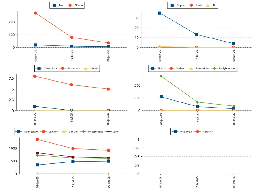

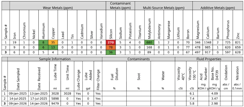

I changed the oil at 3k, 6k and 10k and took samples to send in for analysis.
Anyway, it seems like it has broken in nicely. After the break-in period wear metal levels have been coming way down.
2024 Tacoma 3 oil changes in first 10,000 miles. Oil Analysis lab results attached. 1768952416766-m6
2024 Tacoma 3 oil changes in first 10,000 miles. Oil Analysis lab results attached. 1768952579948-hm

Looks healthy. Seems like break in is complete somewhere around 15,000 miles on these.
Is their viscosity measurement correct? Anything below 6.0 cSt @ 100c is a little thin for 0w-20.
What is your driving style/use?
If Toyota 0w-20 is that thin after 3000 miles and you aren't drag racing, I think I'm going to switch to 3k mi oil changes. I've been doing 4k, and about to hit the 15k service.

What brand of oil did you use for these changes? I ask because of the Moly numbers. From what I’ve seen on new oil tests the OEM Toyota is formulated with higher Moly vs most all other oils including Mobil 1 which everyone thinks is the OEM oil (but it really isn’t)
The first sample came with the Tacoma new but the next two I changed were Mobil 1 0W-20 Advanced Fuel Economy.
Where did you get this tested?
Amsoil / Oil Analyzers
