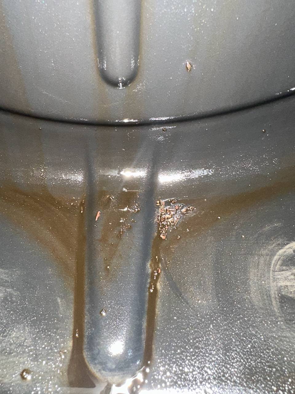

I'm a new 2024 Tacoma owner thought I'd share the results of the 1st Oil change @ 1011 miles I performed today. What your viewing is engine debris left in the pan after draining into my oil container. I'm chosing to change oil early, and often with this engine to prolong its life as much as possible.
Sharing as a FYI in case you've been debating on changing early vs waiting until the 10K mark...

Can you tell what it is? Sealant or metal?

So a few follow-up comments, my pan was clean before starting, so no cross-contamination from anything else. The material left in the pan is quite small, the photo is a macro shot -- so zoomed in to keep things in perspective. To anothers comment, there's no magnet on the drain plug, and besides that aluminum (shavings from the manufacturing process) are not a ferrous metal, and thus not going to be attracted to a magnet, of course. The same goes for copper, which would be used on the bearings, of course. However I'm not sure if these are tri-metal bearings in this engine, but nonetheless -- copper is there so obviously from the bearing material.
One additional comment, the filter from the oil filter was also dumped into the same container, so it's quite possible the bulk of this junk came into the pan when taking the filter off. In hindsight, I should have checked the oil before dropping the filter.
Anyhow, I just wanted to share for the purposes of just that. I will change the oil again @ 2K, and keep tabs on the engine.
As for sealant, I'd be more than willing to bet that it would show up on an oil analysis as the silica content is usually higher on those early oil changes with the excess RTV getting pulled into the oil flow.
But I do agree with your comments, 10K oil changes are not for me. I'm good with 5K, and stick with that, but again I want this truck to last so I'll do the first few extra early just to make sure I get it good and cleaned out.

Just for the sake of my curiosity, I'm going to pick up an oil filter cutting tool and split the filter as I'd like to inspect the filter material. I'll share in a few days once I get the tool.
As for the 2 year dealer maintenance, what I googled was that in effect you really only get two oil changes and that's it. 10, and 20k, and then you're on your own. I'm still on the fence on if I want to take it in.
I decided to go with Pennzoil Ultra Platinum 0w-20 since it's a good oil that's ILSAC GF-6 certified, so perfect for this engine. Beyond that they have a nice engine warranty I'll be registering for. As I've strictly used Amsoil in the past, I'm switching for convenience and money savings. And again that warranty is what I'm after. More here if your are interested in researching: warranty.html
The Toyota OEM oils, while still meeting the same spec, are structured quite a bit differently than any other off the shelf oil. It may be beneficial to use the Toyota stuff for the first 5 to 10,000. Not for the warranty work, but some theoretical longevity benefits because of the additives.

Is this picture from inside your oil pan? if so, how did you capture it?
