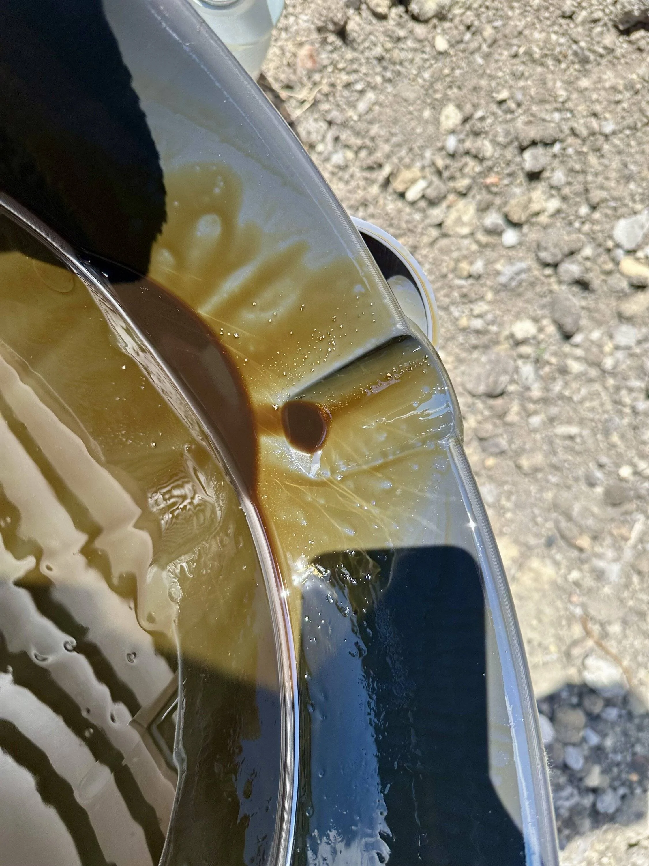

pretty sure this was the pan the oil was drained into, since he said the filter was also dumped into this pan and it may have came from there.
Yeah, that makes sense. FWIW, the drain plug goes in diagonally, and I wonder how much oil and debris is could be left in the undrained well. makes me wish I had changed the oil in mine as soon as I got it home. For future new vehicle purchases, I think I will start doing that.

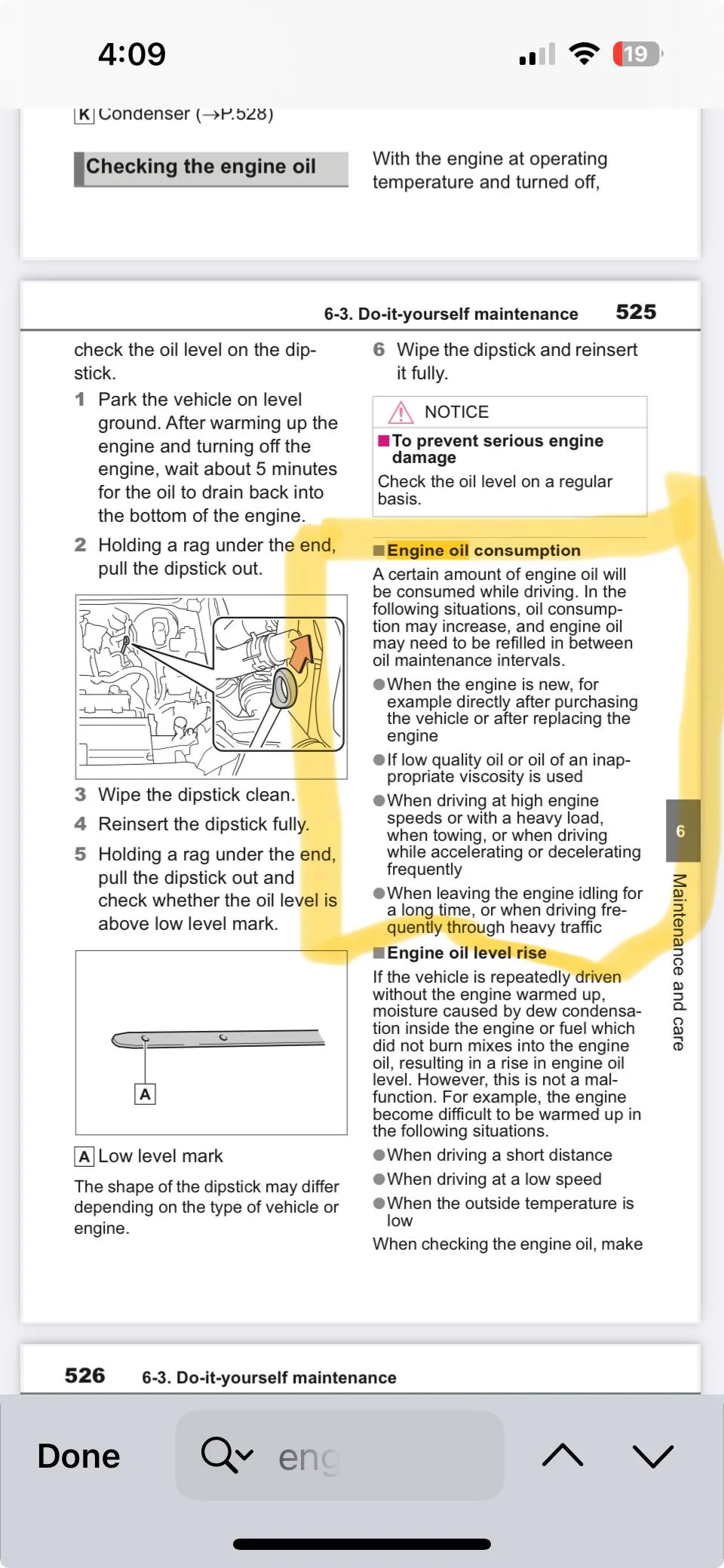

Did my first oil change at 6000 km . Drained oil pan and filter in separate containers . Oil pan was clean but found some small debris in oil filter . Photo attached .
one thing i am confused is that toyota manual book asks for 5.9 q of new oil but only got 4.7 q out in drained oil . Looks like engine did consumed some oil . I went to manual book and found on page 525 that when engine is new it will consume some oil .
anyone else noticed that ??
So I'd like to respond to your comments. Prior to my first oil change, I checked my oil level several times, over the first few week or so, and basically piled on 1K miles in that week so I could swap it out, and break the engine in faster.
I noticed that every time I checked the oil, it was halfway between the two lines, but when I added 6 quarts on that first change, the oil level was right at the very top, by the max line.
My thoughts are that they send these trucks out the door without filling the crankcase with the full 6 quarts to save money, but it could be an issue with the oil filling station. I'm sure we'll never get the full answer on that however, mine was not filled with 6 quarts.
I will say that at no time did my engine consume any oil, as the oil level stayed constant every time I checked it. I will be monitoring my engine over the next 4k miles until I hit the 5K mark, at which point I'll back off on checking the oil as much.
Yes before oil change dip stick would show me in between full and low point and after after doing oil cahnge i put 5.7q and dip stick started showing me little over the full dot . So i called my mechanic friend if i should take some out he said wait for a day and now after a day its little below full point which is good
