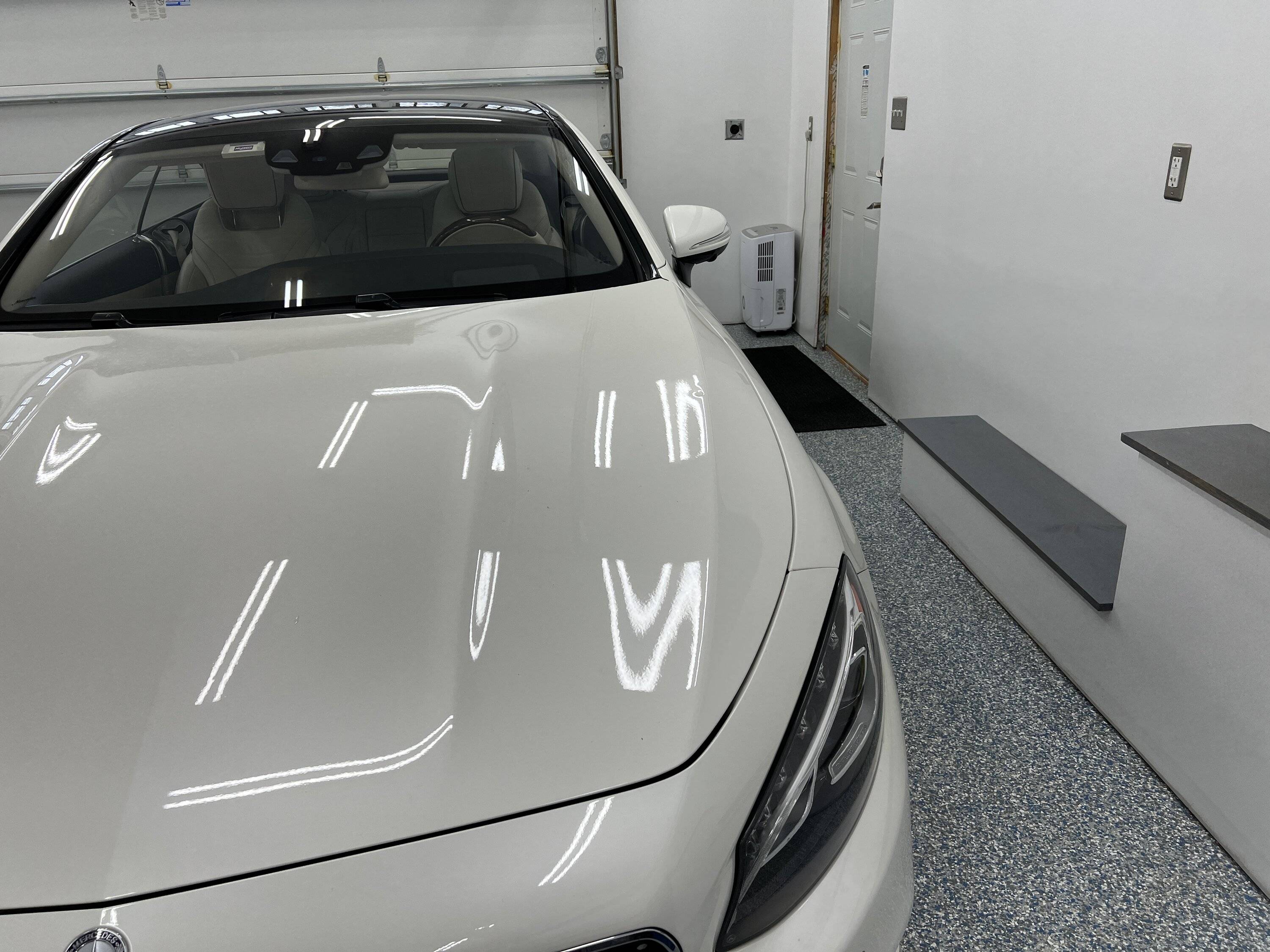

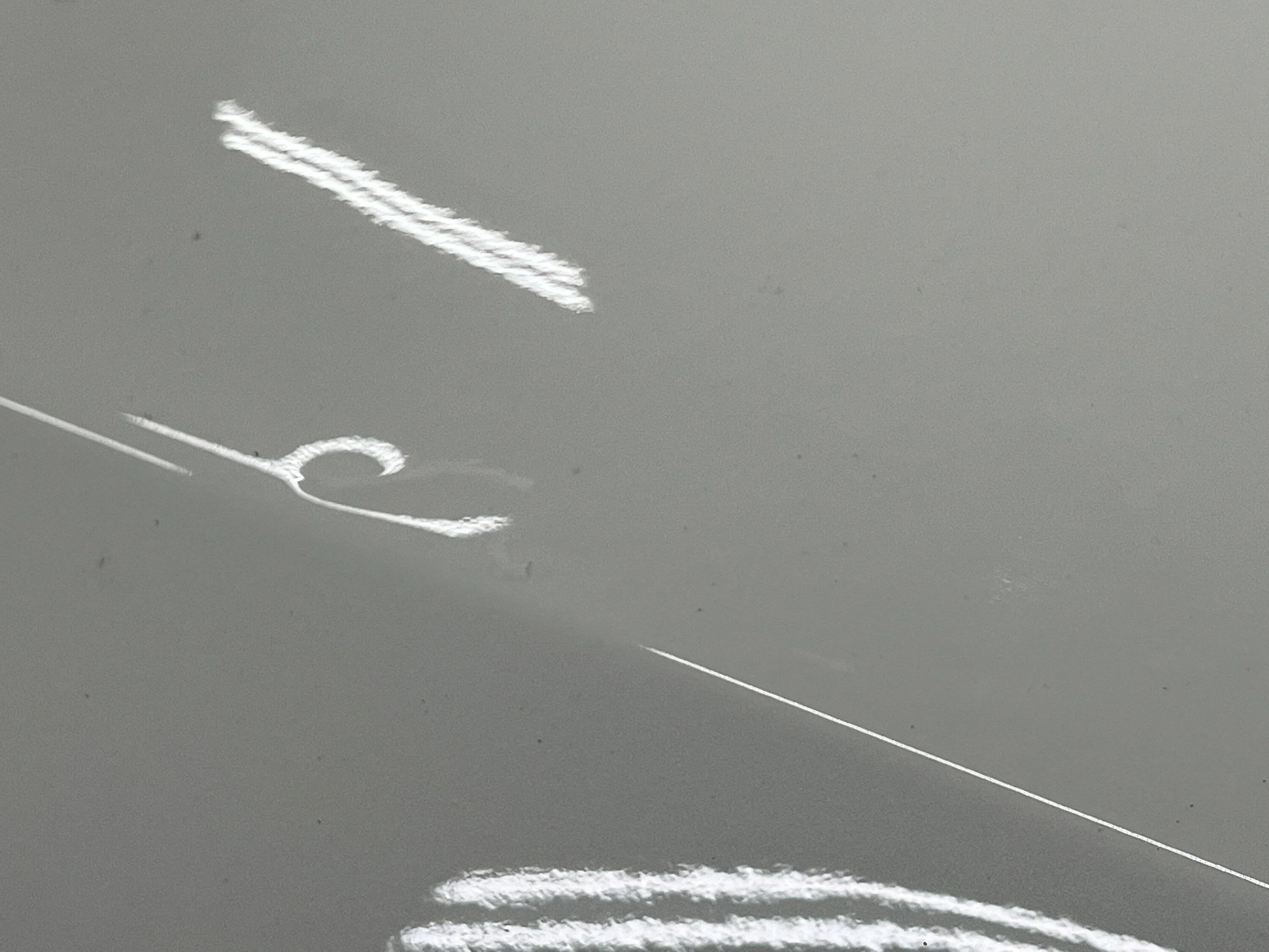

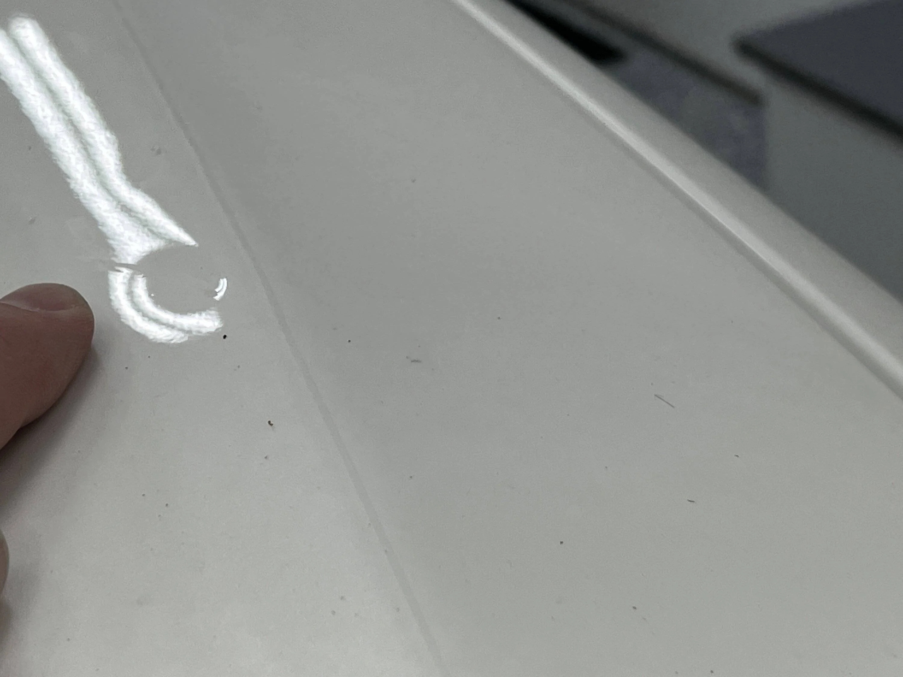

FWIW, I own and operate my own detailing/PPF shop and I do hear this from people occasionally. My father has also been doing body work and painting for over 50+ years. Sure, you can run down to Maaco and get a cheap paint job, but that's exactly what it will look like. A quality job at a reputable shop would be closer to $12-15k. That means properly disassembled with no tape lines, no over spray, and properly denibbed, wet sanded/polished to match OEM texture (or better). Heck, I've seen paint jobs at my fathers shop where just the cost of paint and clear (cost to the shop) were $6500! Keep in mind that a repaint can effect resale value and anytime a car goes into a body shop it always opens a can of worms IME. Now with modern PPF your paint should stay free of chips and with proper washing it should stay swirl free too and it's warrantied for 10-12 years. It also helps protect against door dings in that you may get a ding, but it won't chip the paint. I've seen PPF'd cars that were keyed and the paint remained untouched. The below pics are of my wife's car where a piece of metal hit her car on the highway. While it dented the hood, it didn't puncture the film and was repaired for $75 via PDR. A repaint on that hood would have been $1000+ and the pearl white color is a PITA to match perfectly. The unprotected glass roof didn't fair as well though. That had a tiny nick/chip in it they eventually cracked and had to be replaced at the cost of $5500!
PPF isn't for everyone, but I assure you it cost a fraction of what a proper repaint costs. :)
