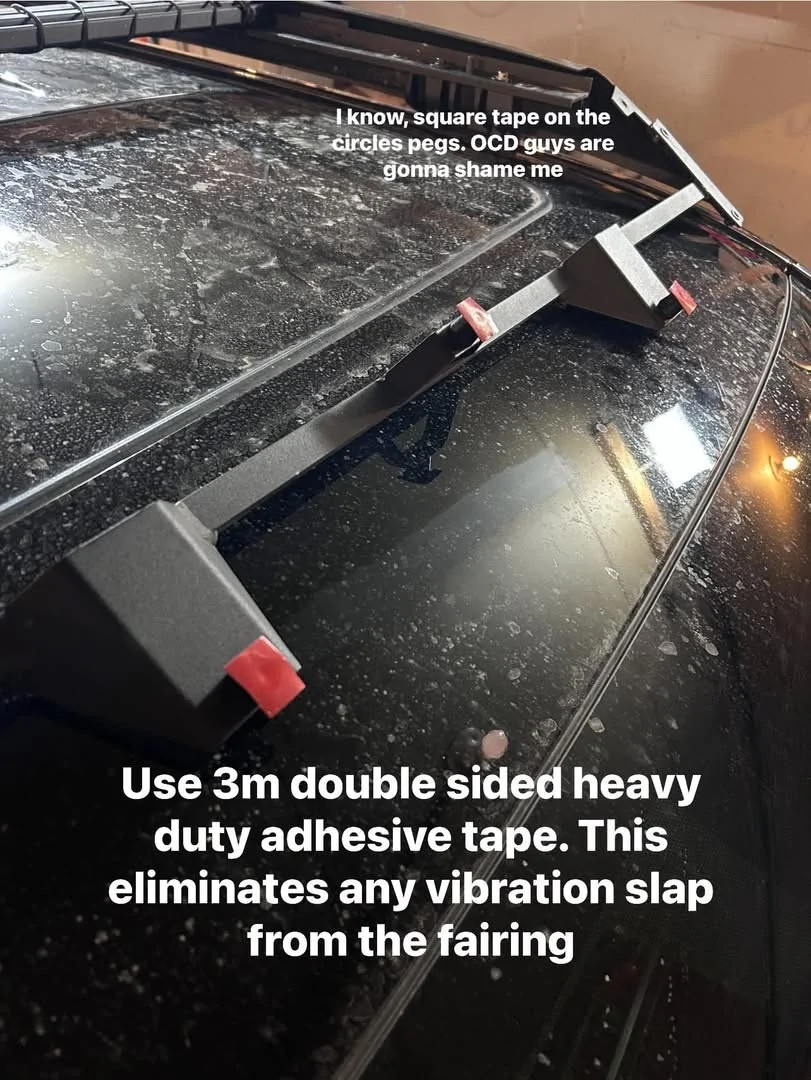

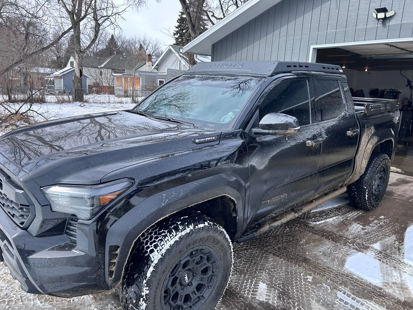

Attached are the pictures of the process, not quite in chronological order but there really isn’t a right or wrong way to start this. That being said, you do need to pull your front fairing off before you start. It’s easy, 6 Torx bolts and you’re done.

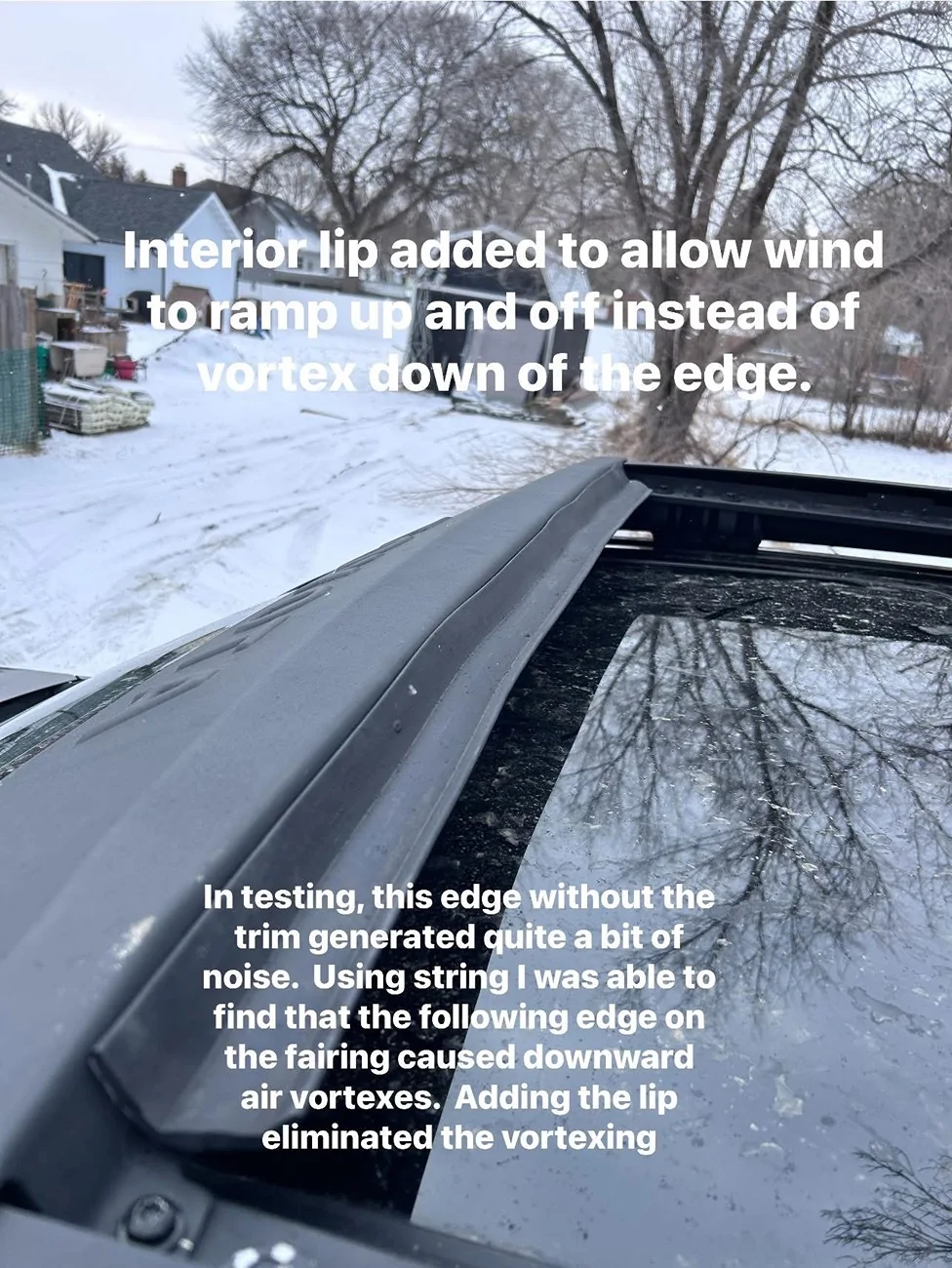

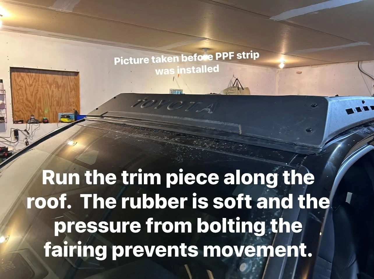

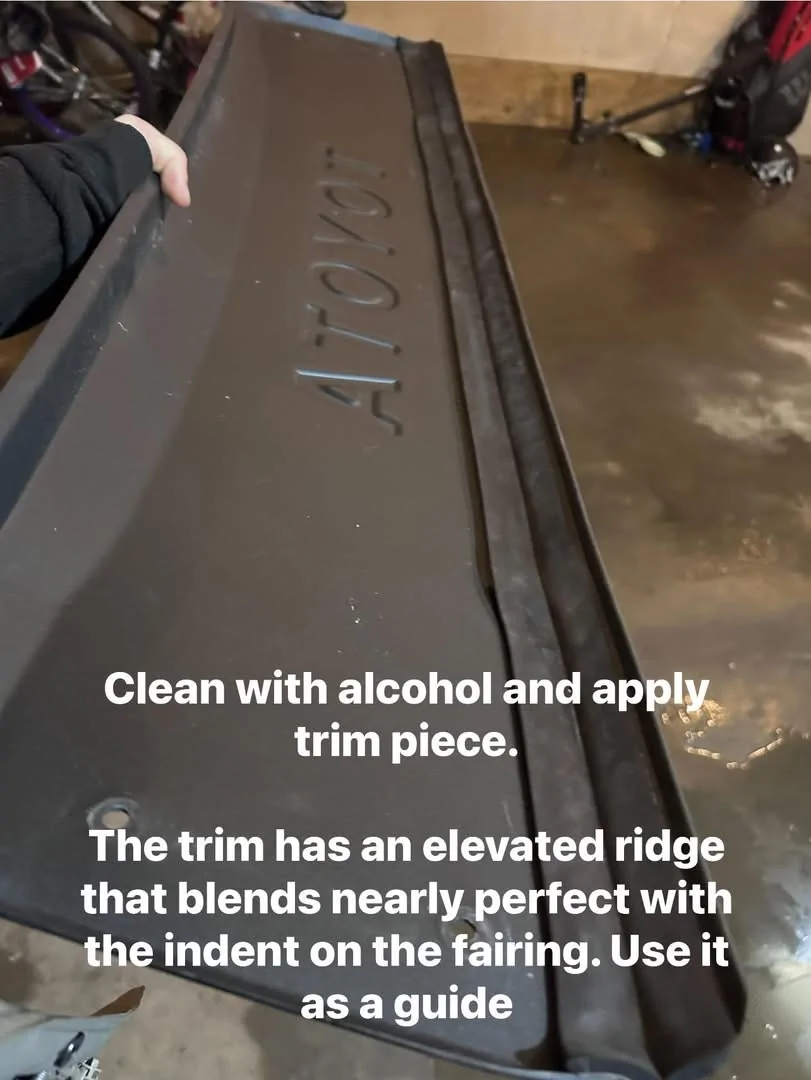

Start by cleaning your surfaces. Pictures provided do not show clean surfaces but it’s important. Measure and apply trim piece to the lower edge of the fairing. Trim the edges to round out for a nicer look. Leave about an inch or so of trim poking out. The trim has an elevated section where the tape is that fits nearly perfectly with fairing indent so it’s pretty easy to line up. Put ppf strip over paint where the edge meets the body. Reinstall. (I did this step backwards and it was a bit annoying to put the strip on once the fairing was on.
Add second trim to the rear fairng edge. Cut and trim as needed. Pretty straightforward.

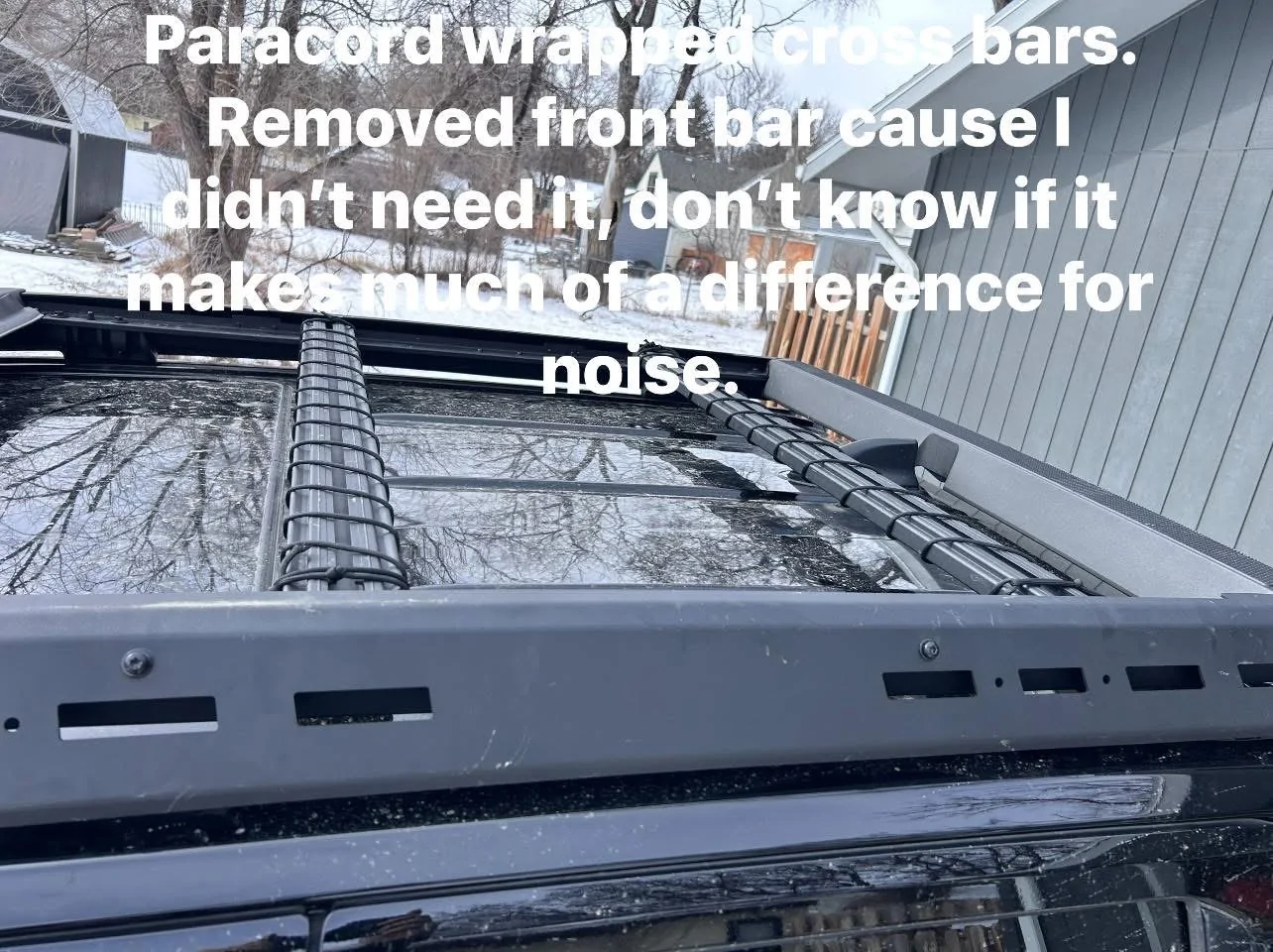

Wrap cross bars with paracord to reduce turbulence of air passaging over them.
And that’s basically it. With some trial and error testing it took me a little over an hour. The job itself is only about 15 minutes.

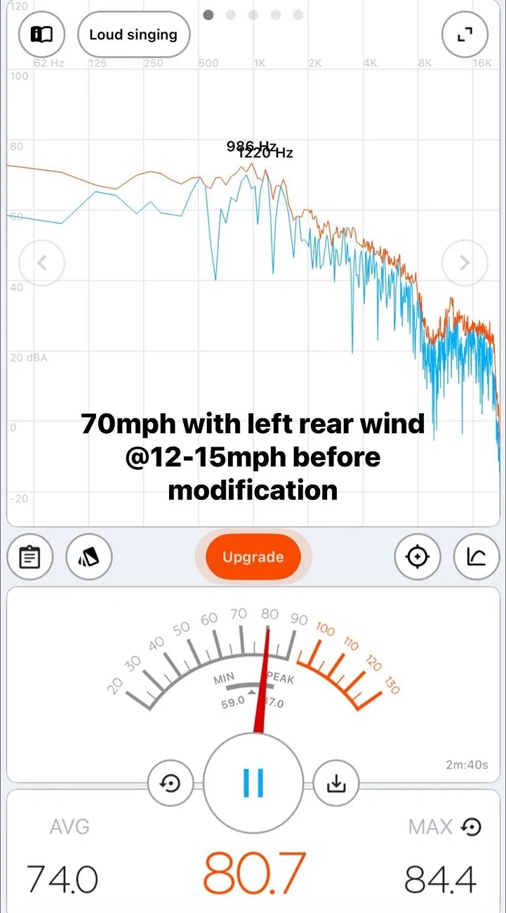

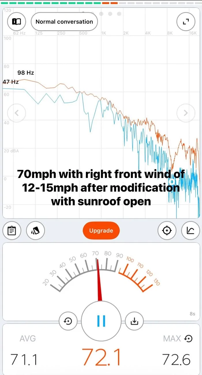

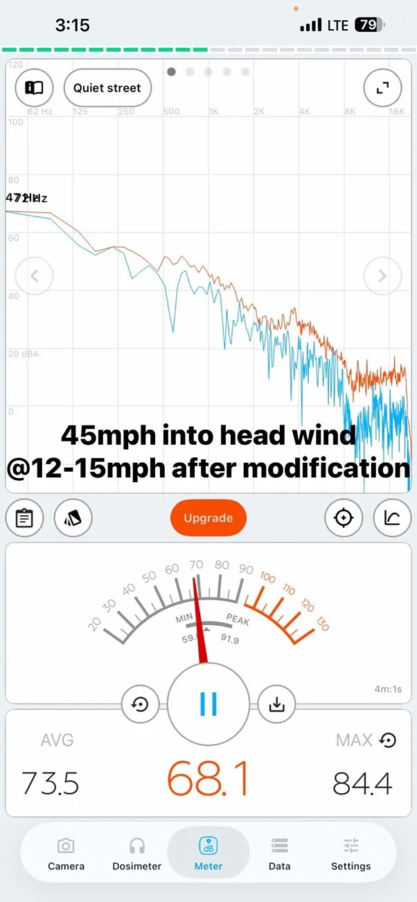

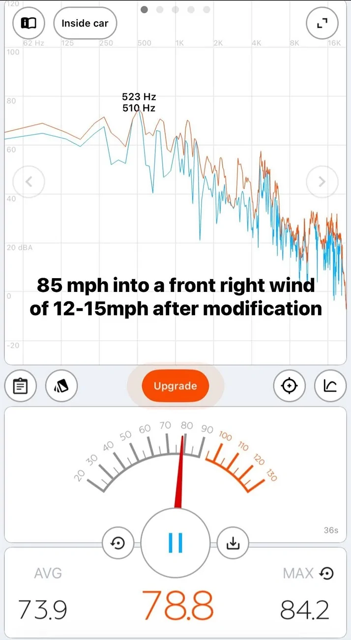

The difference is astonishing. I already had the TSB completed and was still getting decibels around 80 when driving into a head wind. With the modification the decibels were low 70s and that improvement cannot be overstated. Without the roof rack cab noise would be around 68-70 in similar conditions. So the mod brings the noise level close to not having the rack at all. Mpg tests were not performed because in the great white north we have really heavily blended winter fuel so no matter what the MPGs are trash. Maybe I’ll do an update this summer.
