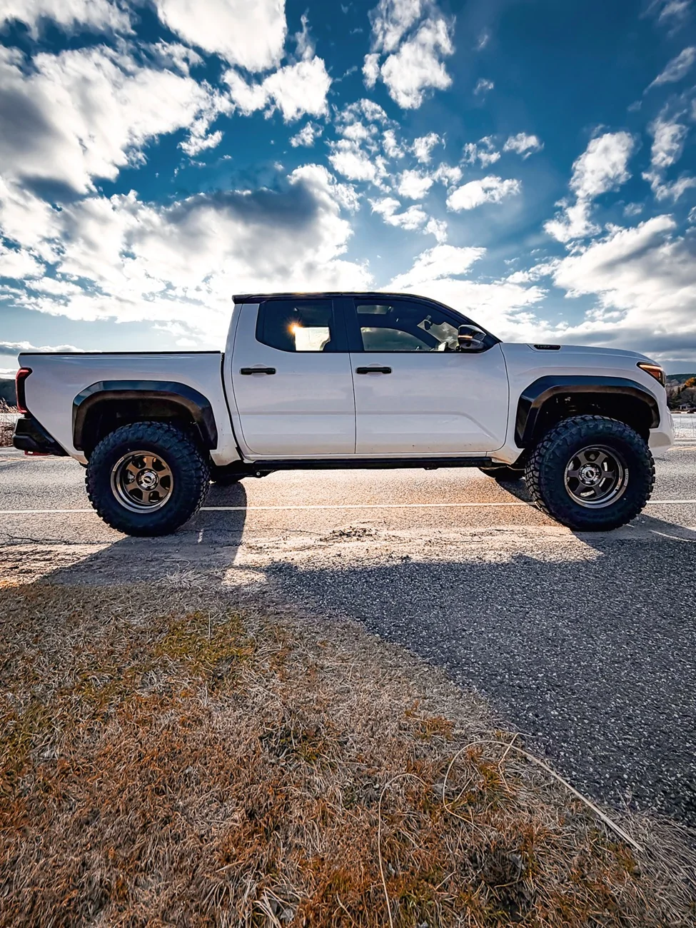

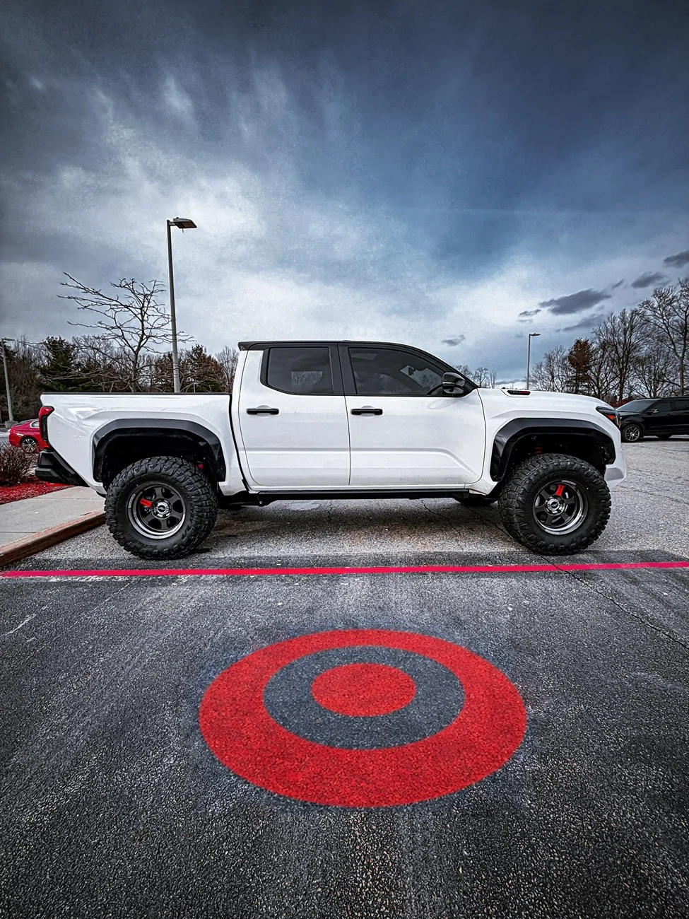

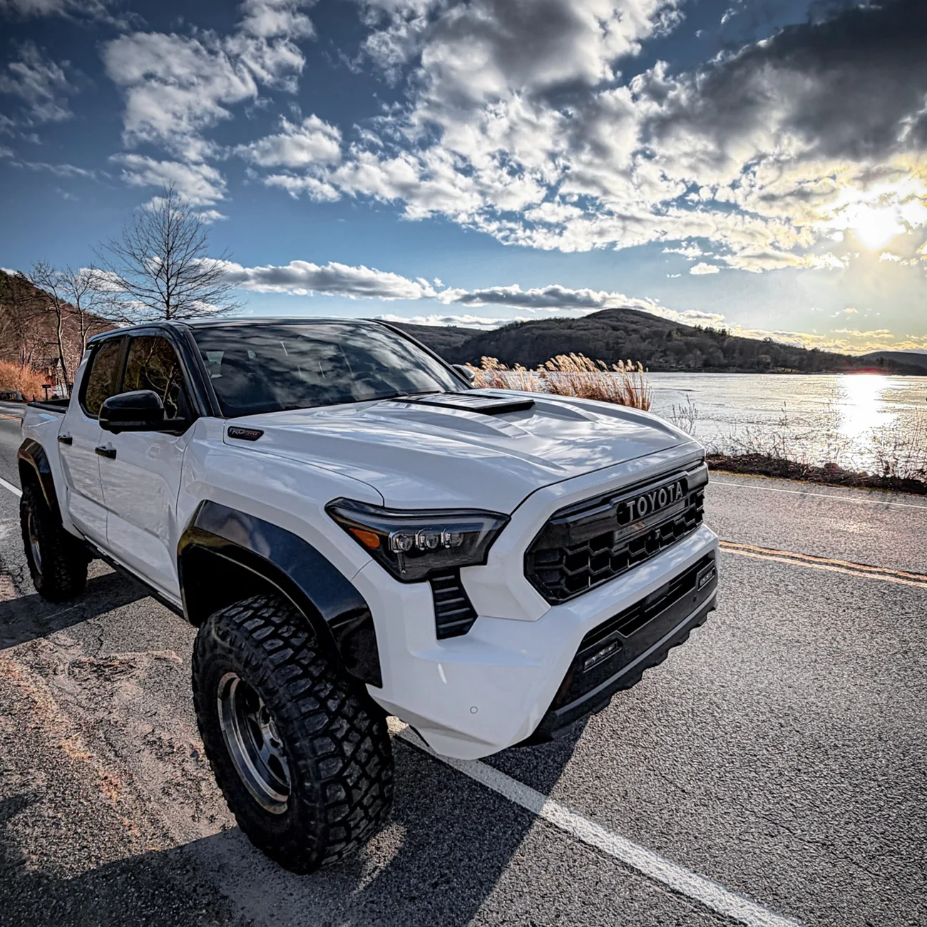

Love those Rays!! Ive had a couple sets in the past myself. How high are you lifted with that Wescott kit?

I'll say it again: SICK AF! haha such a cool setup.
I do wanna know about them MPGS, because 35's look so good

To be honest I didnt measure but the Wescott lift for the pro is an advertised +1.75 and it seems to be in that ballpark. Rides like stock

I will let you know when I get some more data, I drive this truck daily 70+ miles.
I will say I was debating 35’s for quite some time but after some research I found Toyo offered the RT Pro in a C-Load which was exactly what I wanted. I got the look of 35’s with the C Load ride and kept the weight low at 66lbs.

😍love your setup man. -10 offset & 35”. Any rubbing?

Removed my crash plates and did some basic plastic trimming but nothing major. Honestly I also think that was a product of these tires being the RT has very aggressive sidewalls and the Toyos seem to run true to 35” vs like a KO3 thats a 34”. I know there are a ton of people saying 35’s fit without any mods.

I believe 35’s will indeed fit without mods. The trick is getting the wheels with a much less aggressive offset as opposed to the -10. I have the same offset as you, with SCS wheels. I did KO3’s 285//75/17 and had to do the same as you.
