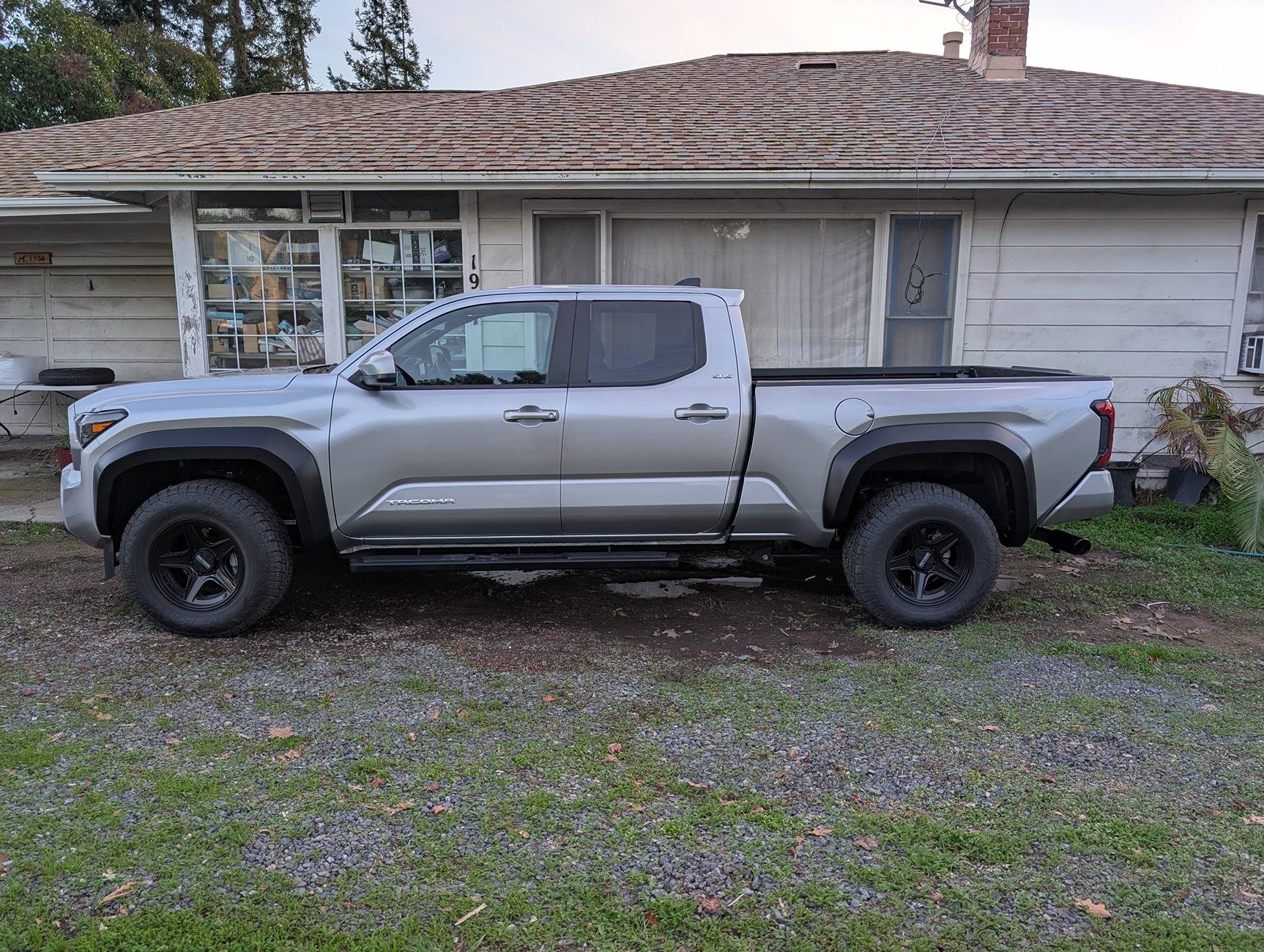

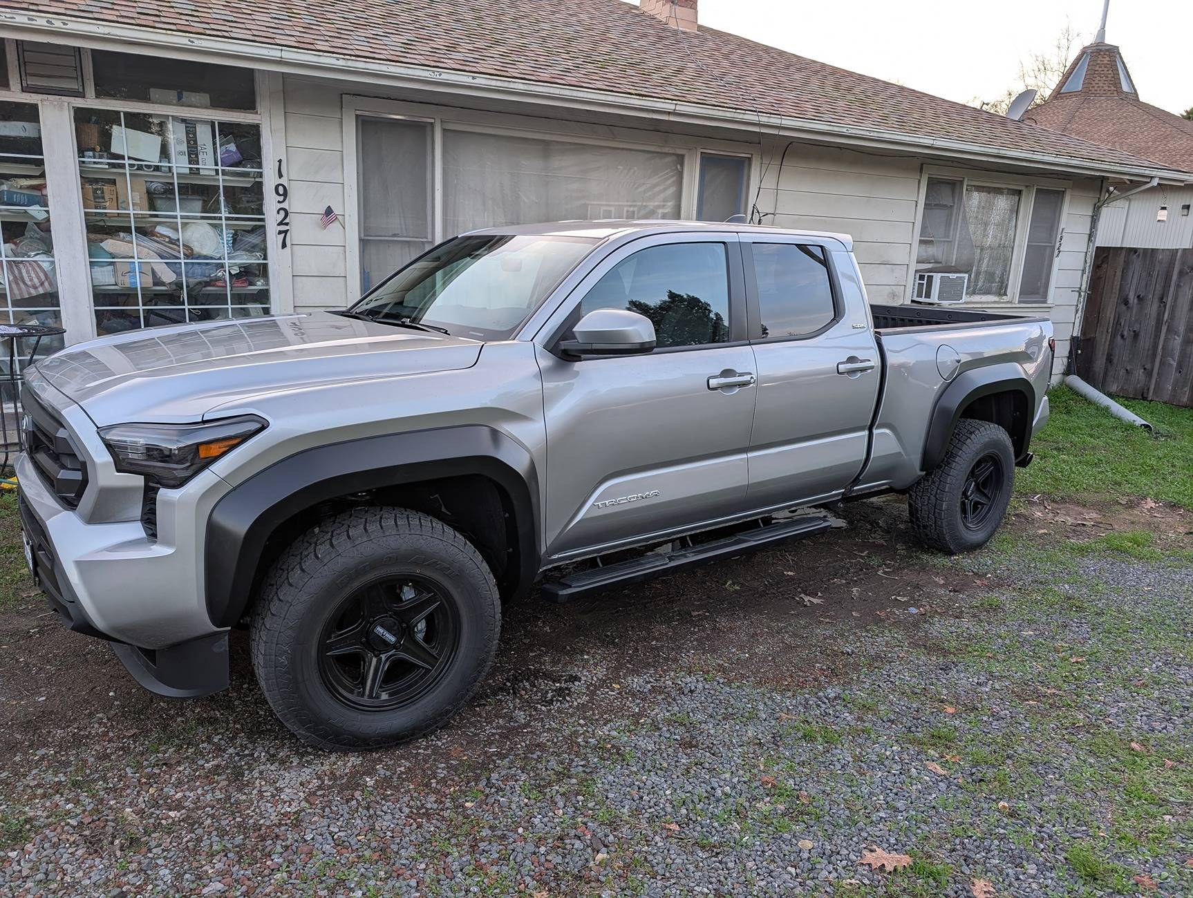

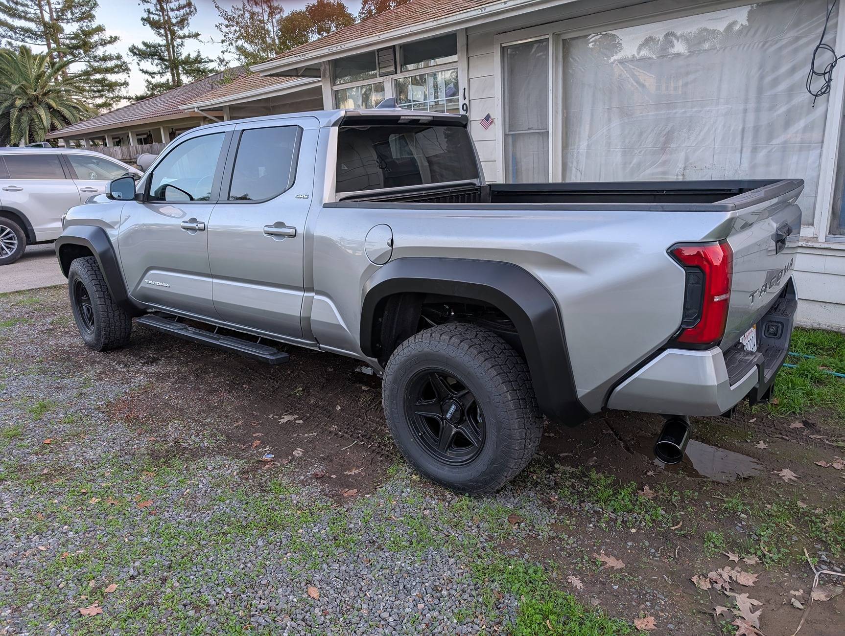

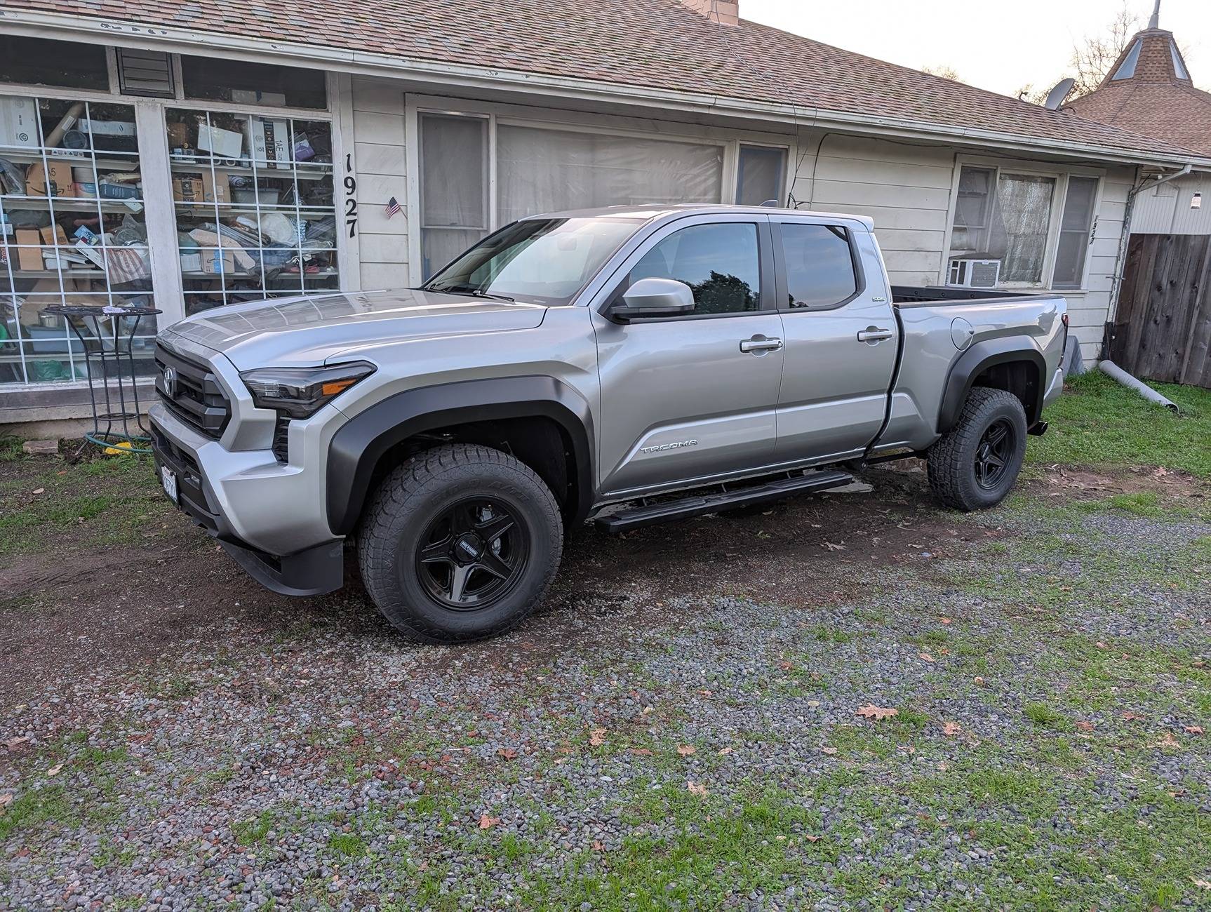

i run that size , with method 318's but those Method wheels added a slight poke , not the tires but the stock wheels on SR5 r tucked under the fenders more than normal as the 318's were 0 offset. & I got a 1 1/2" poke . I was going to add flairs anyway but had to with that much poke
Rough Country has a wide set of fender flairs that come painted or not , the fit great ,look fantastic, changed the whole look of the truck
I did not do a alinement

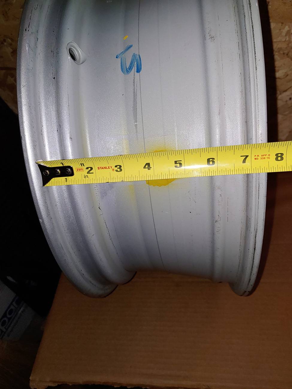

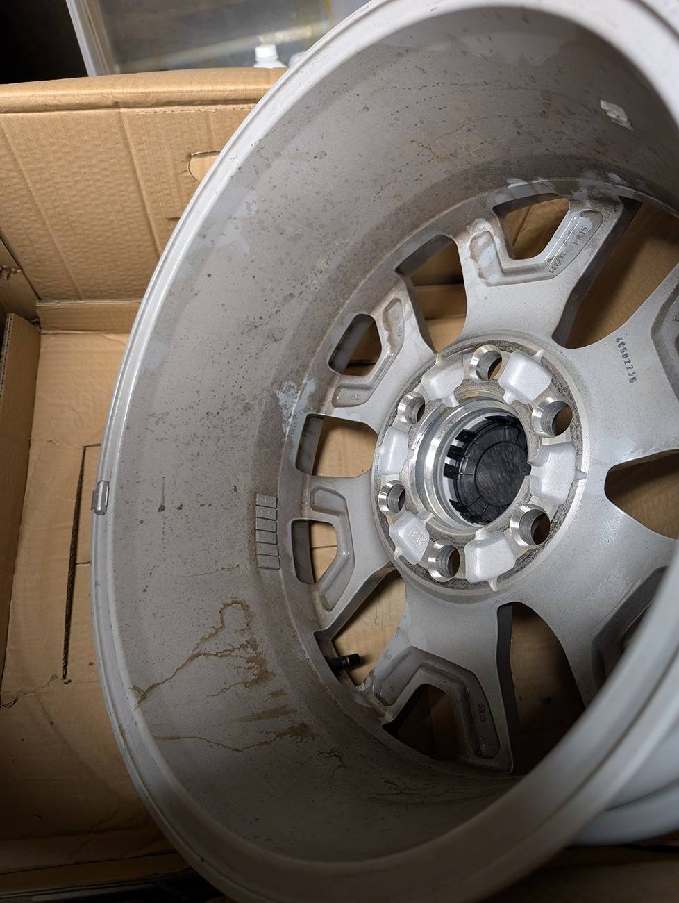

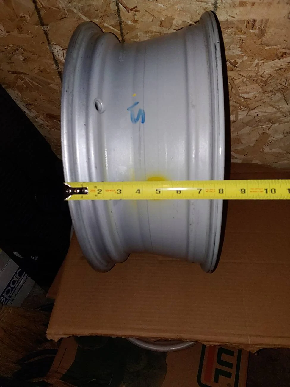

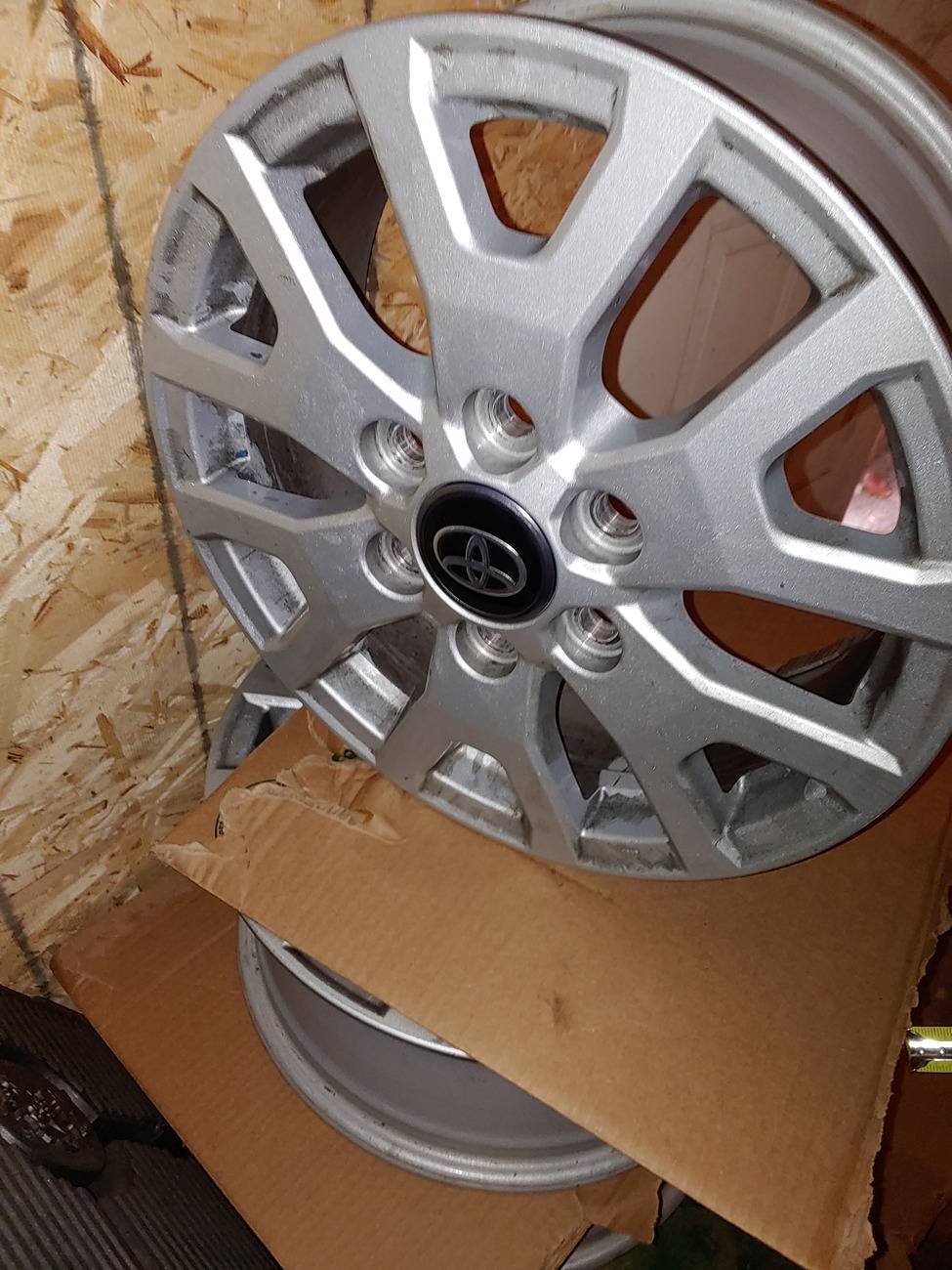

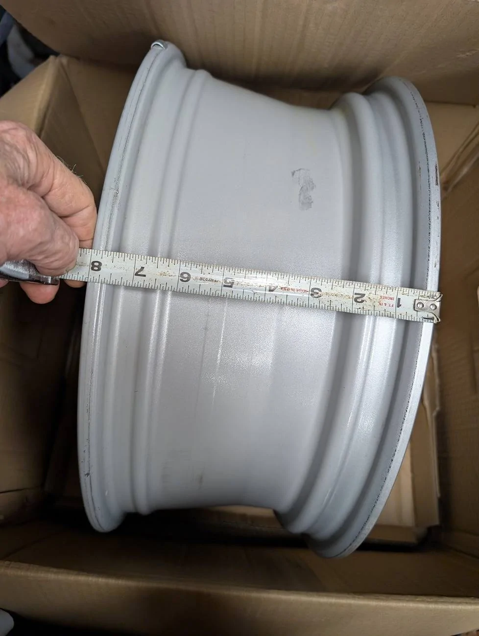

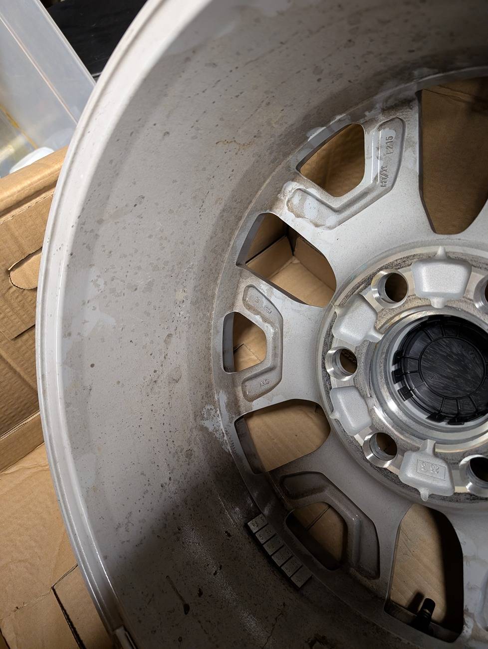

No 7" wheels on the RS5 Maybe the RS
not the wheels that came on my RS5 they are 8" wide & have a crazy long barrel with the spokes on the very outside edge of the wheel
ie the wheel hugs the axles & makes them tucked way under the bed
my truck handles soo much better with the wider stance of the new wheel/tire combo i got
265/70-17's Big O BigFoot AT 10ply

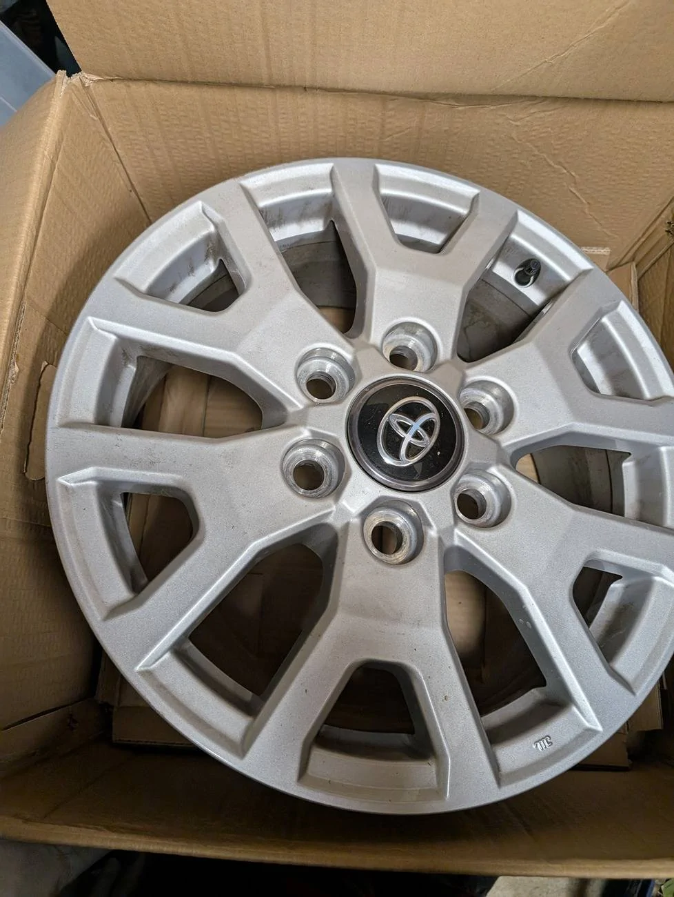

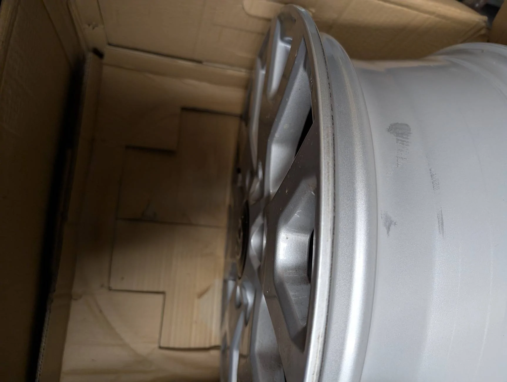

This is Toyota's 7 inch wheel, 17 by 7J. Measurement is from inside of rim inside to inside of rim outside, which is 7 inches. This is based on your tire patch to the road. The question is what are the 2024 OR wheels width, which have usually been 17 x 8, which by your measurement would be a 9" wide wheel.
