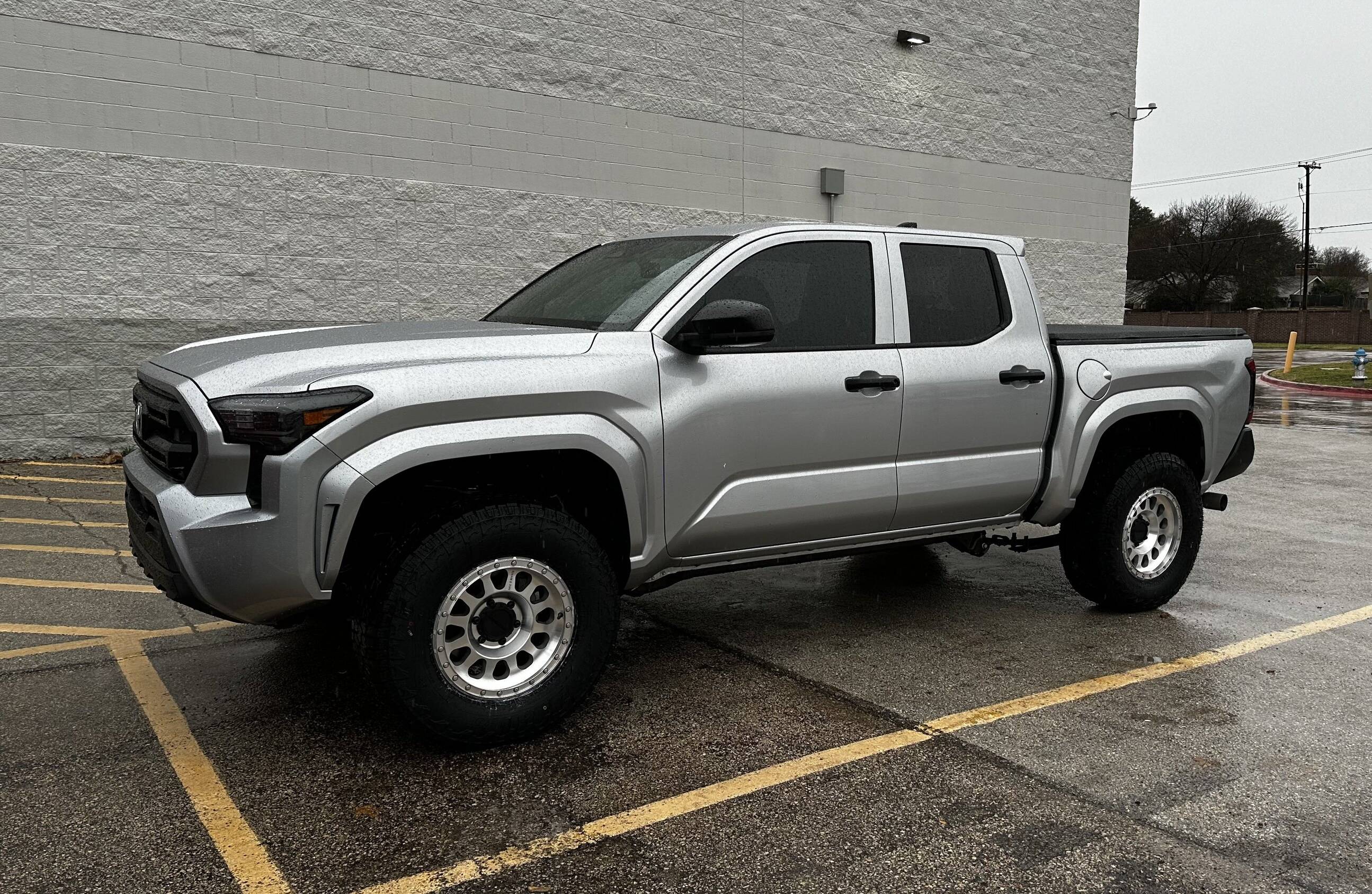

This is my 2024 Toyota Tacoma SR 4x4 with method 315 17x8.5 0 offset and falken wildpeak at4w in 285/70r17.
No lift, level or rubbing. I had to trim the front bumper, tuck the front liner back and also remove the brackets from the rear of the front fender liner to get rid of the rubbing.
The 0 offset is a much more aggressive stance than on the previous gen or 4Runners.
I am not the biggest fan of how much the wheels stick out. I think a +18 offset would be perfect. I just already had these wheels from my 4Runner.

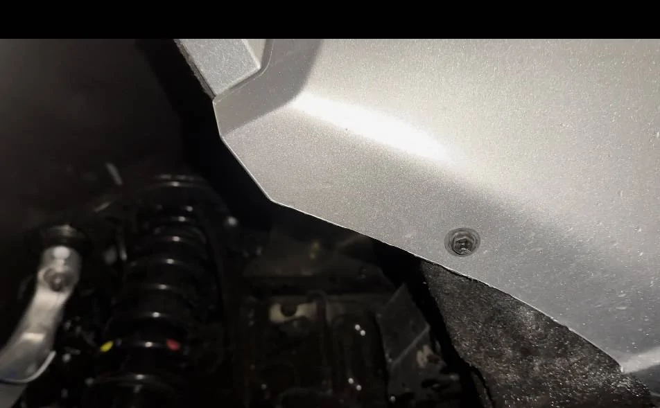

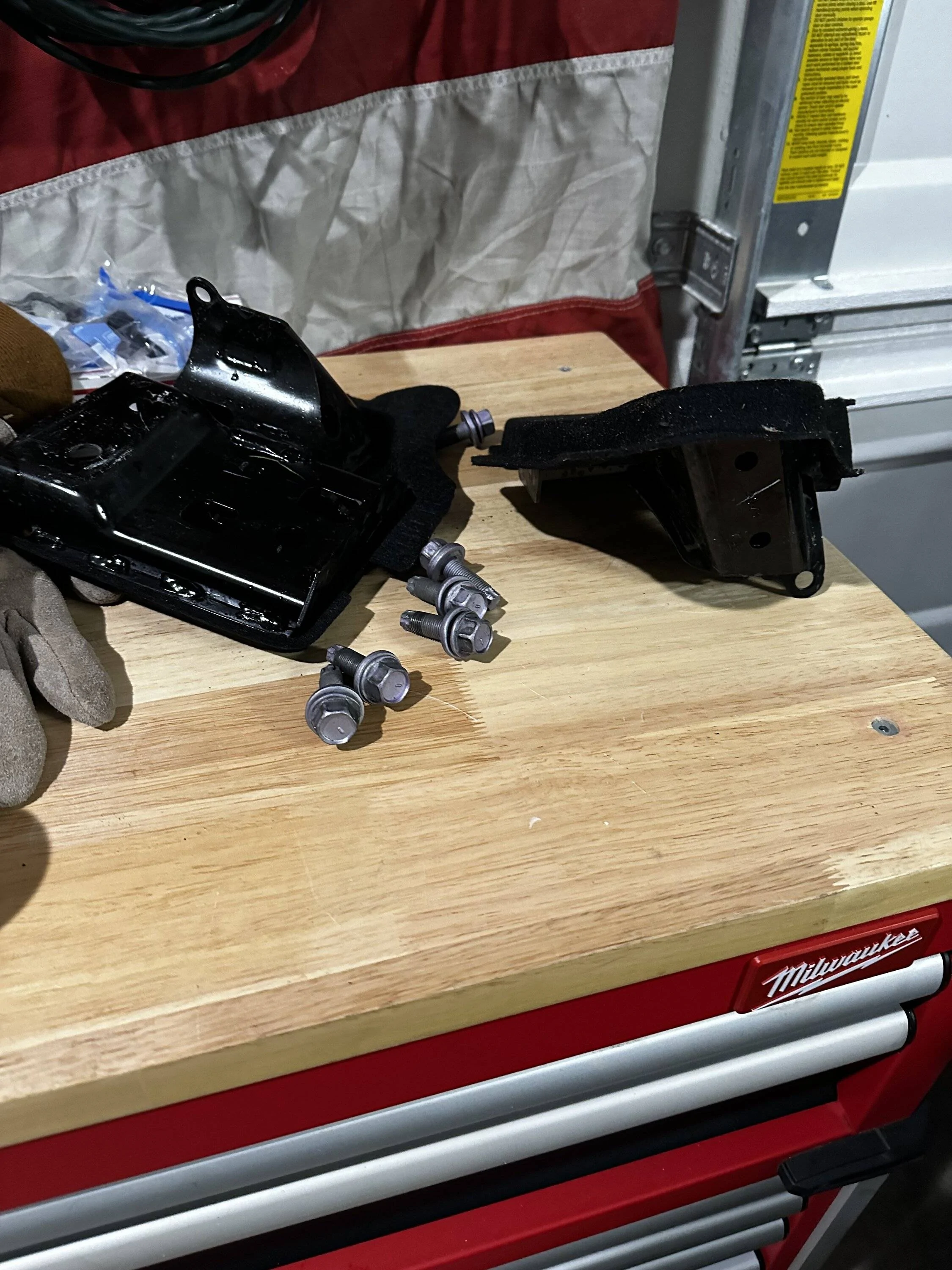

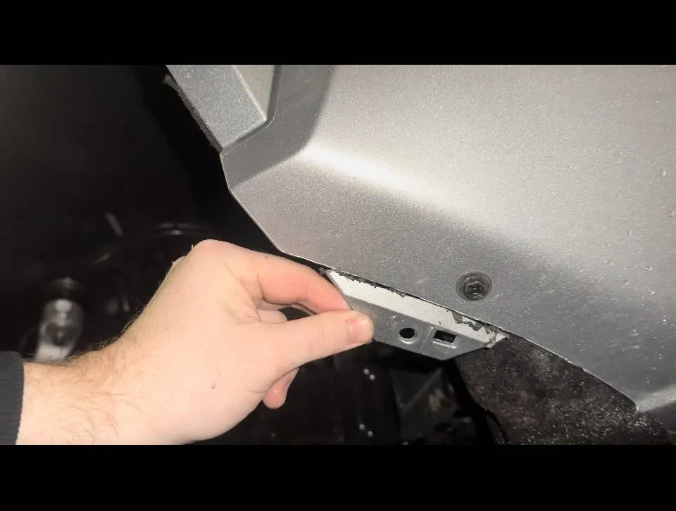

I may do the westcott level once it comes out. These struts are 4 bolt like the new tundras, not 3 bolt like the previous gen. I tried to line up a tundra top strut level but it doesn’t fit.
I attached a photo and video of the brackets that need to be removed (only 3 bolts, super easy) and the cut I made to the front bumper. Basically I just moved the mount for the liner further up to tuck it away. You can see the bolt in the video of where I secured the liner

Won’t let me upload video. I posted a YouTube short to my channel. Here’s a still shot from the video of where I cut with a dremel.
