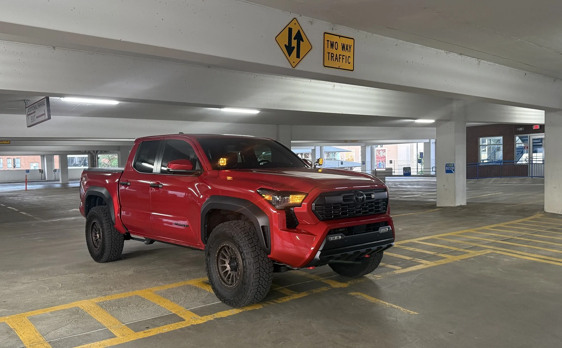

I love the stance on this truck, super tough looking.
I wonder what level of lift would have allowed those tires without trimming...
Thanks I appreciate it! I’m debating on getting just 10mm wheel spacers but money can be better spent elsewhere.
I think just a minimal level would be all I would need. It only rubbed on the driver side when turning in reverse. That’s on pavement but I have not tested it off road yet so we’ll see how it does!
I believe it may be related to offset. Others on this forum have apparently run 285 75 r17 on the stock TRD OR wheels (+55 offset) with no rubbing. A +25 offset is quite a big change and pushes the tire out, decreasing the clearance in the front and back when the tire turns . Perhaps a +35 offset or higher would prevent the need for trimming, but I am not certain.

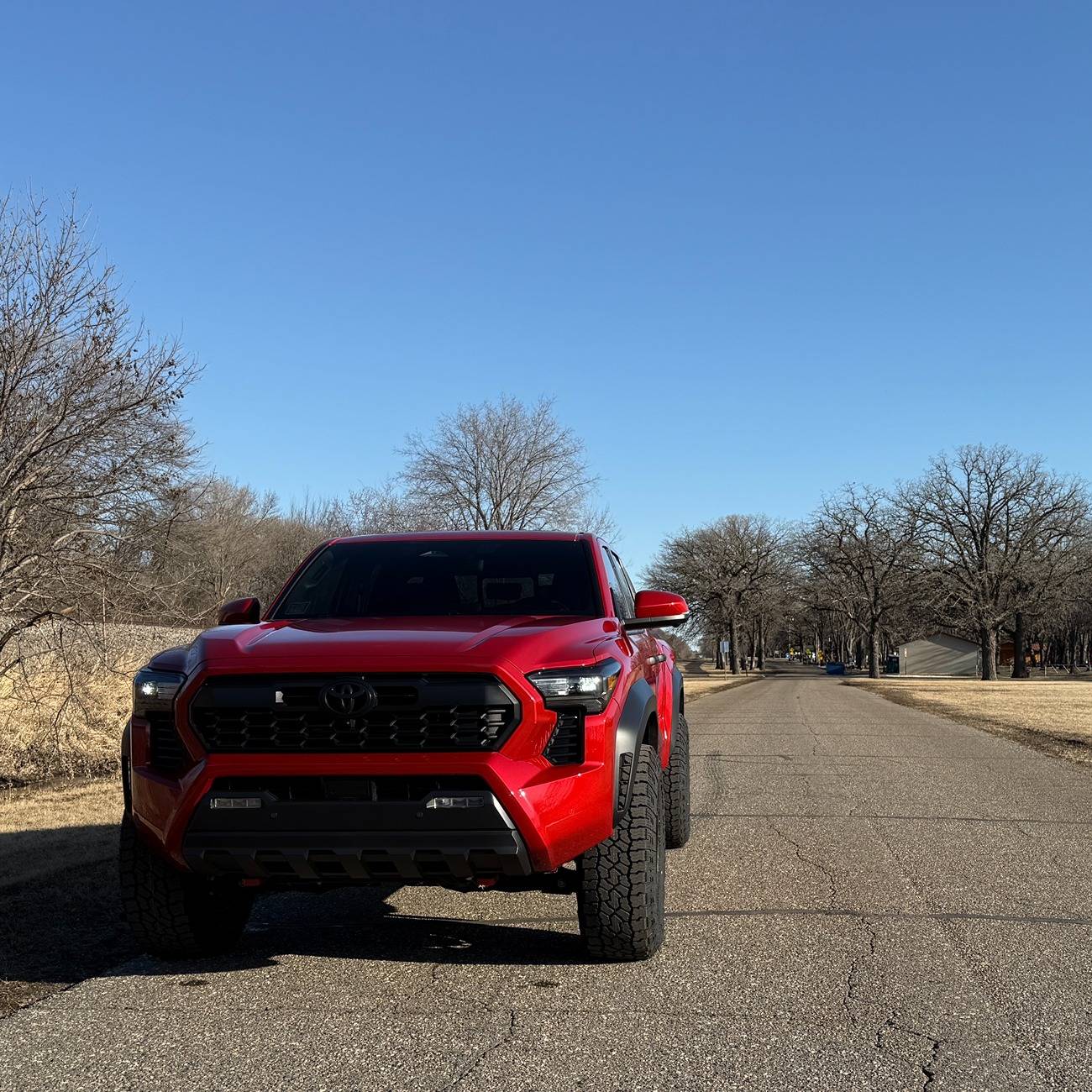

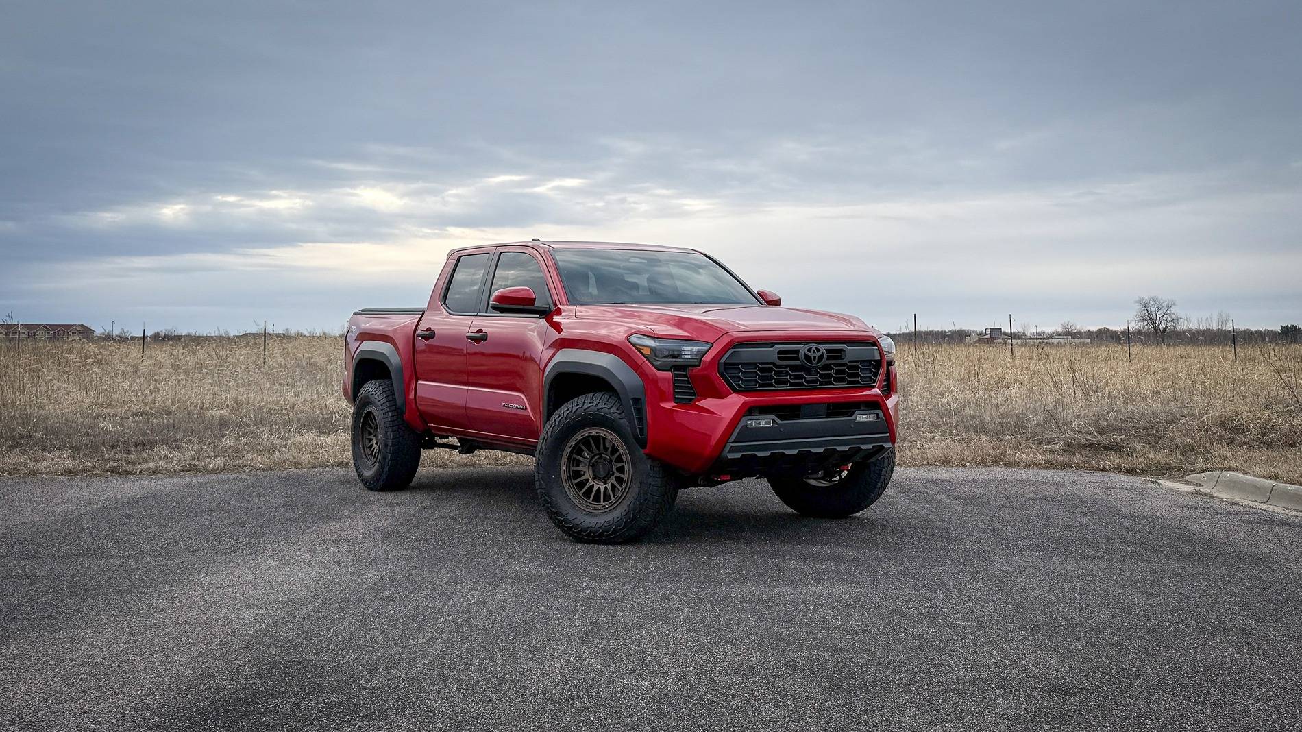

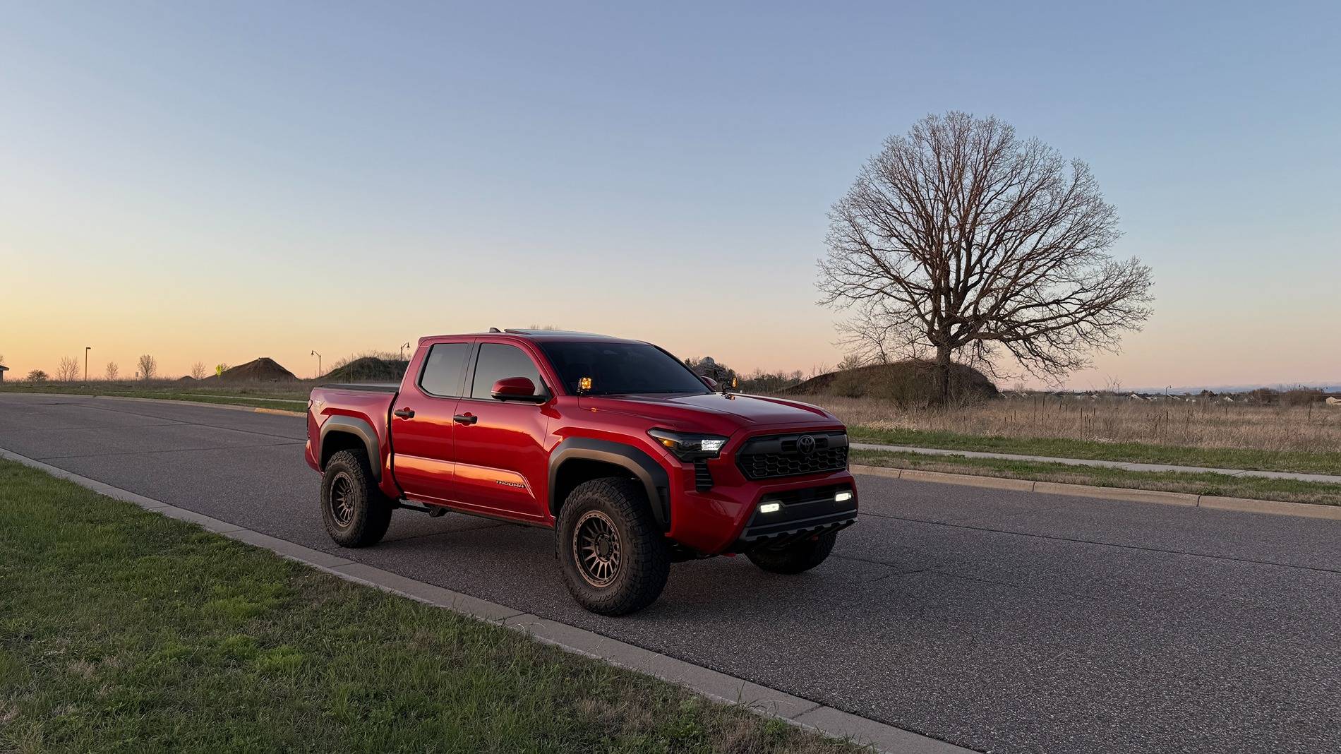

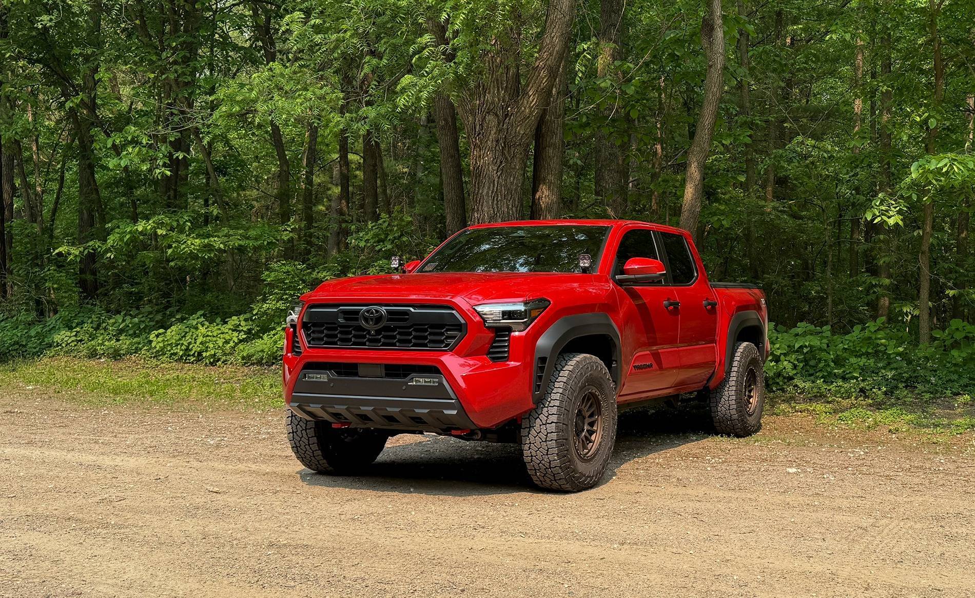

Hello everyone! I thought I'd finally add my 2024 TRD Off-Road premium to the build list here! Purchased the truck in June 2024 and have been chipping away at upgrades. The goal is to be able to camp and do some light off roading with it as well as my daily driver. The color and spec is exactly what I wanted and I'm very happy to have this as my first pickup(mostly Audis before this). I have more photos, videos and discount codes on my Instgram : @braaadyyota
Below are my current modifications.
Exterior
  • Relations Race wheels | RR7-H 17x8.5 +25
  • Falken Wildpeak AT4W 285/75/17
  • No lift/level - Very minor cutting to front bumper so far
  • Diode Dynamics SS3 Pro ditch lights
  • Lasfit DRL turn signal LEDs
  • Cornfed Suspension front and rear soft shackle recovery mounts
  • SXTH Element off road trail pipe
  • Perry Parts rear bump stops
  • TripleALiner & OEM bed mat
  • PPF on front clip, mirrors, A pillars, leading edge of roof and leading edge of bed sides
  • 50% windshield tint, 30% front window tint
Interior
  • TripleALiner and Lasfit floor mats
  • Muslogy center console organizer and lid storage
  • ScreenproTech screen protector kit
Future Plans
  • Just picked up an iKamper mini 2.0, planning on getting the Xtrusion Overland XBRS rack
  • Diode Dynamics SS6 fog lights
  • TRD Pro grille w/light bar w/out raptor lights
  • Eibach lift kit?
  • SXTH Element intake

That could be yeah. I think in my photo with the tree that’s later in the day I had it switched to parking mode. I park in the garage and it does the same thing but it doesn’t bother me at all.

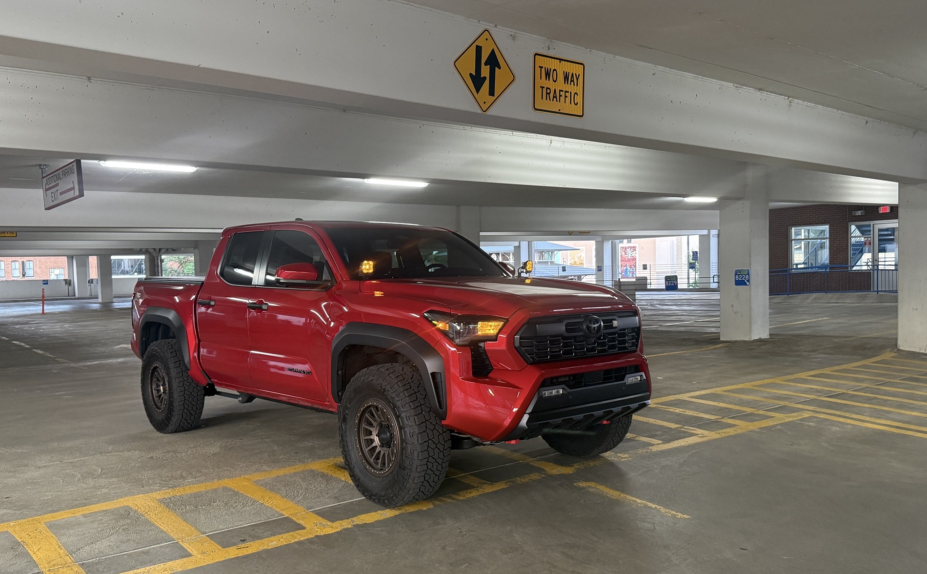

Touching back on this, I switched back to amber with the Lasfit DRLs. Messing with some settings trying to get some photos and found the combination.
In the pics in my post, I believe I have the headlights set to the setting above Auto(I believe this is the DRL mode), and have the fog lights on. In the pic below, I went into the infotainment and turned DRL to 'off' and also have the headlight switch set to DRL(I think) but with the fog lights off.

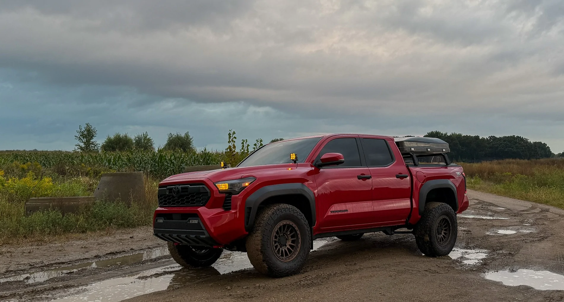

Updated with some new photos, got the bed rack and tent on!
